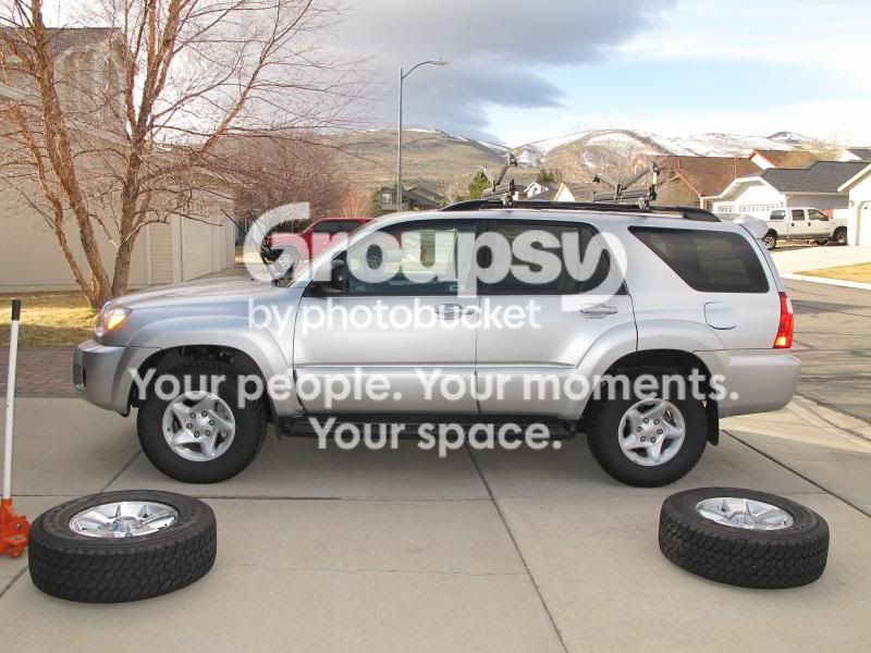

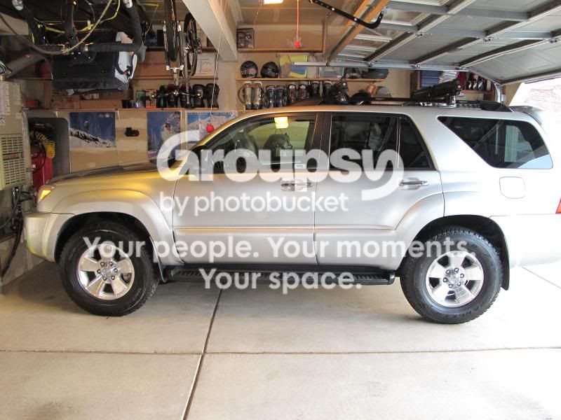

My 2008 SR5 4runner, with Bilstein 5100s -- front set at 0.85", rear is non-adjustable. Stock springs. No wheel spacers.
This pic shows 265/70/16 Goodyear Ultra Grip snow tires on old OEM wheels:
4runner001.jpg~original
This pic shows 255/75/17 Goodyear Wrangler Silent Armor tires on stock 17" wheels that came with my 4runner:
4runner002.jpg~original
The driveway is a little slanted to the right, so it's not the best depiction of the effect of the Bilsteins. The garage floor is pretty much level, so it's a better shot.
New shoes look great. Tell me, are you pleased with the bilsteins and stock shock?

olsen_karl, you have a great looking ride, as a matter of fact I used your pics as reference and linked it in my new member post.
Couple of questions, did you come out level? I ask because my '05 4x4 V6 came out 1" lower in front when measured from bottom of running boards with the same shock set, .085 lift and 100k mile original coils.

My 4R is still a bit nose-down (measured at the wheel well gap), but the front end of the running board is a tiny bit nose-up (vs. the rear end of the running board).
