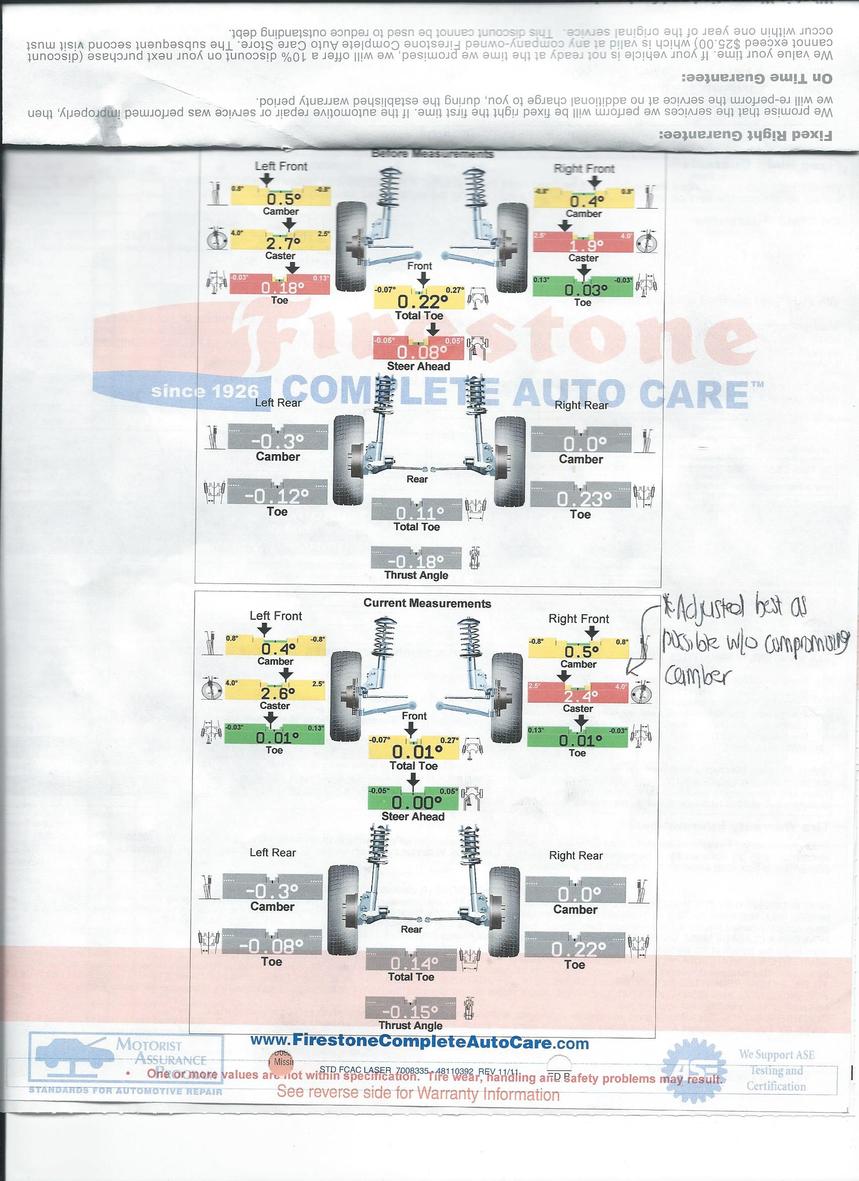

I had this like 2 years ago when I ran the 5100s at 2.5 with stock coils. Tracked straight, no uneven tire wear. It was perfect for on road and off road...until I upgraded to better coils.

Thank you for taking the time a posting!
So by your numbers? although it may drive and handle O.K. It does look like UCA are needed, to have the handling at it's optimum.
You'll want to get them at 2.5, I'm sure it varies truck to truck but I've found these IFS toyotas start to wander at speed without the UCAs.
It appears that the range for CASTER on our rigs is 2.5-4 degrees so the mid way point would be approximately 3.2 degrees.
That being said the ideal would be approximately 3.5 ish degrees. with 285's. The numbers tends to need to be higher the bigger the tires go.
So if you were to run 35" tires you'd probably want your CASTER about 3.8-4.0 degrees.
CAMBER is a good idea to have it a bit positive but close to zero. some shops like to bias it a bit depending on the area you drive, and if your roads have crown or not?
But that's a whole different topic!:cheers:

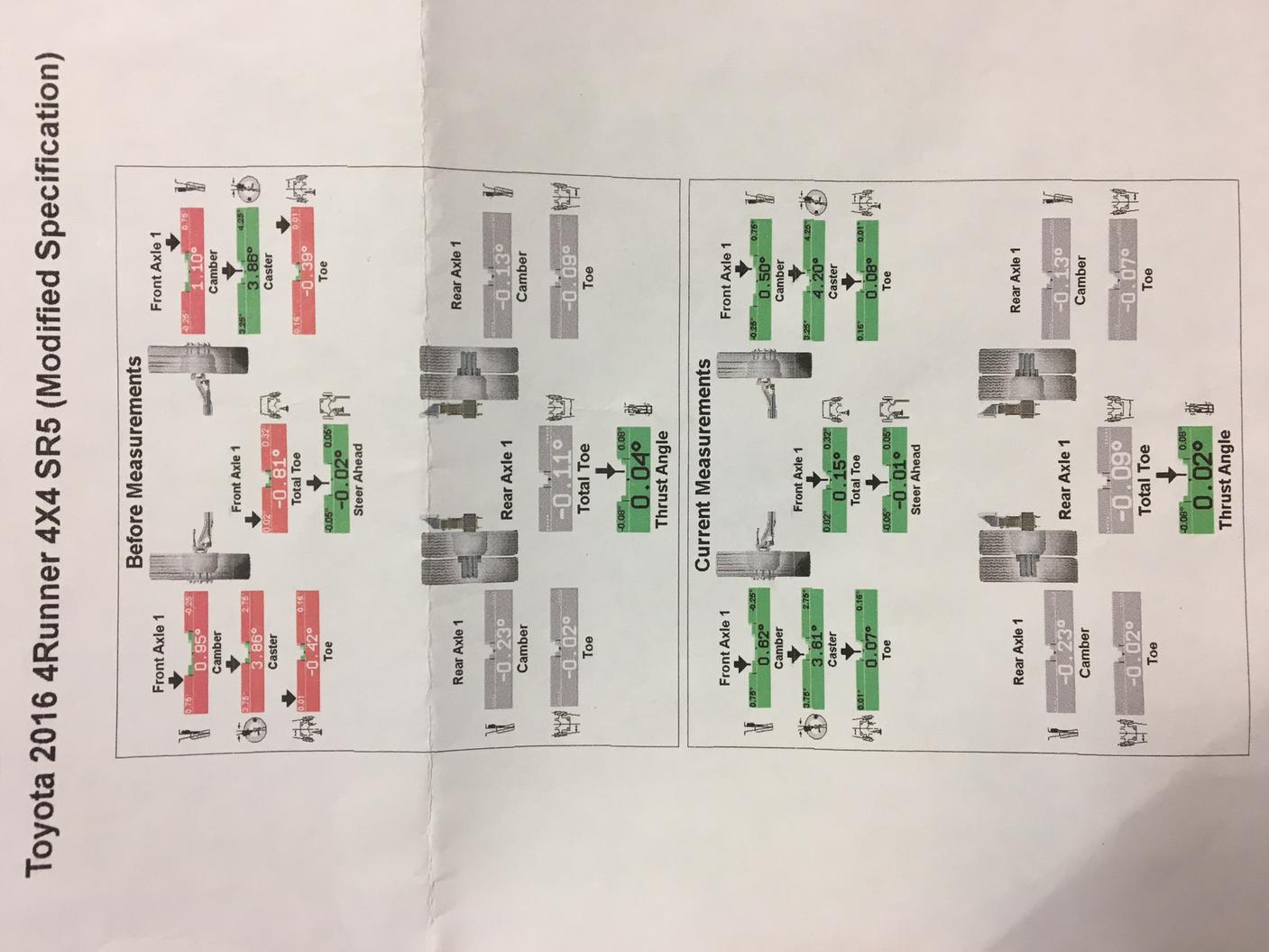

Figured I'd post this even though typed it out on other thread. Got cold feet and just went to 1.75" for now but plenty of room to go up with stock UCAs according to tech. I should've told him to pull camber closer to zero but this wont kill the tires for now.Alignment Sheet.jpg

Damn 3.8 and 4.2 on stock UCA's! Thats a good alignment tech! I have my shocks and springs burning a hole in my garage floor right now. Waiting for a nice weekend coming up to throw it all on.
A good friend of mine has a shop and hopefully he'll be able to get me close to 3 degrees going up 2.5".
