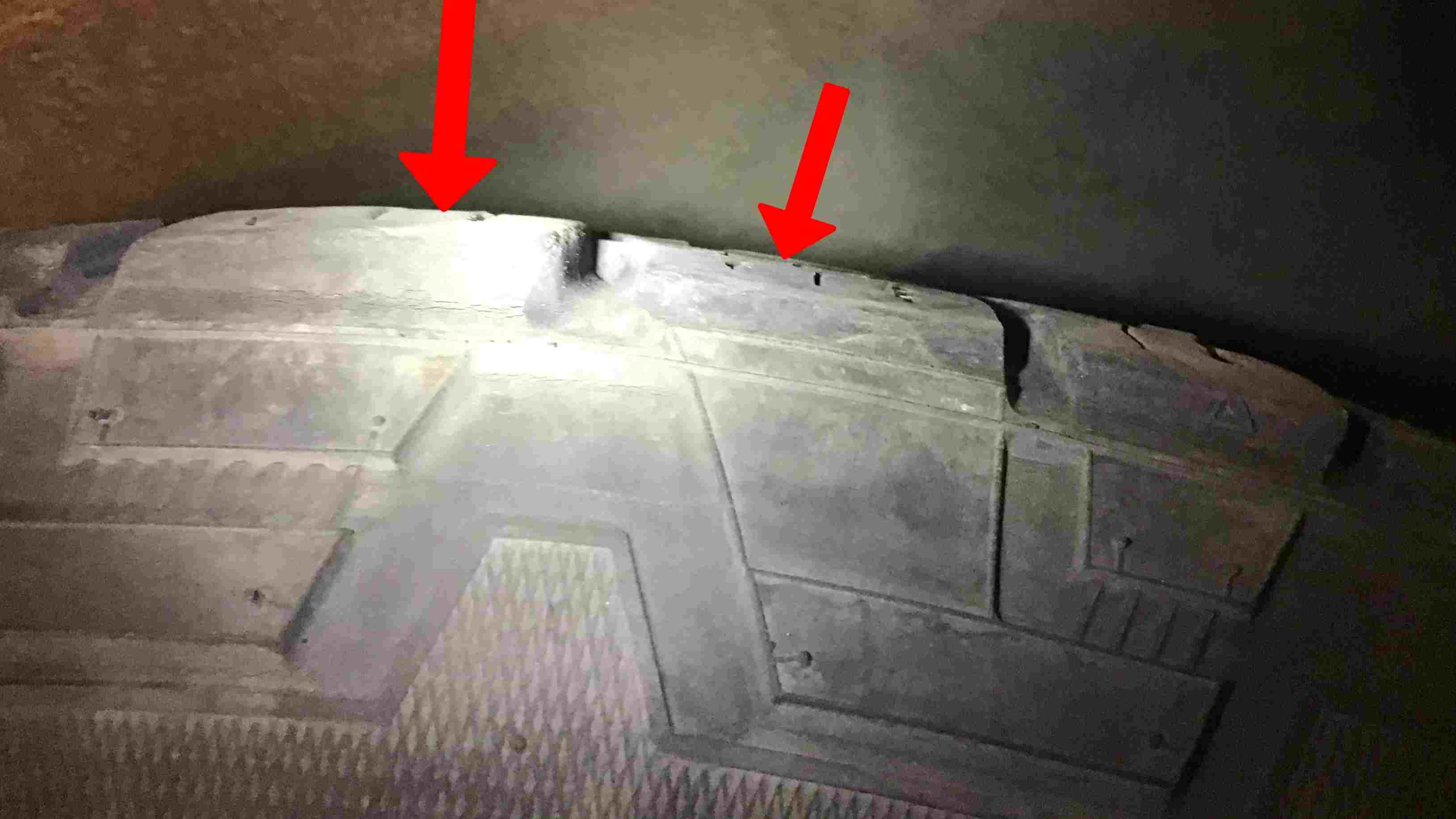

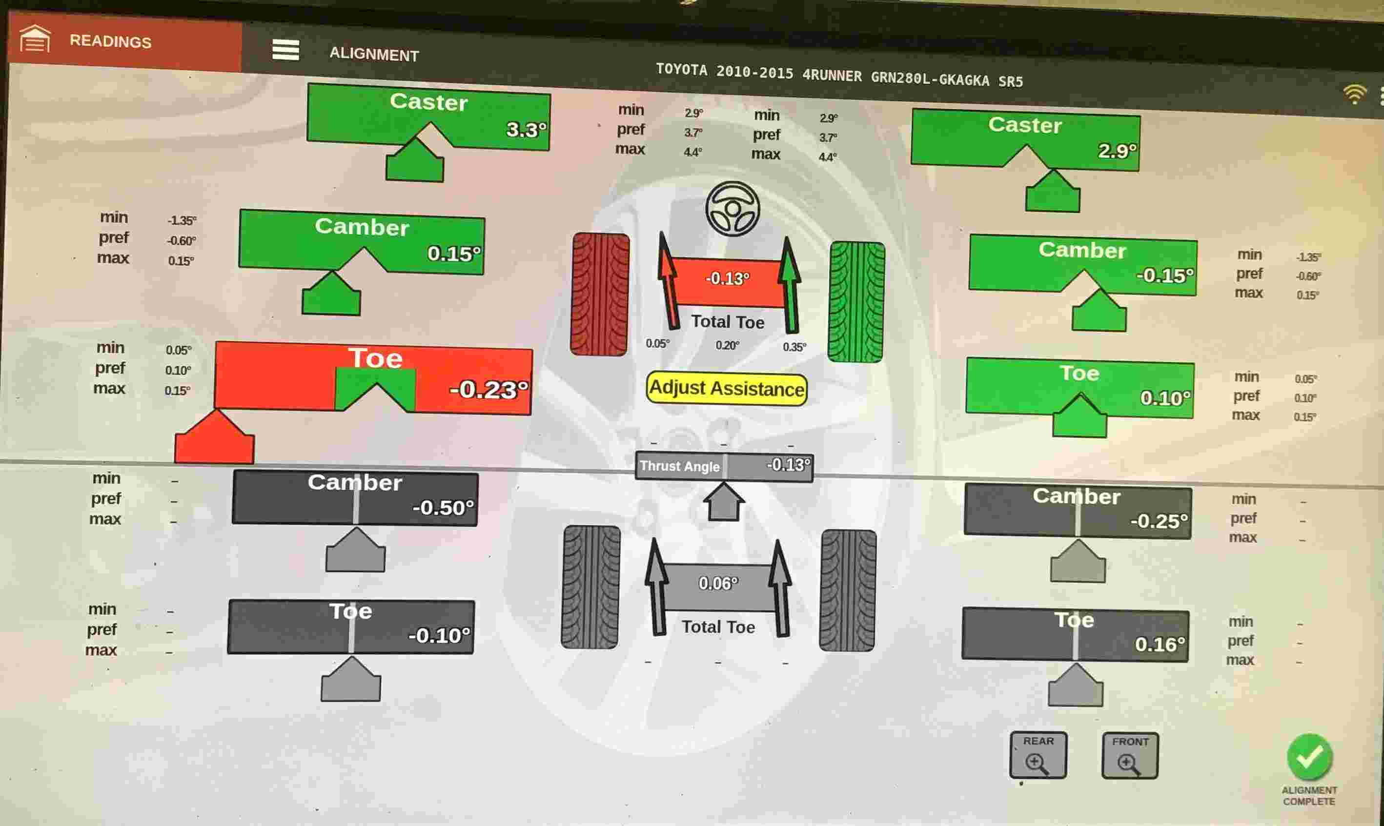

I would get a reputable shop to check tires, balance of all 4 tires, Align according to Toyota specs.
If you let your tires go too long without balancing, the wear may be too great to bring them back without alot of weight.
My rule of thumb, and it's worked for years, on my T4r's, is to balance and rotate every 5K.
My BFG AT KO2's have 55K on them and still have 6/32" of tread without cupping or any abnormal wear pattern.
Hope it works out and hope this helps.
my cooper at3 xlt's started to cup as well. i rotated them every 5k, but they still did it. i ended up selling them for some toyos. It was a shame cause they were fantastic tires. I will try them again now that i've had my Kings rebuilt, and new ball joints installed in my upper control arms.
Discount tire did mention to me that a blown shock can cause cupping but idk.

Question. You didn’t mention balancing, did you balance and rotate?
Did you balance every 5-10K miles?

Understood.
Years ago I learned the hard way. Never felt any unbalance on my Tacoma until the tires were too far out. Cupped and actually started to go out of round.

Is that alignment chart yours? When was that done -- long ago or recently?
Note that the toe is way out -- far into the red. That is what is causing the edges of the tires to wear. Toe bad will always do that.
Why didn't your mechanics flag that bad toe alignment?
Why didn't other responders to this post flag that?

I thought that was initial.

Yes that is my alignment chart prior to the second alignment after I got back from the road trip. They aligned and balanced the tires during this visit.
The mechanic said that only 1 side had bad toe alignment - why would both front tires be wearing the same on the inside edge?
It just seems strange that the tires didn't seem to have abnormal wear/cupping until after the lift/alignment/road trip.
Toe is the angle difference between the right and left side. Zero toe indicates both tires are pointed straight ahead.
Even with only one tire with the toe out, it will try to steer the car in that direction; thus the one without a toe problem has to fight to bring the car back straight.That is why both tires wear, even though only one has a toe problem.
We have the same issue with Cooper AT3s on our 2014. Road force balance the tires. Consider balance beads in the tires. Rotate tires every 5K miles as the feathering will scrub off in the rear position. Check suspension for worn ball joints. Check shocks for wear.

I don't know what the alignment spec was after the lift but before the first alignment. All I was told was "it was pretty close to OK". After that first alignment it was within spec.
Thanks for the reply - this makes more sense.
