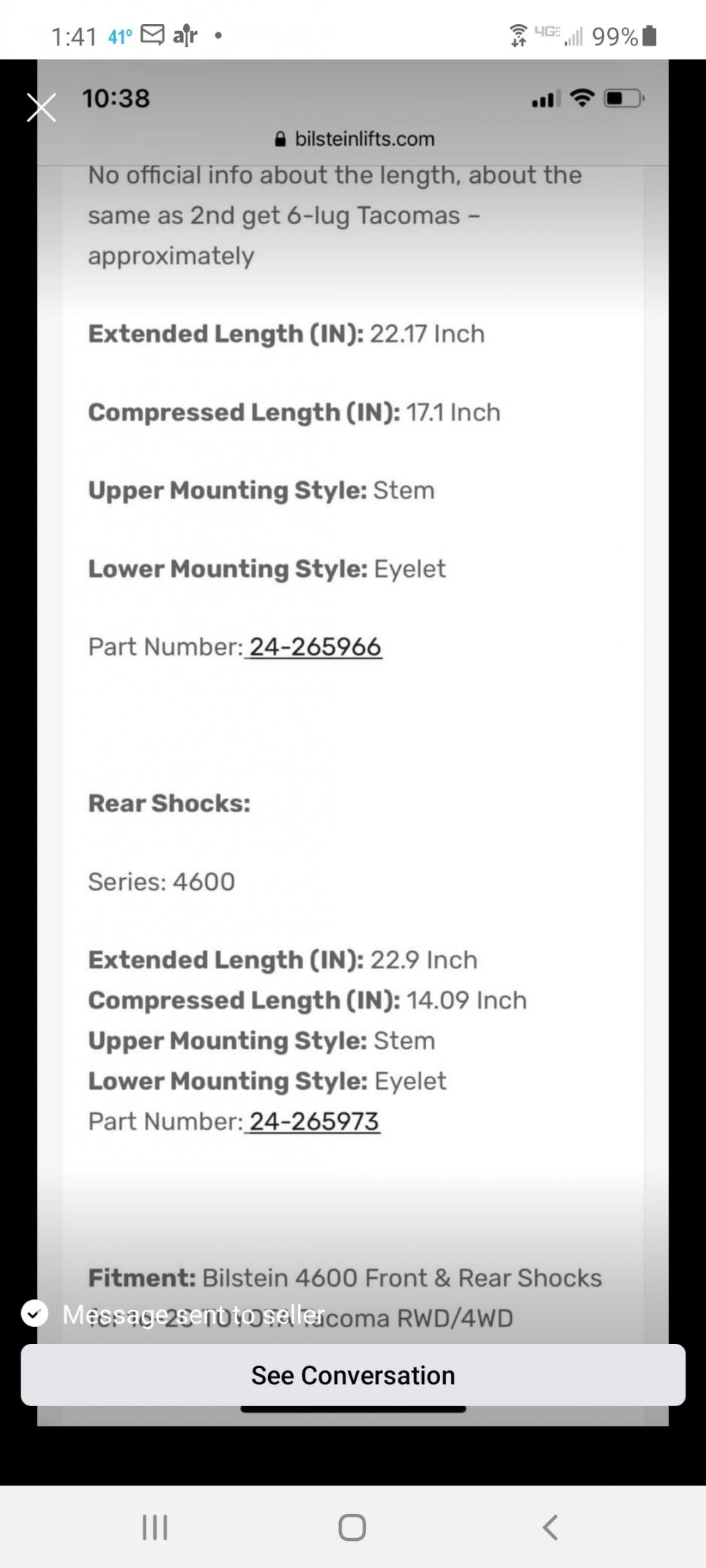

Will Bilsteins off an 18 Tacoma fit my 05 4runner with no mods? I would search but on my way to work. Here are the specs.

I know they'll fit an '06-'09 so presumably they'll fit an '05 too (anyone who knows differently, please chime in). You will need to remove the rear shock lower mount bushings that fit a Tacoma and install bushings that fit a 4th gen. There's a thread about that here and my post on doing the swap from a '15 Tacoma TRD Offroad to my '07 may be helpful too.

If they’ll fit 06-09, then they’ll also fit 03-05.
