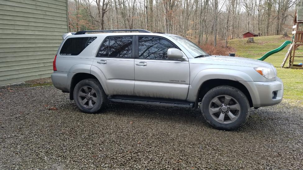

not sure if this will help but i used the moog fj front springs and the moog 4runner rear springs (81045) with the bilstein 5100s. the bilsteins are set on the lowest level and my truck is pretty level
Thanks! What was the MOOG# for your front springs? Our trucks our similar and I like the look of yours. Do you like the ride with this set up? Thx
they are the 81108. it greatly improved the ride. i put the bilsteins on first with my 200k mile factory springs and didnt care for the ride much. after i put these springs on, its like a new truck. definitely more firm but no where near harsh to me.
i did have to cut about an inch of the pig tail off on the bottom of the 81045s to get them to seat all the way on the rear spring perch.
