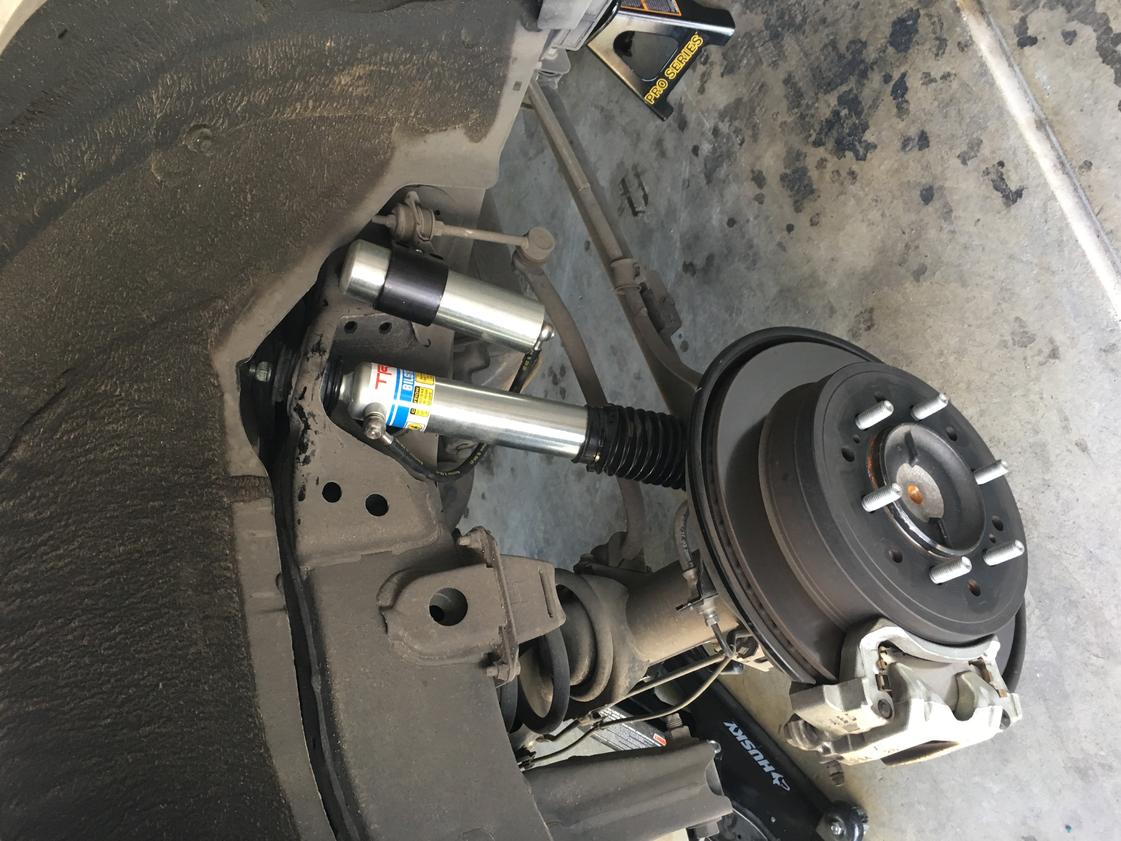

I got the rears in today...very straight forward with the PDF file that was posted earlier in the thread, perfect reference! I have TRD OR without KDSS...booted right up perfectly. I started tackling the front but couldn’t loosen the LCA enough for the no spring compressor method so gave up, I’ll give it another shot maybe tomorrow.

Might want to push that resi as far up as possible to prevent the link from hitting it when the rear wheels get tucked into the wheel well....

Good observation! Just checked, looks like I can push it up about .25”-.5” without having to cut the fender well
