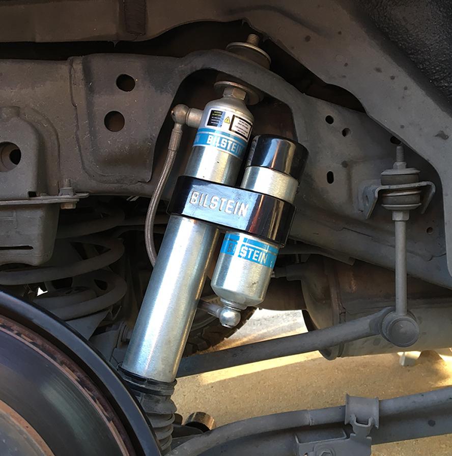

This is a follow-up after I got a PM from [MENTION=112764]headpaneer[/MENTION].
The difference from what is my build photos to the actual location of the reservoir is a 1.5" difference.
Here is a photo and the link to the thread where it is posted, there is a lot of info in that thread that may be helpful.
http://www.toyota-4runner.org/2282019-post514.html
The location of the reservoir will obviously be different depending on mounting applications and clearances.
