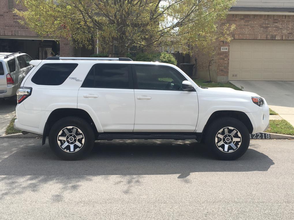

Just installed the front (did rear last weekend). Went very smooth with the no spring compressor method. Definitely reduced nose dive, feels more tight and controlled. Only driven it about 10 miles so far though. Front end measurements are as follows: Before: FR- 34 13/16”; FL 34 9/16”; After: FR- 35 7/8”; FL- 35 11/16”. Bottom line- right around 1”. Looks level. Here’s a pic, everything else is stock: 17 TRDOR 4x4
