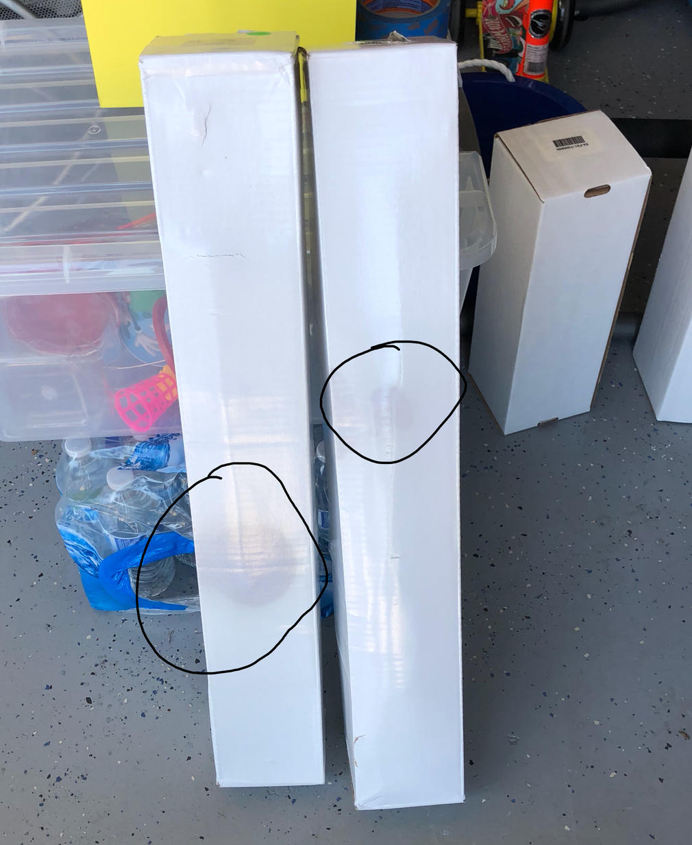

I received my kit and noticed that a couple of the boxes have what appears to be oil marks on them. Is this normal or something I should be concerned about?
