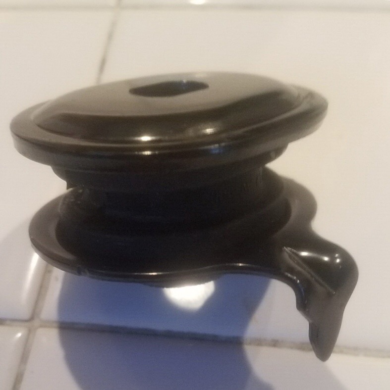

Does anybody know what this is? It came with the kit.

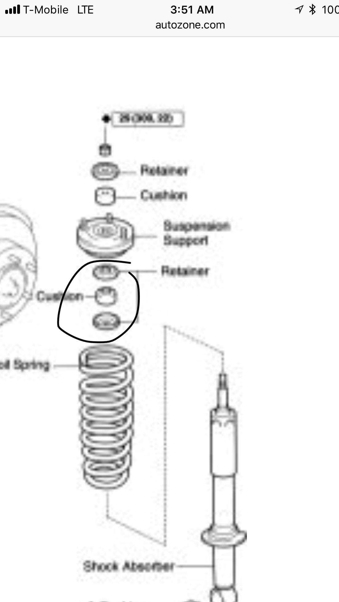

Did you install the bottom retainer washers and cushions on the shock piston? ( circled in diagram) They keep the piston from pushing too far into the top hat.
I will double check this morning. Those parts come off the stock assemble of new ones came with the new shocks?
So that explains my issue on the driver side. The passenger side this I still have a ton of space from the top hat to the nut. Has anyone else experienced this?
