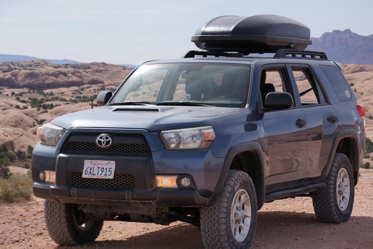

Truth. Case in point:
2013 Trail with the trd pro bilstein upgrade. I have a trd pro and IMO this did a little better than mine because of the KDSS.
