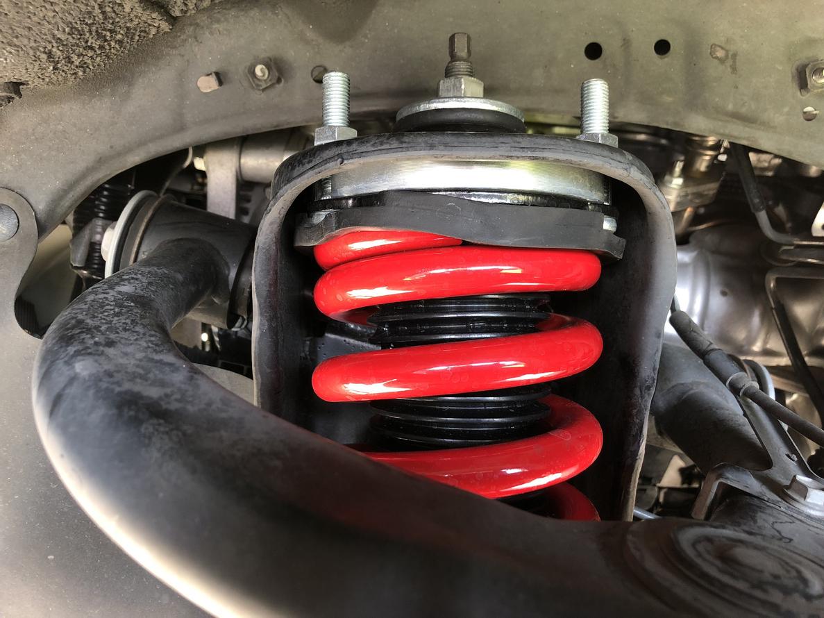

I finally installed the suspension on my 2015 4runner SR5. The lift feels much better than stock, almost makes me wonder why Toyota didn't just make it this way from factory.
I must admit I am very happy with the purchase/upgrade. up front I added toytec 1/2" top plate spacers and in the rear I did T13 rear coils with a 10mm OME spacer. (spacer in left side/rear only)

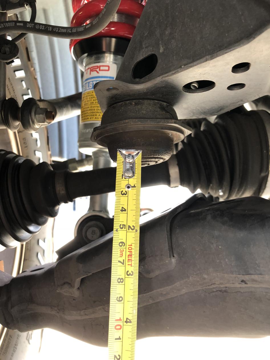

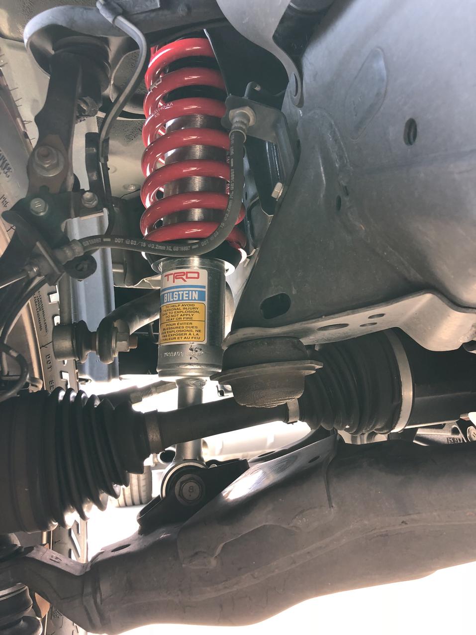

With the 1/2" top spacers, did you cycle the suspension to see if the bumpstops worked correctly? (i.e., the bumpstops hit before the shock bottomed out?)

No I didn't cycle the suspension, but I am willing to bet those little spacers are not going to raise or keep the bumpstops from hitting before the shock bottoms out.
I did take a measurement and it seems now I have 1 3/4" from center of bump stop to control arm.
