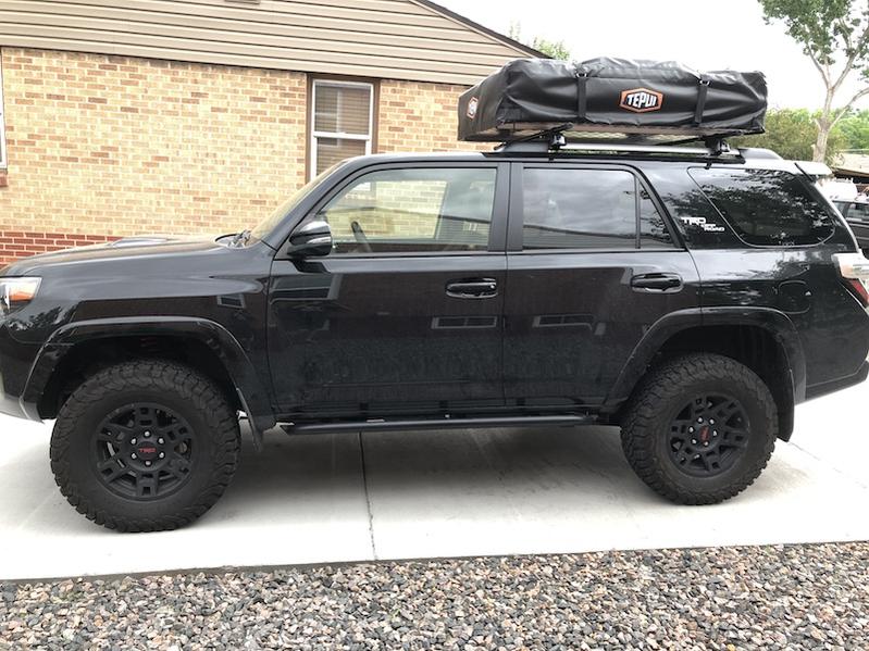

Finished up the rear today so here's a pic of how it currently sits. Are you planning on adding new springs in the back? If not you might end up with a slight negative rake with the Toytec 1" spring perch spacer.
Before I bought the spacer, I had a convo with a rep at Toytec and he talked me into the lower spring perch instead of the top plate. He said that the spring perch spacer was basically the same as adjusting the hight of a normal 6112.
I drove around the block with my fiancé in the car and tried to hit every speed bump and rut I could find and we didn't notice the ride being any more harsh than before the install.
Looks great. Can you take measurements from centerline of hub to fender? Also, remind me of your final setup, please.
Your truck looks tight, that is the exact lift amount I am looking for.
