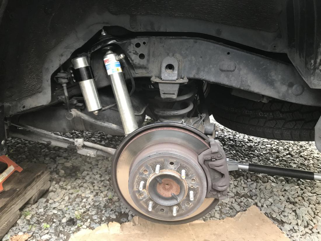

Finished mine up yesterday also. Had the advantage of having a beater car so I took my time but could have easily knocked it out in a day instead of the week I took. One mistake i made was letting a weld tab for the rears fall back into the frame so I had to get another. My numbers and ride match everything I've seen posted up here. The only thing left is to get the alignment done and enjoy it. If you area novice I wouldn't think twice about tackling this install. Just have the right tools and it's very straight forward.

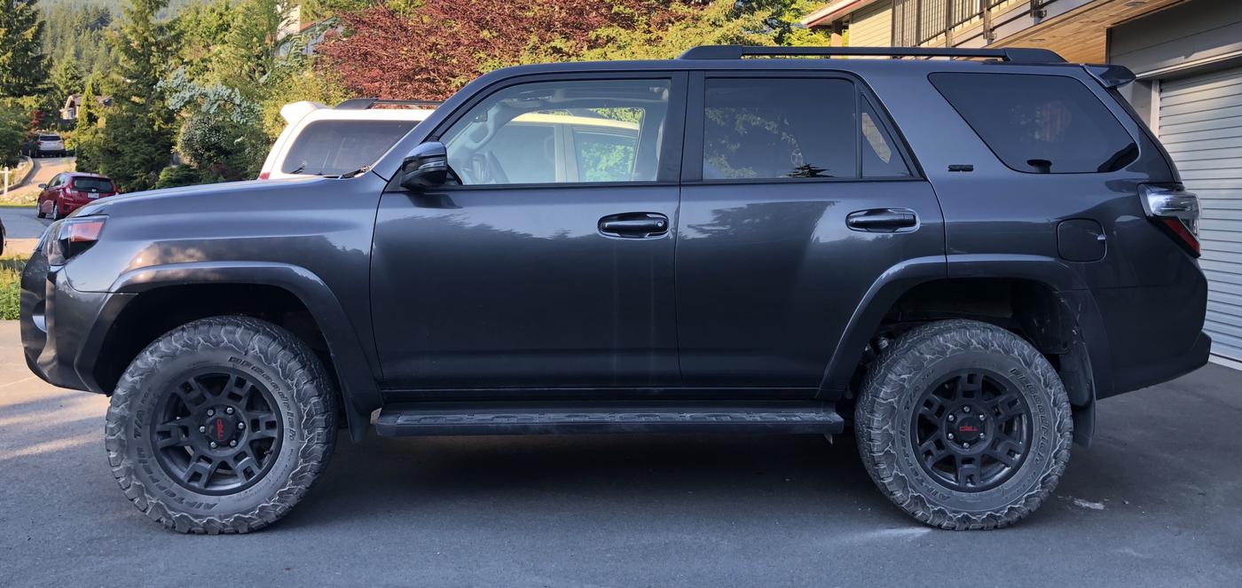

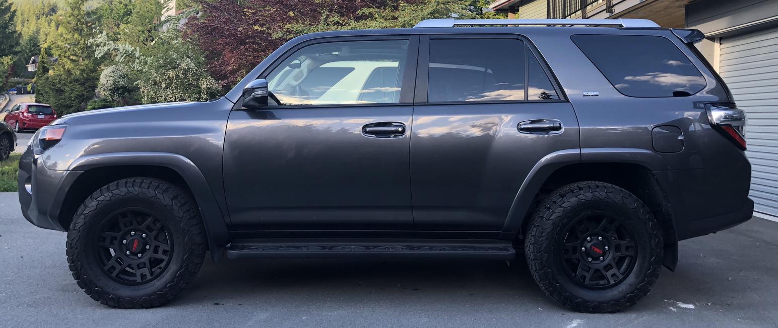

Lift in - Sorry for the dirty after photos... just got back from trying it out.
Toytec 1" TRD lower perch (plus TRD 1" increase)
Toytec 1.5" rear spacer
FR - 34 3/8" to 36 1/2" = +2 1/8"
FL - 34 1/4" to 36 1/4" = +2"
RR - 36" to 37 1/2" = +1 1/2"
RL - 36" to 37 3/8" = +1 3/8"
Also blacked out the rack.
Only issue is that the caster alignment is 1.7 deg when the range is 2.5-4.0 deg. Shop says it can't be improved - Should I be worried?
