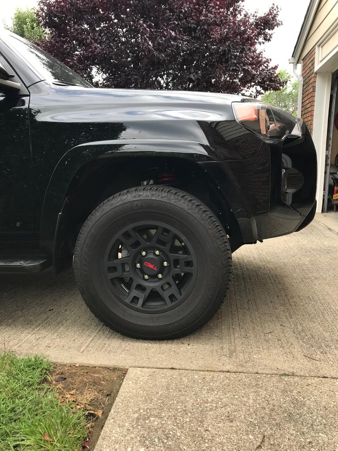

Realizing I never posted pictures but I’m super happy with this kit as I’ve mentioned before.

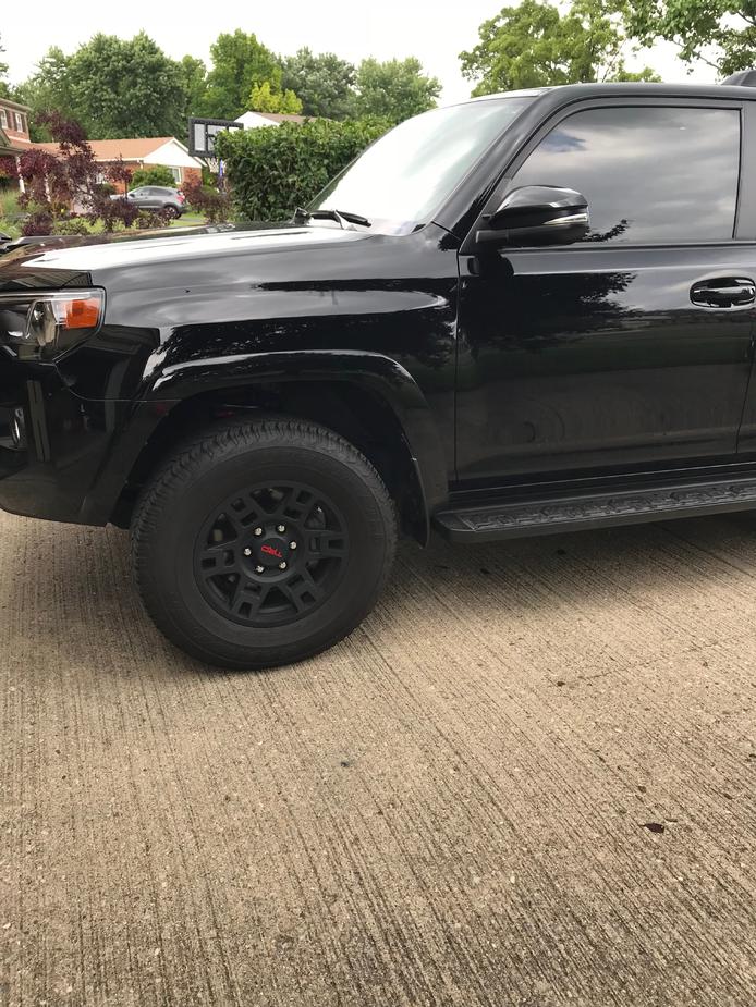

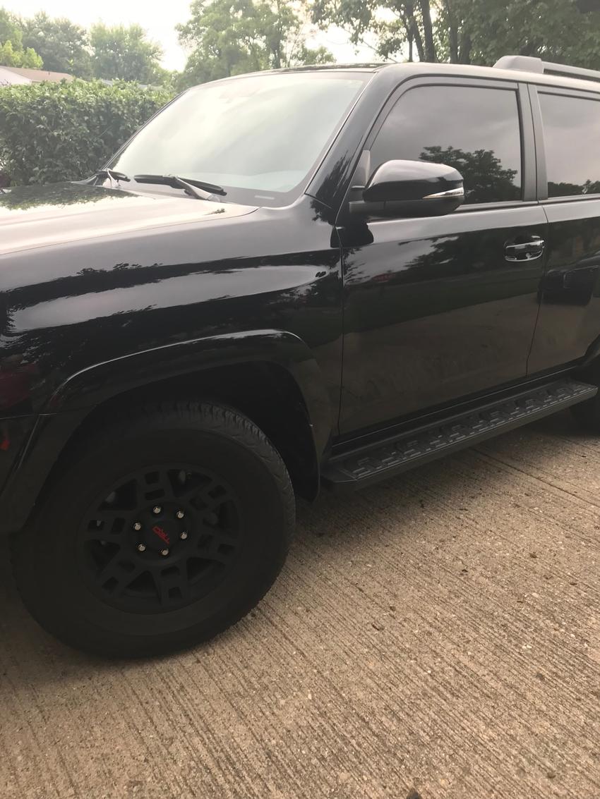

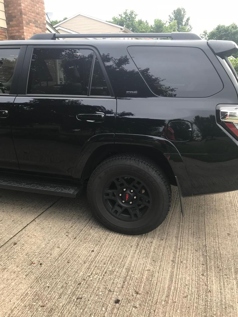

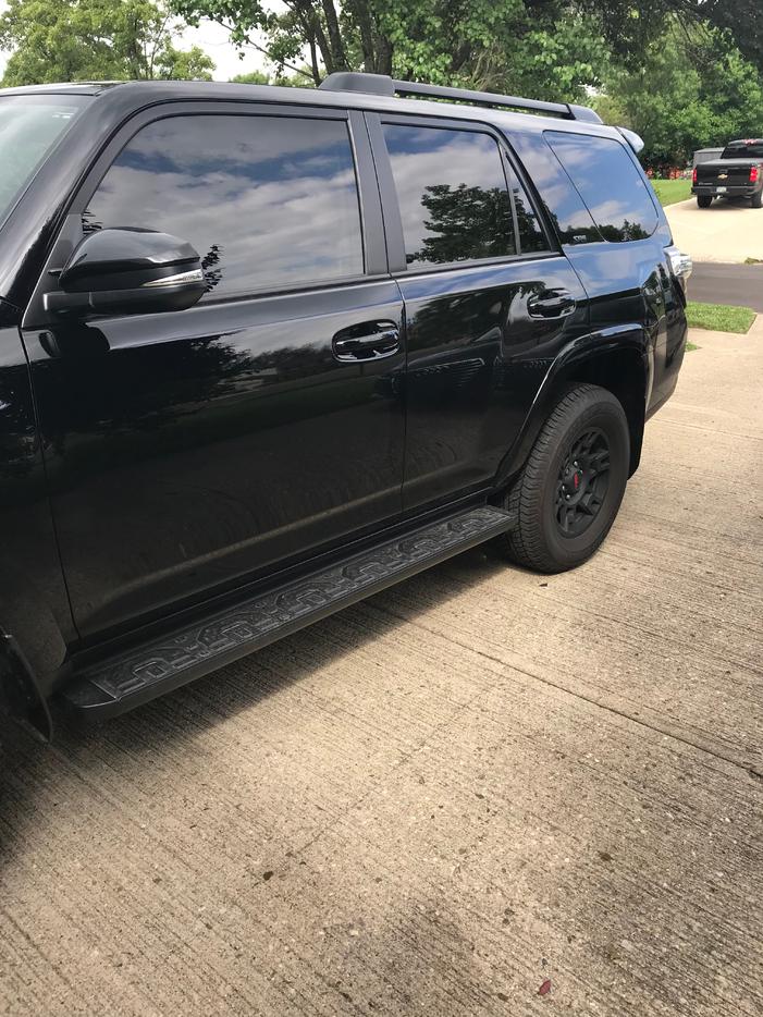

Picked up the 4runner from tire discounters , dropped off at 8am and picked up at 4pm at closing. Here are the numbers being measured from the ground up to wheel well
pre lift lift
Driver front 34 5/8 35 3/4
passenger front 34 5/8 36 1/8
Rear remained the same at 36 3/8
About one inch in front to level it out which was expected. Installed for $426 OTD with alignment the manager told me I made out like a bandit and the person who quoted this made a mistake. Initial impressions I'm glad I did this and for the price it was a solid deal. The rider seems to be firmer and as for steering wheel shake on highway I noticed nothing yet. The alignment may have taken car of that. The manager mention the factory alignment was pretty bad, only had 11k miles.

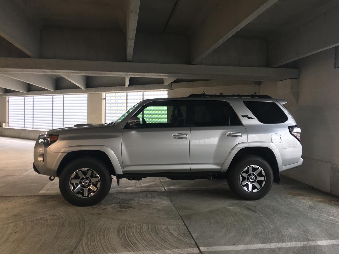

first two pictures are stock height

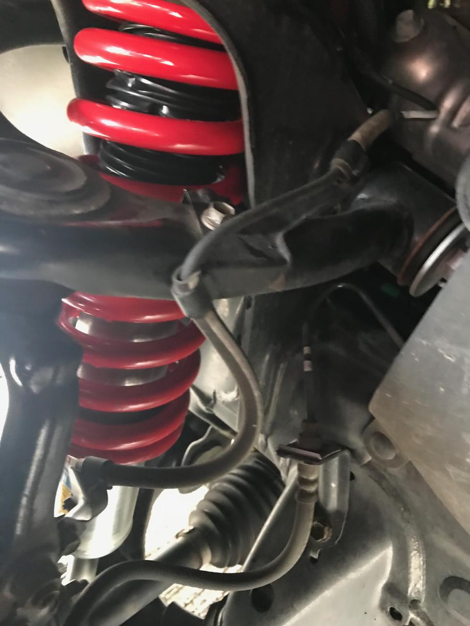

Front went in with no issues other than the driver side, you need to be careful of the KDSS hose near the spring.
Passenger side was no problem
All done!

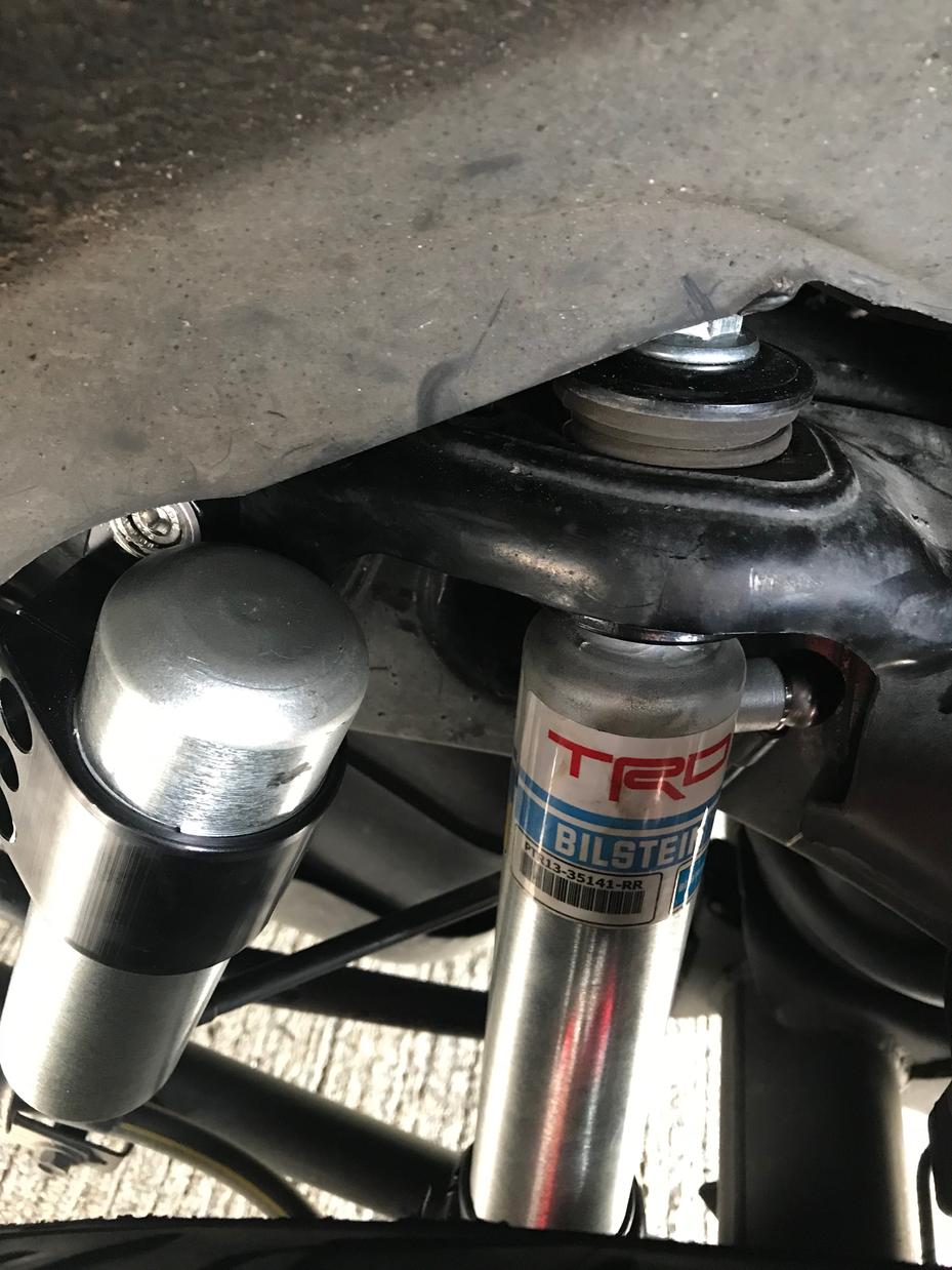

I got my kit today. You definitely need the dust boot as it contains a spacer with a flange on it. Without it you can’t assemble these. Pics for reference.
No boot. Threads end well before the washer, meaning you won’t get any compression on the bushing.
Boot installed. Just enough threads showing to start the nut and plenty of thread to get it tight.
