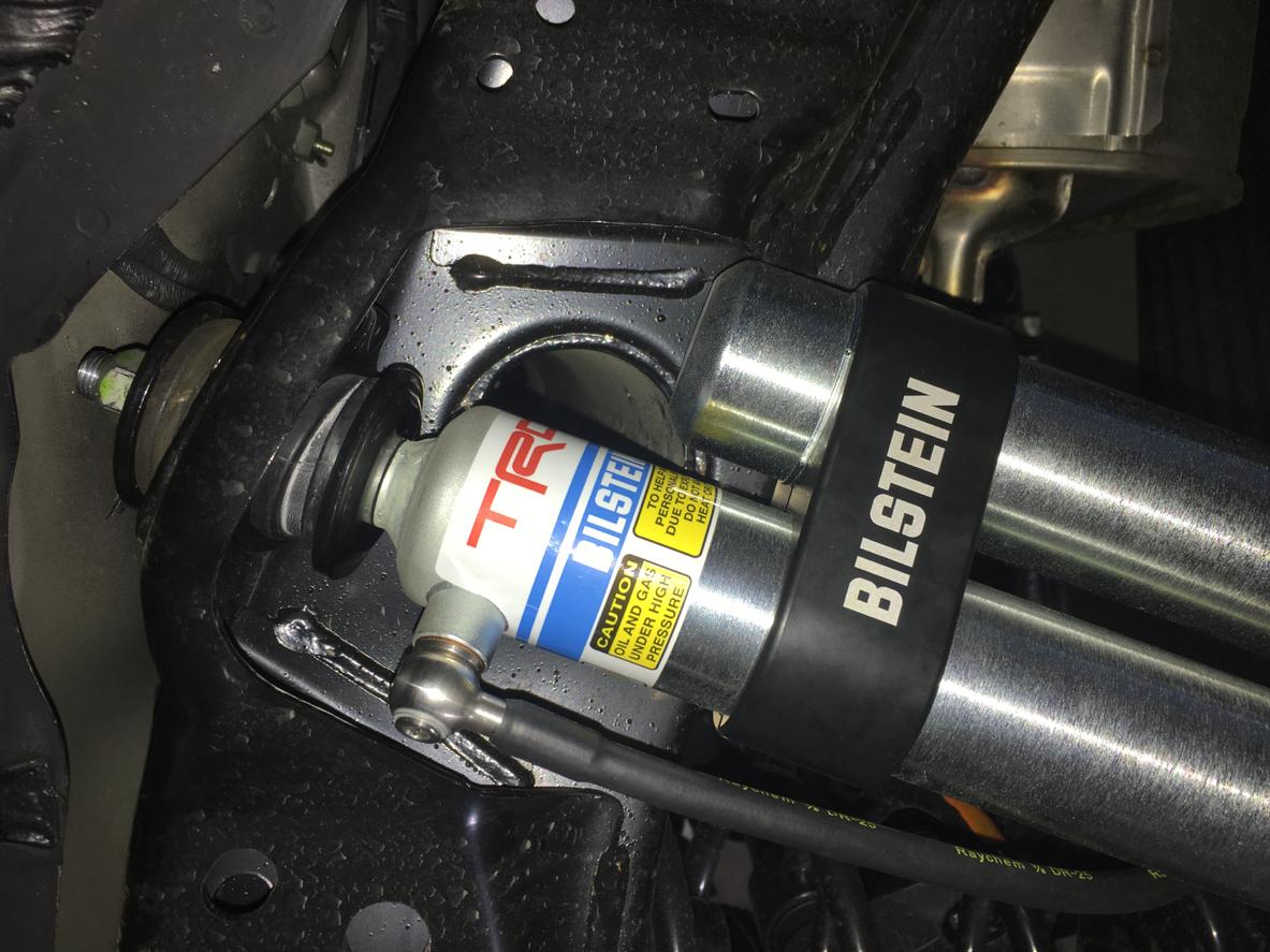

Here are my universal brackets from eBay for ~$25, free shipping
I can't remember exactly, but somewhere I read to install these brackets with the reservoirs angled slightly away from the frame, not tucked into it like that. Was it due to the rear link underneath it possibly coming up and hitting it? I'd make sure. I'll go look at mine later too. Can't remember exactly, but seeing yours like that threw a red flag in my head.

Please let me know; take a pic if possible.

That reservoir looks awfully close to the frame - could bend the bracket and/or dent the reservoir with any wiggle from the shock tower.
And it looks like the reservoir can slide downward; if it does, it'll stop at the ring (top protruding part).
That bracket is scary, with the thought that it can rotate towards the tires and causing all kinds of damage. Is there some kind of rubber on the insides of those brackets?
Just my 2 cents.

Thank you all for the great feedback and for the mounting bracket picture.
I mounted the rings (I thought since I don’t use the Toyota bracket I should keep the rings out) - wiser advise taken in consideration [emoji4] and relocate the reservoir.
Left:
Right:
The reservoirs are parallel with the shocks but since I worked leaving the tires on, it appears they are not. I will make it pretty in the weekend when I will have time to take the tires off.
The brackets are pretty sturdy (I thought they are flimsy too when I ordered it). Trey don’t move even without a rubber gasket inside (I had the same concern).
