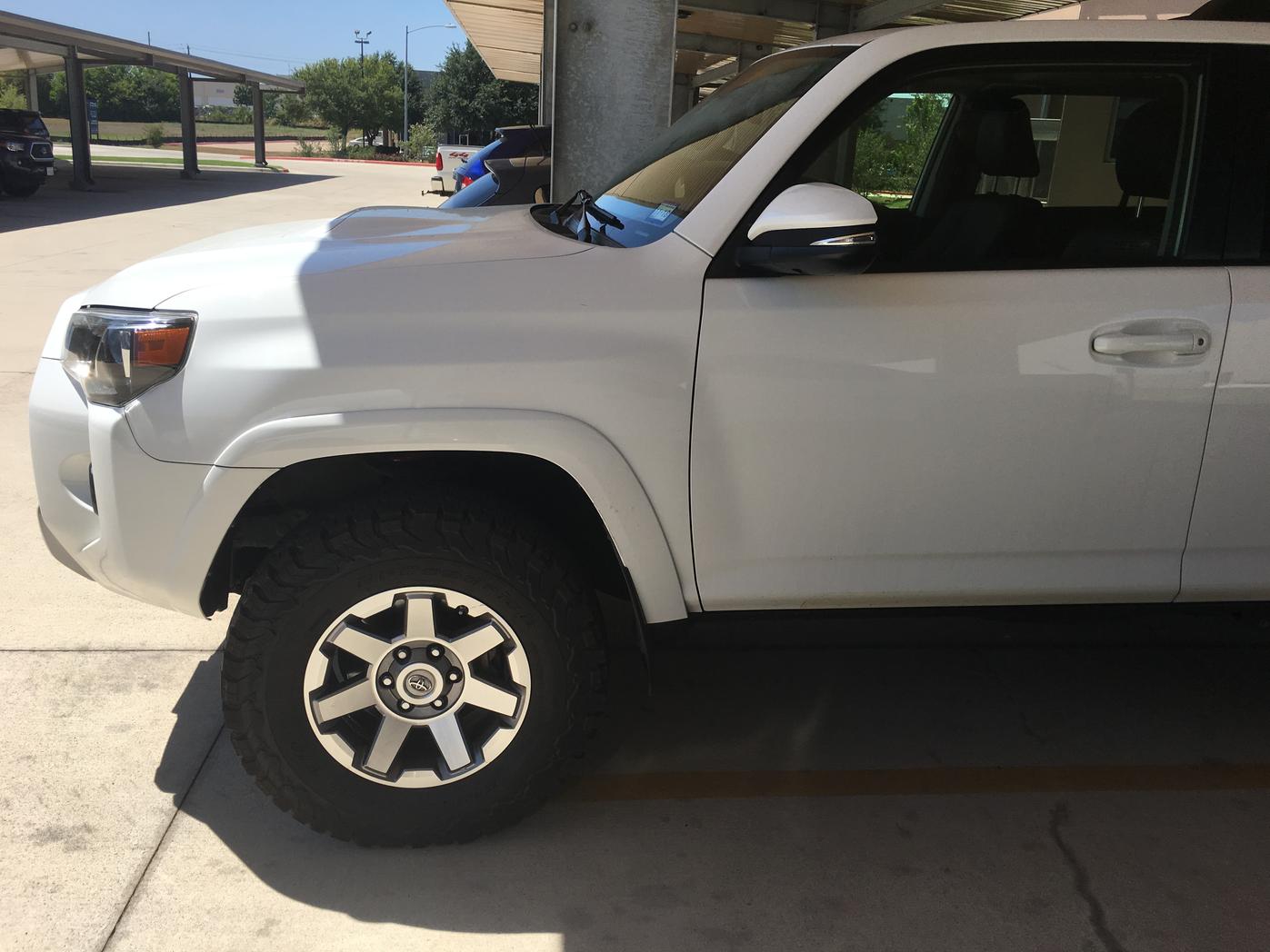

My front is starting to settle and already dropped from 37” to 36”

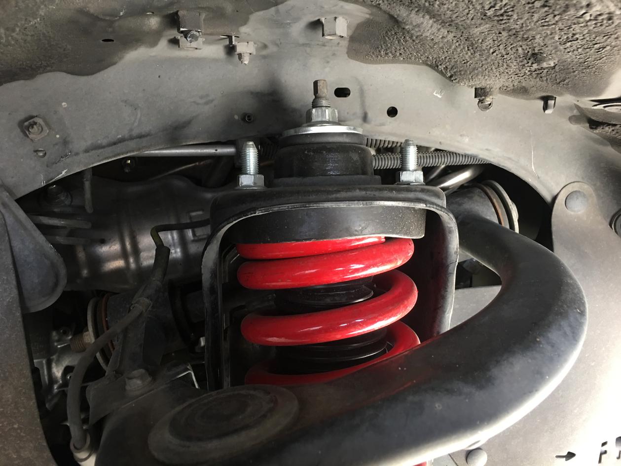

I would think that the 1" drop would be due to something more like the spring settling and less to do with the daystar spacer. I would also think that the rubber would make for a softer ride around town and over bumps compared to something like aluminum.
I'd be curious to see a picture of your daystar spacer in its current condition. Also, how many miles driven / months installed?
Possible. It’s been about a month with approx 1500 miles, no off-road, just city drive and potholes. I’ll take pics when I get home on Saturday.
@ CowboyTaco
Here's mine after six weeks or so of on-road service. So far no worse for wear and I don't feel like its dropped where I've noticed it, it definitely settled in the first week or so. Still rides nice and I'm not second guessing the lift or my choice on raising the front an extra inch with the daystar isolator.
