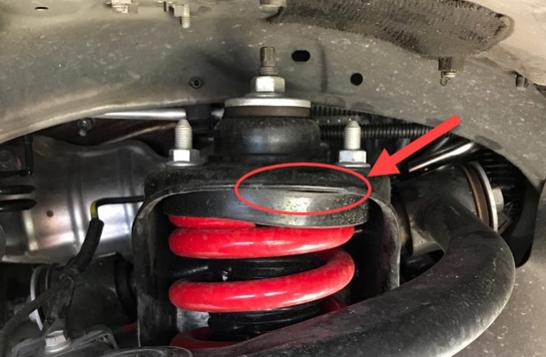

I am a little curious if everything is lined up properly in your picture of the FR. The daystar appears to have more of an "S" shape to it and you can see a little gap at the top. I've seen that once before on a Tacoma and the fix was to disassemble everything and put it back together slowly and make sure that everything is aligned properly. It should look more like the other side.

The daystar spacer doesn't have notches for the mounting bolts. Therefore it slightly deforms. The stock isolator has notches to prevent this.

I'm familiar with the spacer. While it doesn't have notches for the mounting bolt, it does have a raised lip on the inner opening.

This needs to be lined up and centered. Otherwise, it will look deformed. Notice how in [MENTION=209947]TodiN[/MENTION] 's pictures, the labeled FR has a gap between the daystar isolator and the shock mount. It isn't like that in the other picture (labeled FL). I've seen this before, and the fix is to disassemble and reassemble slowly while making sure everything is lined up properly.
I agree, I have to redo it. I think I know what I did wrong. If I remember, I did FR first and I secured the back nut first without going around.
