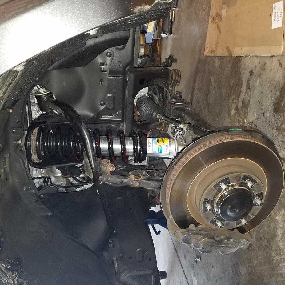

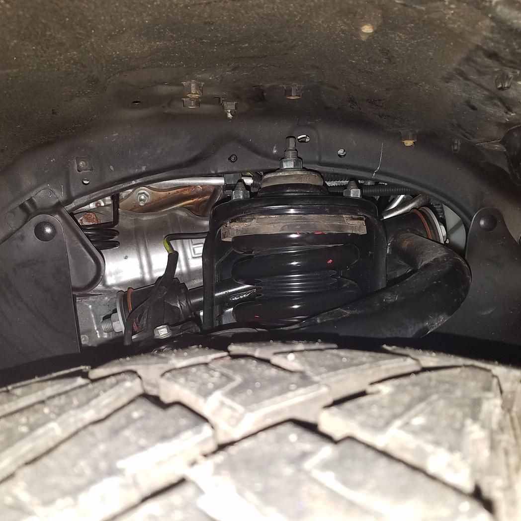

Literally just finished my swap about an hour ago. Did the "no spring compressor method" and reused the stock SR5 top hats and bushings which worked great. Kinda odd this kit doesn't come with new top hat bushings? I'm running a 1.5" Cornfed spacer in the back with stock coils, PN 5G4R-15RR Up front is the Pro kit which offers roughly 1" of lift out of the box. I added the Cornfed 3/4" top hat spacer PN 5G4RPRO-75FR so I'm at between 1.5" and 1.75" of lift up front over the stock SR5 suspension. I still have the 295s under it and they BARELY clear turning the wheel with it parked. I have a feeling they will rub if turning while in reverse. I will be dropping down to a P rated Falken Wildpeak A/T3W in 285/70/17 I don't wheel so this is purely for looks. If I did wheel, I would go with extended bump stops to help stop the rubbing. To run a 285 or 295 you really need 3" if you're going to wheel it.
To add to this, control arms are still at a great angle. No need for replacement uppers. I'll post alignment sheet once I have it aligned. May not be until next weekend due to having a very busy work schedule this coming week.
