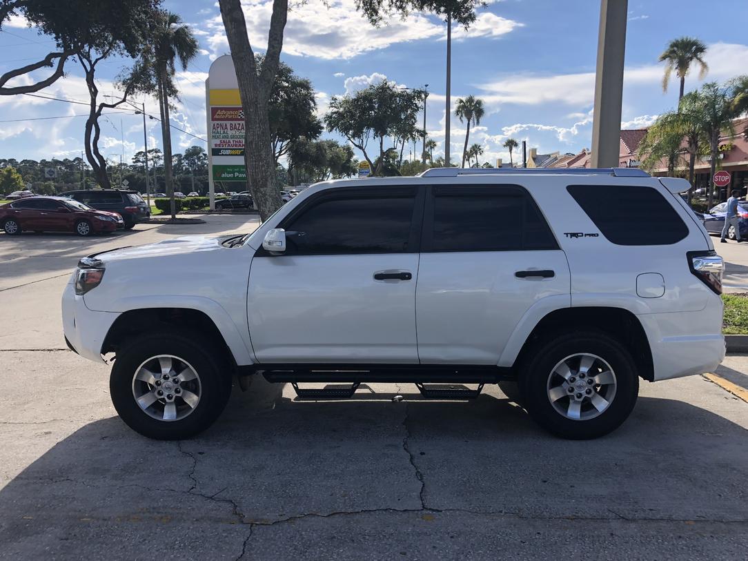

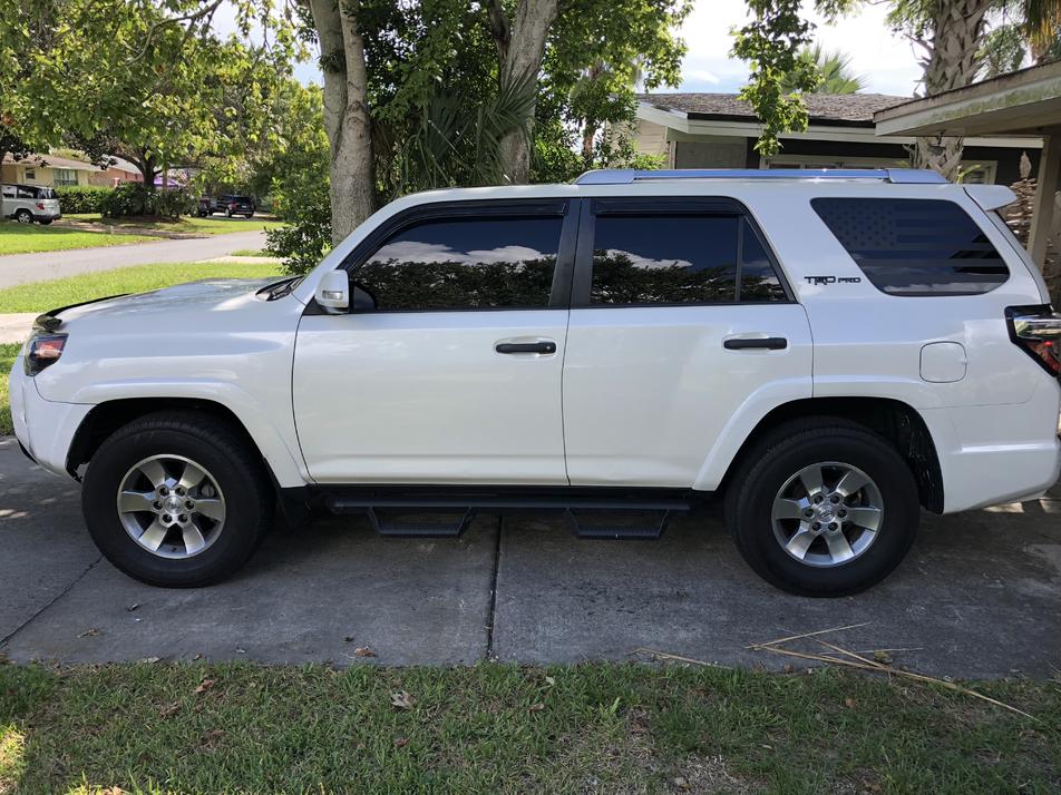

Here is a before and after shot. Dave [MENTION=7943]Cornfed[/MENTION] is very helpful and ships fast. The ride is smooth, like stock but with MUCH better handeling, and no nose dive but better cornering. Thanks [MENTION=2839]Akkording[/MENTION]
Your signature says TRD Pro tail lights. They're all the same to my knowledge? Would be a good idea to install the TRD Pro wheels and black roof rack caps since it looks like you're trying to build a clone.
Yes that is correct but I listed them that way because that’s what they came from, a 2016 PRO. And my next upgrade I’m the works is a set of the pro wheels and a new roof rack.

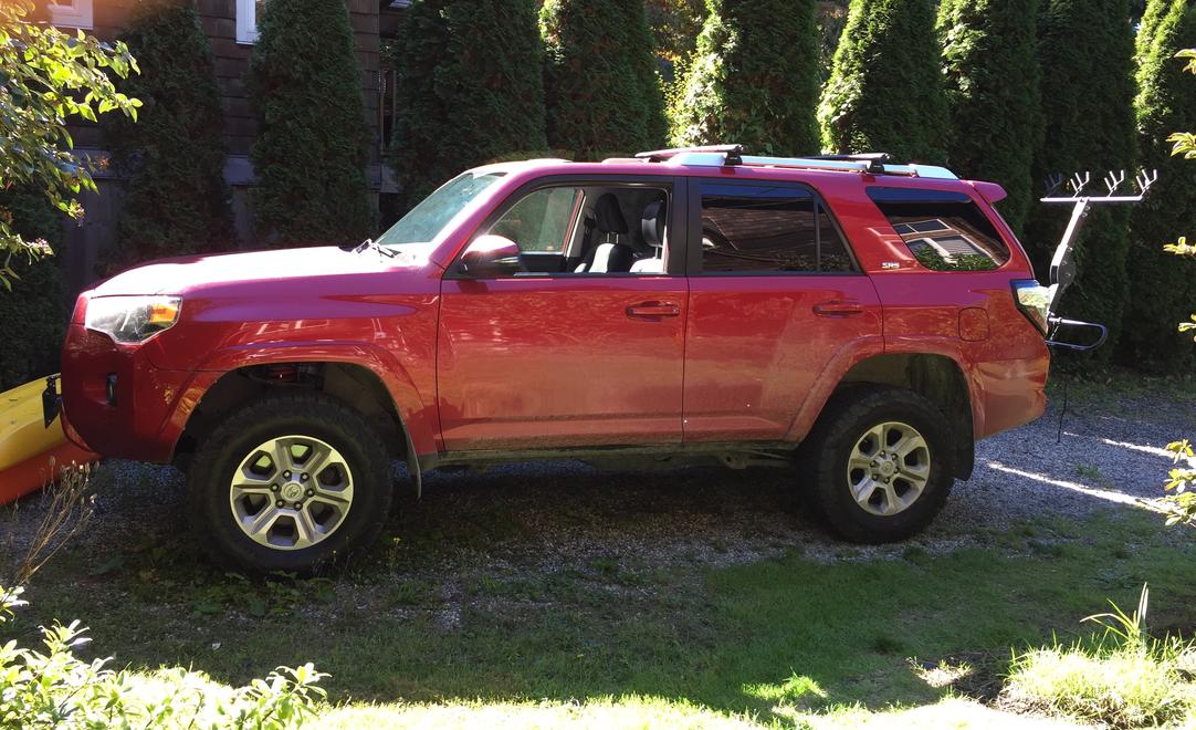

Pics! Not a great one, and no before, sorry. I like it, just looks like.. a normal truck. Not jacked, not low.
1/4" spacers front for 1.5", Dobinsons C59-599 rear for 1"

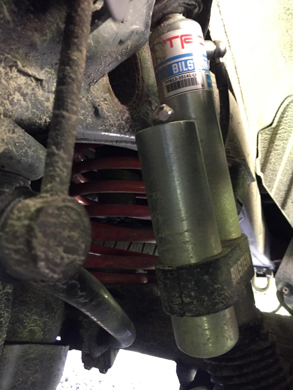

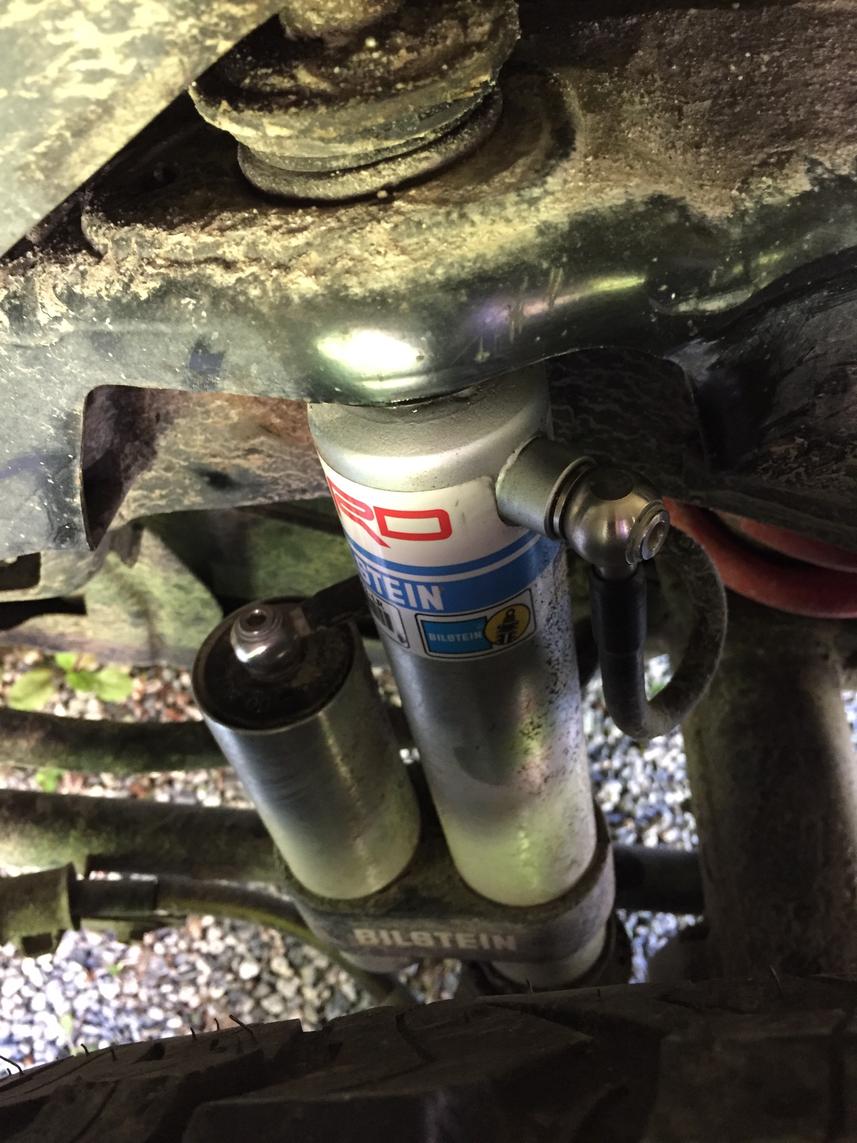

Also - can anyone tell from these terrible shots if my reservoirs might be too low? I think I see a rub spot on the bottom of the left side.
Looks good! I don't have much of an opinion on the location of the reservoir. It probably doesn't matter, but I would flip it to maintain the OEM orientation so that I wouldn't have to think about it anymore.
