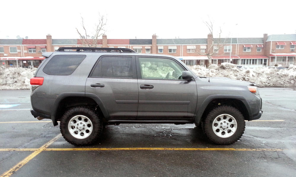

How about showing me some lifts using the adjustable Bilstein's. What did you use on the rear?
Here is mine: Bilstein 5100 at 1.75 " height with SAW rear coils. You need to have some rake to become level with mild loads and avoid a reverse rake.
