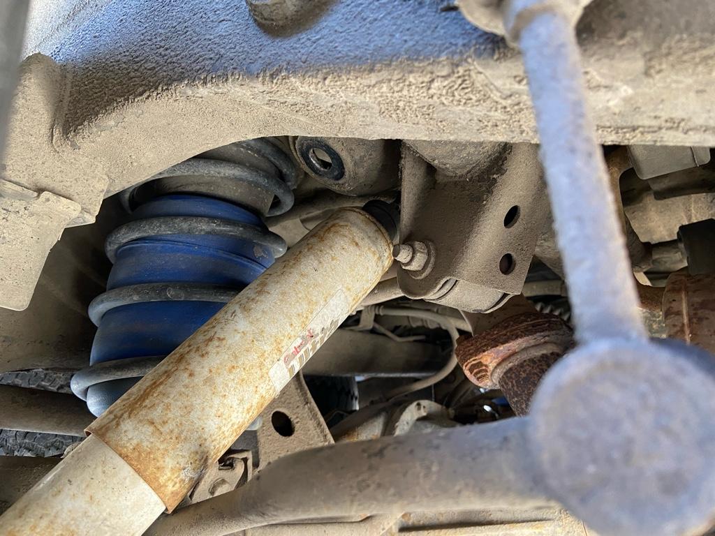

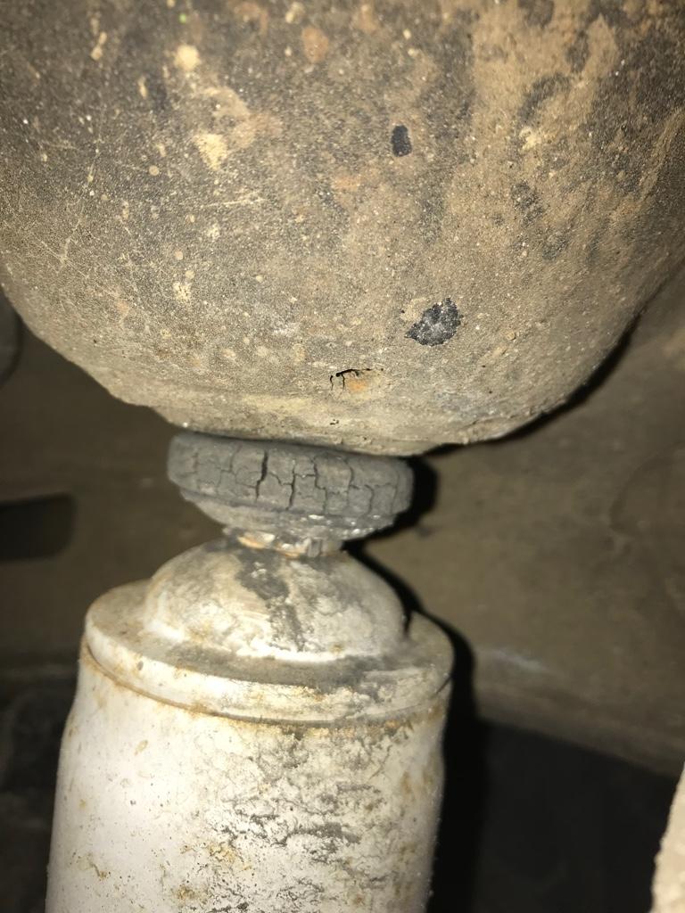

So this happened a while ago while I was up skiing. As far as I could tell the top nut somehow loosened itself.
I broke my shoulder right after, so the few times I've driven it since then I've just pumped the airbags up and not gone very far, but now the time has come to decide whether to get some hardware to replace the Gabriel shocks that are on there, or go for some new ones. I couldn't find any info about the ones that are on there, and my records go back pretty far, so I'm leaning towards new ones.
I've heard a lot about the Bilstien 5100s, and my dad really likes bilstiens, so that's the way I'm leaning, but I'd like some input. I have Toytec ultimate coilovers up front, on the lowest perch, and I believe the back is on OEM (not original) '99 tall springs.

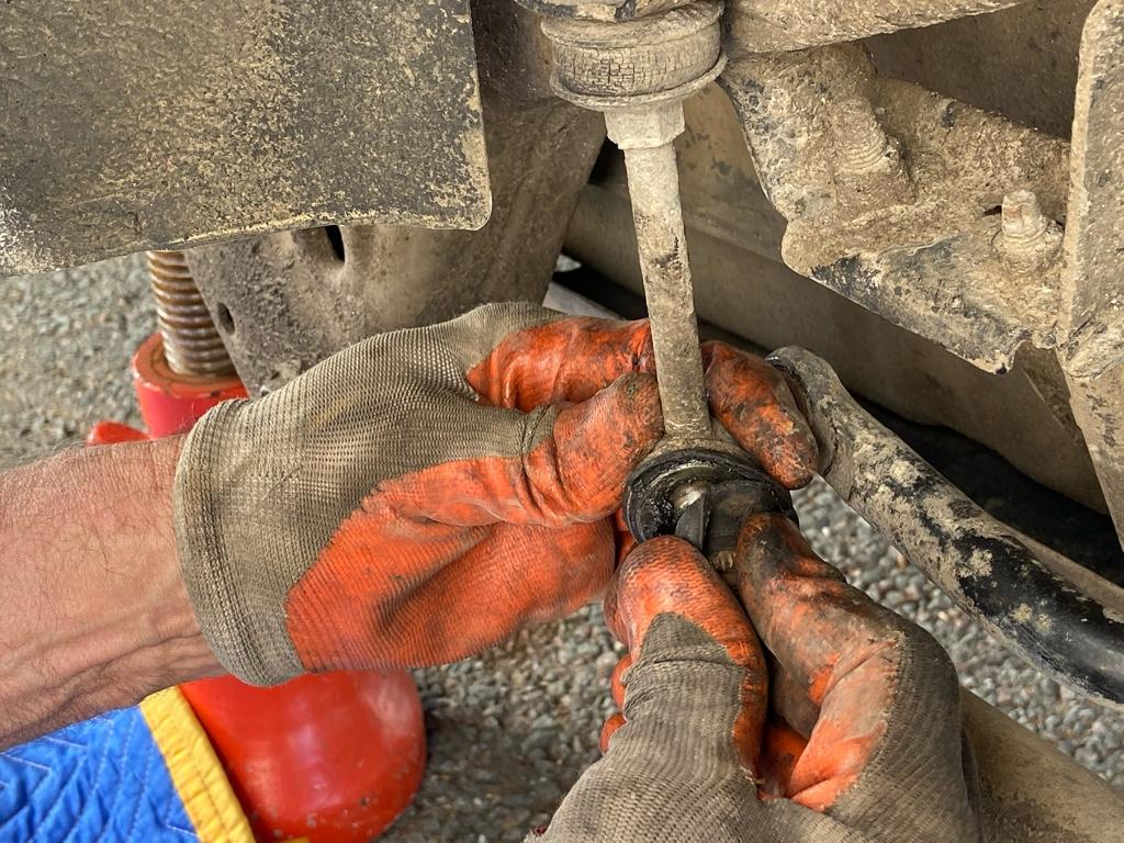

I ended up going with the bilsteins. Wheelers offered what I felt was a pretty good deal. I wouldn’t say the ride quality is loads better, but the peace of mind is nice, and there are certain potholes I’m familiar with that feel less jarring now. I have to replace a ton of worn (or just plain gone) boots/bushings though. I’m embarrassed I let some of these get by me for so long.

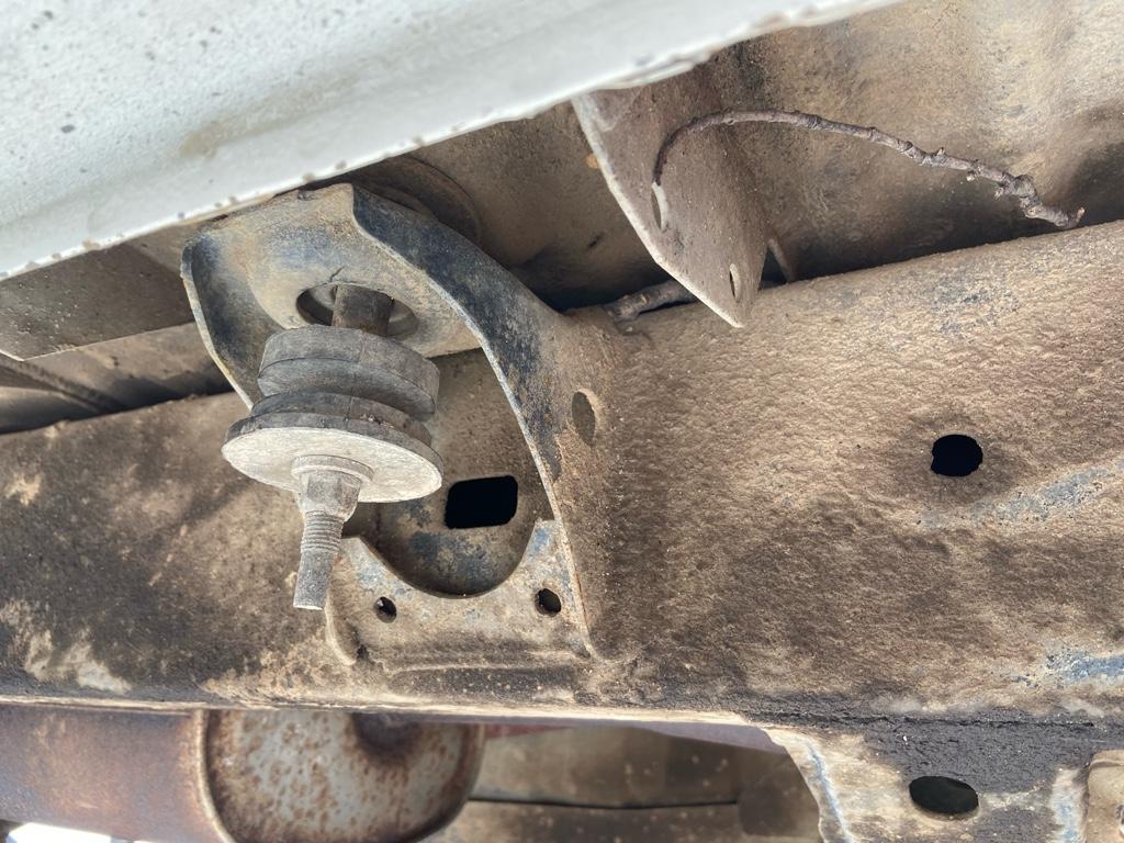

Shouldn’t there be something else between this body mount, and the frame metal??
