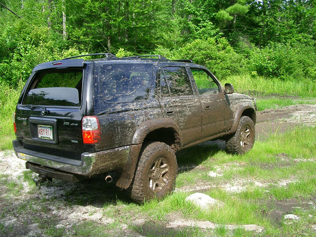

Lee, I found a reply in an older thread from you, stating that you have absolutely no rubbing with the tires. Great. New concerns: (1) With the one inch lift springs and larger tires, are there any other mods needed, like chassis drops or brake line extensions, or steering shaft extensions, etc.?
Nope! no other mods required at all. tires do not rub one bit and shouldnt even at stock height.
Originally posted by RockyMtRunner
(2) The Bilstein HD shocks listed for my 2000 4Runner 4WD on the Perfomrance Product site are for "original height." Did you use Bilstein HD's for the "original height" listing for your 2001 Runner, or is there a better choice? Thanks for sharing your knowledge and experience.
i bought mine off ebay (they were cheaper). i got the stock-height HD ones, yes. You only need long travel shocks for higher lifts like 3"+... thats what my research turned up at least.
Your Runner rocks, but I gotta ask you one more thing. I can't afford changes that just "look great." I need performance. I'm used to going anywhere and everywhere on Colorado's Jeep trails in my original but reliable '95 Tacoma, which I just sold with 168K miles. I would like to beef up my newly purchased 2000 4Runner to equal or better the Tacoma's trail ability. Will your PP 1" lift, Bil shocks, and 265/75R16 Goodyear's give significantly better rock and rutt performance, or do I need to go for heftier mods or maybe even back to a Tacoma? Right now my pudgy, original Runner with 108K rides more like a Buick than my good old Tacoma, even though a Runner is supposed to be somewhat similar to a Tacoma. Can you give me some encouragement? The SUV concept is much more useful to my dog and me than the truck bed, and that's why I went to a 4Runner.
i have seen some pretty rough crap in my time since the lift. ill link some picture galleries for you below of stuff ive seen and how dirty my truck gets.
as with anything, you have to make the choice yourself. ive climbed over obstacles in deep fear thinking i couldnt do so, but have come out relatively unscathed and proud of my runner for doing its job.
stock runners can do amazing things, so a small lift, tough shocks and good tires go a long way. its my opinion that 4runners are underestimated by their owners a lot. we have a couple of stock runners in our NE4ROC group that have tackled a lot of tough obstacles. wheel smart and youll be OK.
here are some galleries that i hope will help you make a choice:

my rear and front ends are even, actually, so im surprised to hear this.
as for the question about whether 99s and 00s will see lift, id say they will. these are about 2" of lift (a smidge less), and your 99/00 springs have most likely settled a little bit. it may not be a huge lift, but if you wanted a lot, then you wouldnt go with these springs.
also, 70's and 75's have no inherent difference in balancing... its the brand and style of tire you choose that matters. my mt/r's have balance perfectly.
