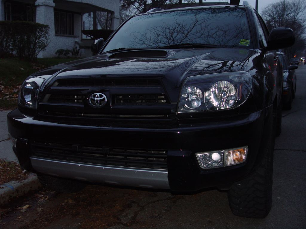

I baked mine at 325-350 for about 5-7mins. Use EasyOff oven cleaner to strip the chrome off, only takes a few minutes. Scuff with steelwool and apply what ever color suits you. Krylon Fusion is what I used. Put them back together, put in the oven for another 3-5 minutes and press them tightly together. I used rope caulk around the seam to ensure that they are leak free without making a mess.
Since then I have done the fogs as well. Same procedure, turns will be next.

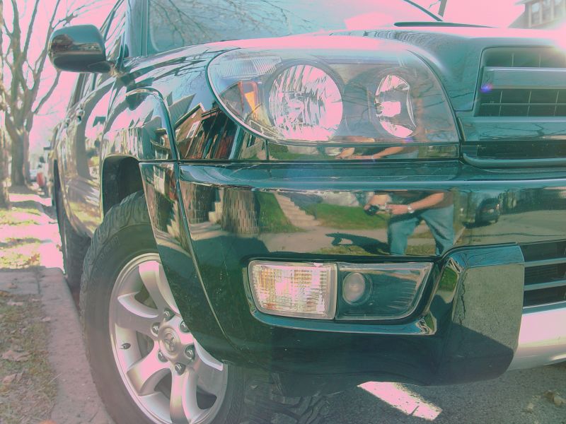

Here ya go, my camera is on its last leg so if I get something better I'll throw on. The turn signal is not done yet, maybe soon if the weather stays nice. You can see the contrast with the blackedout fog lamp.

Yeah, you might want to ask Santa for a new camera......lol
That does look really cool. I suppose since the fogs are projector beams, it doesn't make any difference? Cool idea!
I can't tell any difference in the light output, they don't seem to be that bright anyhow. The camera is going back for service, second time now. I'll try to get to the turns soon then the whole front will be blacked out. Stealth style, then I'm thinking of getting the black magic hellas and of course i'll be talking to burtman about some black tails then.
