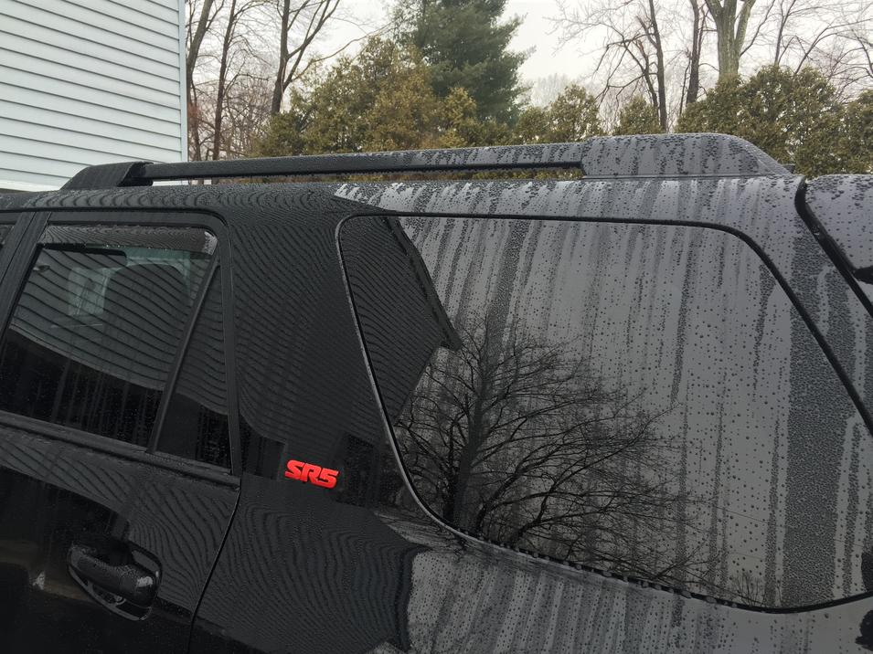

just had my rails painted black. Didn't like all that chrome look up there without it being anywhere else. Also had all the SR5 logo's and TOYOTA lettering painted red to match the TRD red on the wheels. Not sure on the front and back in red yet

Painted
Removed rails and had them painted. Up close they look great.

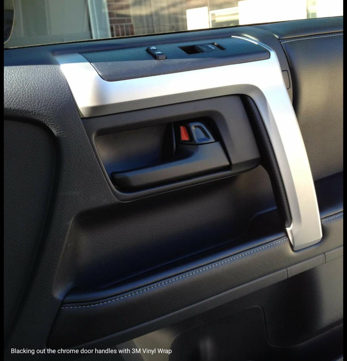

3M Vinyl Wrap
For an inexpensive and reversible fix, try 3M vinyl wrap, which you can order from Amazon or other preferred seller. I've only used it on my interior door handles (I deleted the roof rack). This was the first time I used the vinyl and I thought it was fairly easy. The roof rails and end covers should be easier, if you remove them first. I didn't like the glare off the chrome handles.
so this was pretty simple? didn't have to take anything off? 2 things I don't like inside are the door handles and that piece of aluminum on the passenger side above the glove box. didn't like the center console, either, but i pulled that out and shot it with plastidip.
