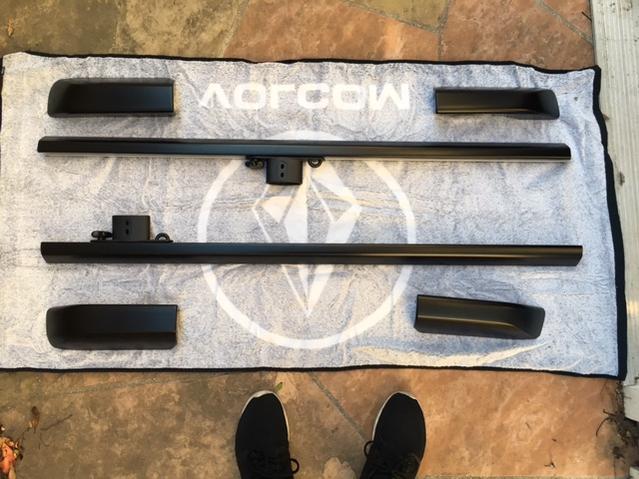

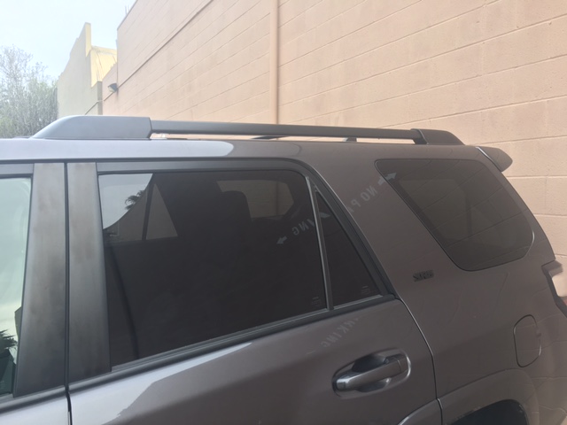

Hey guys, new member but not new to the forum. Thought I could chime in since I got a lot of help with my decision from this thread. I decided to wrap my roof rails and end caps in black vinyl. Painting is a cheaper and more durable way to do it, but I'm super picky and can't commit to permanently painting something without knowing what it will look like ahead of time hah.

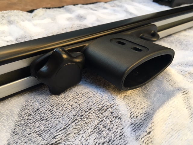

But I had the roof rails and end caps of my 2105 SR5 wrapped in 3M 1080 Series Satin Black. I had doubts about choosing satin over matte but really glad I went with satin. The 1080 3M Satin black is more matte than it is gloss; exactly what I wanted. I removed the silver roof rails from the black mounting brackets along with the end caps ahead of time so it would be easier for the installer to wrap. I also specifically asked to leave the channel open so the OEM crossbars can move freely for any roof/ski rack. I left a slider from the OEM cross bars on each roof rail when I handed them to the installer so he could measure where to start/stop the vinyl.
When reinstalling the rails, I wrapped thread seal tape around the white nipples in the truck body, that the mounting brackets bolt to. This was probably over cautious (especially because I live in So. California) but that is a weak spot for a potential leak into the cabin. A silicone bead around the bottom would have been ideal.
I attempted to add pictures but this being my first reply/post, I probably botched it, my apologies in advance. Hope this helps anyone like you all helped me.
Cheers,
- TB
