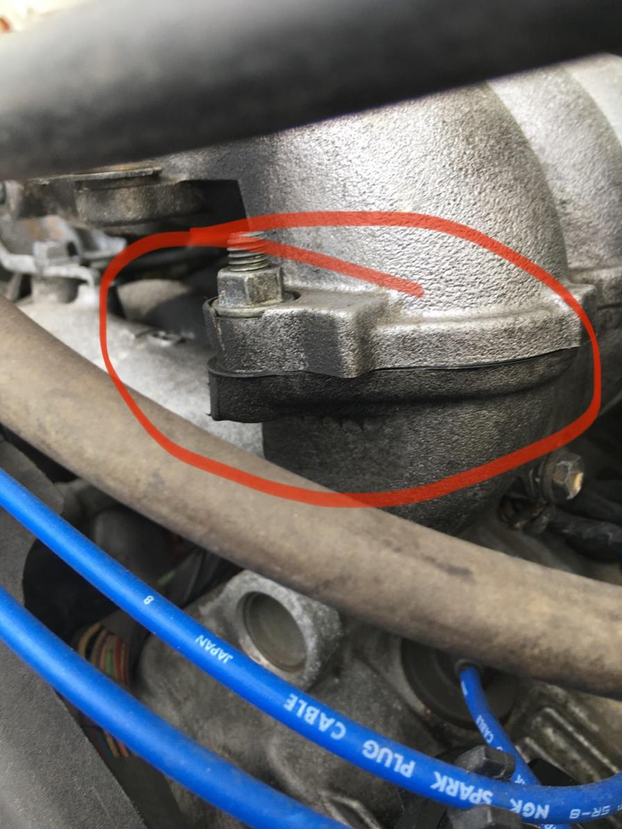

F flygirl0344 New member Oct 22, 2019 #1 It kinda just appeared almost overnight. From the pic, does it appear the manifold gasket needs replacing? So far everything is working fine..maybe a slight smell which I attribute to whatever is going on in the pic. Thanks in advance. Attachments manifold.jpg 130 KB · Views: 457

jgue467 Senior Member Oct 22, 2019 #2 Accumulated dirt from the fan blowing on it constantly? :cowboy:
1 19963.4lsr5 New member Oct 22, 2019 #3 If you had black soot coming out of your intake manifold plenum your rig would be undrivable in my opinion Sent from my iPhone using Tapatalk

P phattyduck Elite Member Oct 22, 2019 #4 jgue467 said: Accumulated dirt from the fan blowing on it constantly? :cowboy: Click to expand... Yeah, this doesn't look like a leak. Also, during operation the engine sucks air IN to the manifold, it would be odd for stuff to be coming back out. Clean it up and see if it returns. -Charlie

jross20 New member Oct 22, 2019 #5 Looks like normal engine dirt, haha. I hate is and try to clean her all the time
