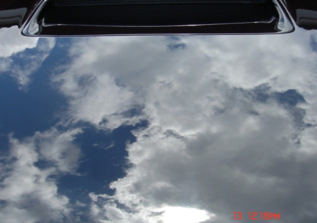

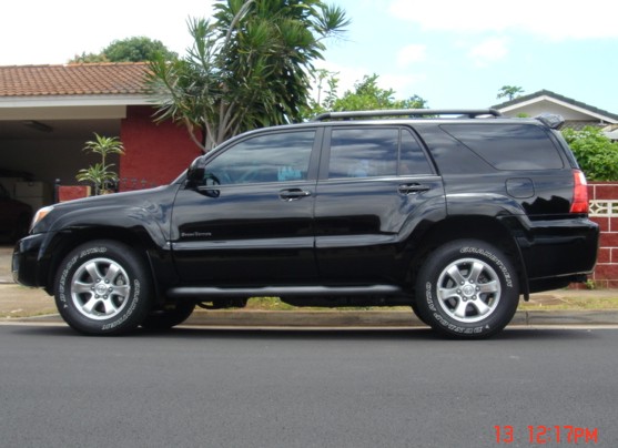

For the very first time, I completely detailed my truck over the weekend:
Saturday
- wash the truck with Dawn dishwashing soap using 2 buckets
- dried it with The Absorber
- used ClayMagic Fine Grade Clay Bar (blue) and Meguiar Quik Detailer from top to bottom, inside and out
- used Klasse All-In-One with an applicator and wiped it with a microfiber cloth
- used Klasse High Gloss Sealant with an applicator and wiped it with a microfiber cloth
Sunday
- (after 24 hours) waxed it with Meguiar's Gold Class Liquid Wax
- dressed the tire with 303 Protectant
- polished the chrome grill with Meguiar's Chrome Polish
- polished the exhaust tip with Meguiar's Chrome Polish
- wiped the inside with 303 protectant
