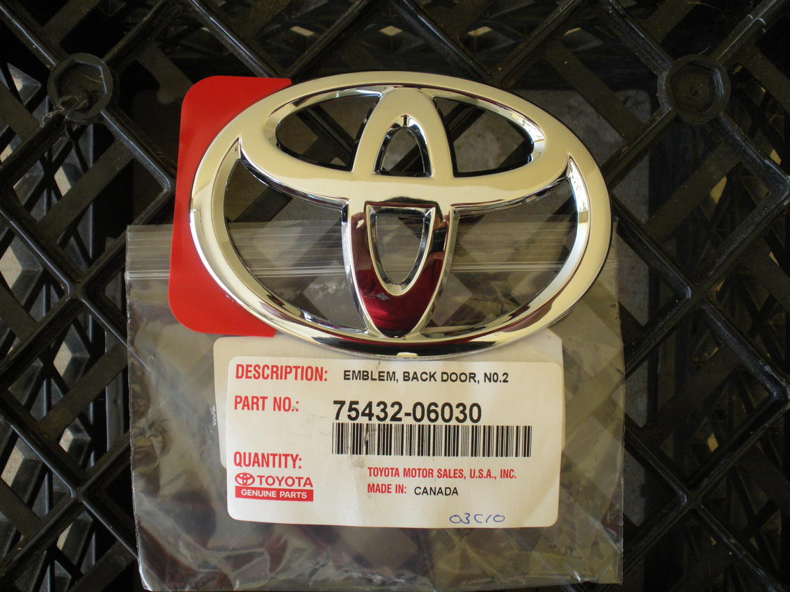

the toyota emblem on the front is real easy to remove. painting it black was one of the first things i did. just pop your hood, remove the black cover which is held down by pop pins reach down there and feel for the clips that hold the emblem in. if you release one of the sides it will pop right out.
for paint, use Krylon fusion, it's perfect for plastic. good luck on those other pieces. i assume they are glued on, so you'll need to heat them up to soften the glue to remove.

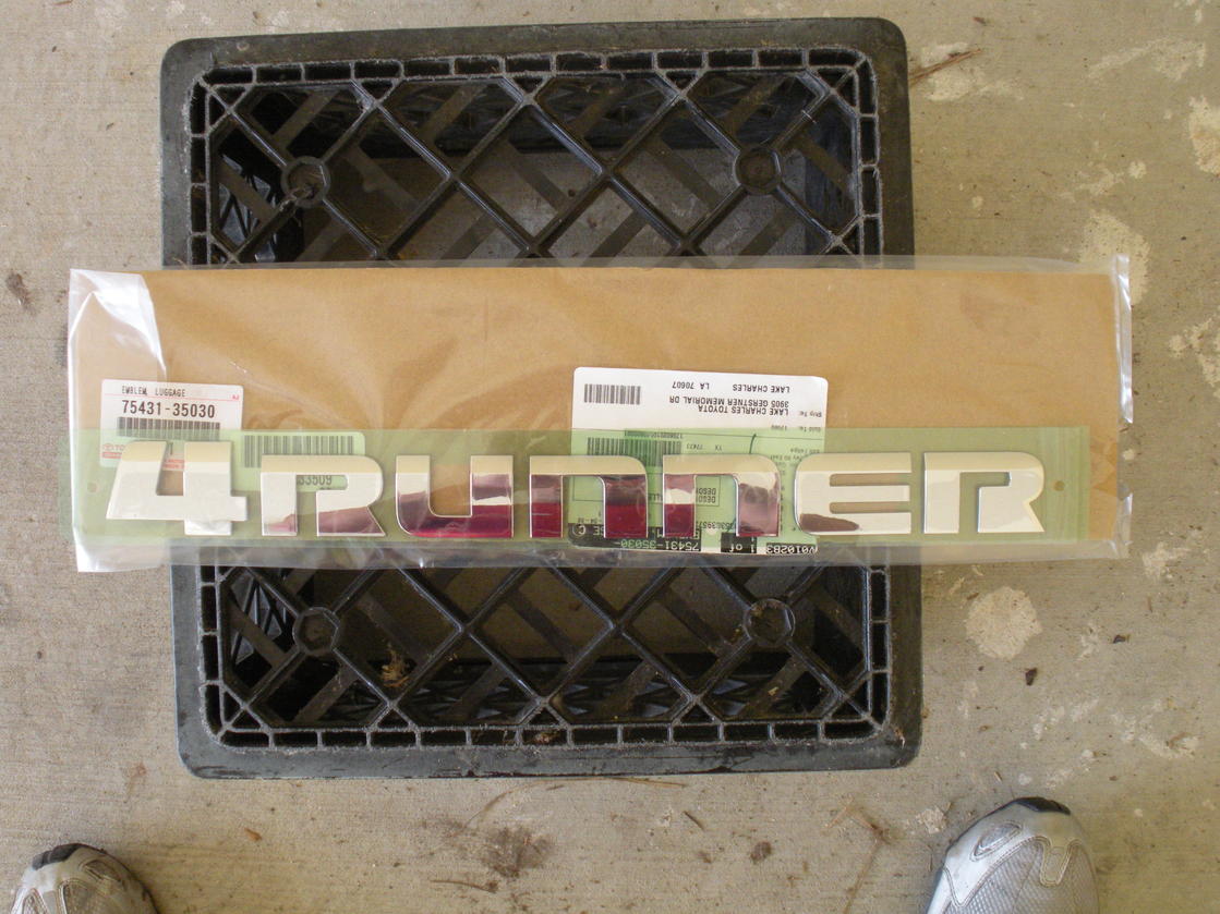

I'd have to write a book to explain it all at once.They are all plastic clip on except the door handles,lift gate emblem and roof rack.The back piece with the 4-R-U-N-N-E-R logo is very hard as you have to take the lift gate apart.

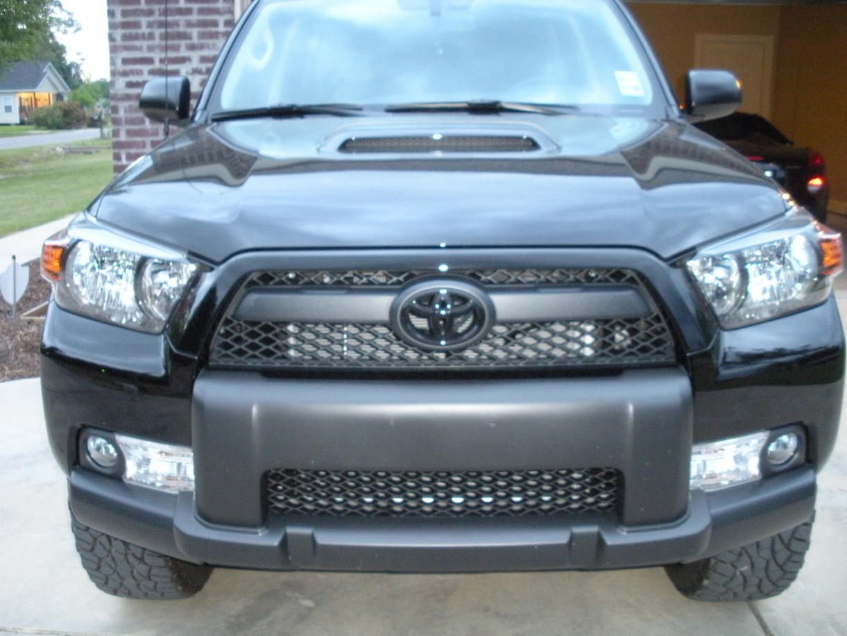

EDIT: I finished the roof rails/end-caps and front Toyo emblem/horizontal piece in Fusion Satin Black. I regret going with Satin Black not because it looks bad, but because I think it probably could have looked much better in Flat Black. Just a tip to you all and food for thought. Pics up soon in my Mod Thread.

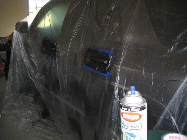

Write-up

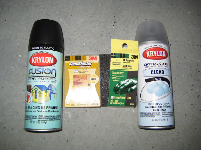

Step 1: Buy supplies shown below if you want to convert chrome to satin black. If you want flat black, go out and buy that instead (I recommend flat black but it's very hard to find in Krylon Fusion).
Step 2:

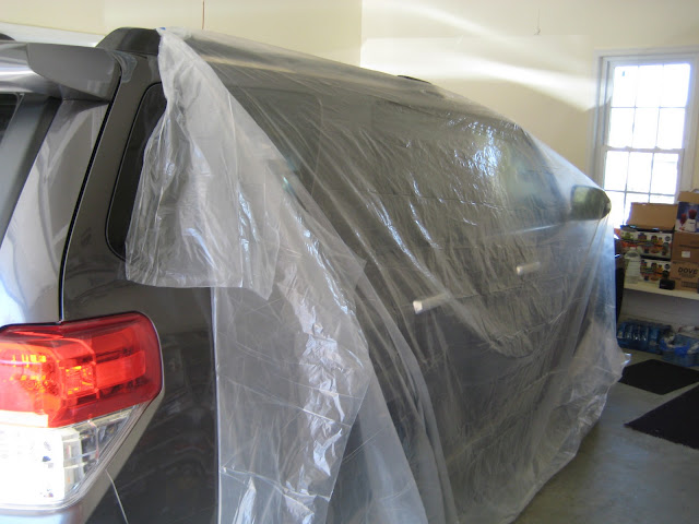

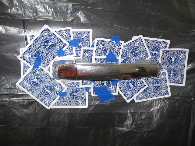

Buy a plastic Dropcloth from Dollar Store for a buck and cover the entire side of truck. Then, cut out a piece of plastic so the handles are exposed through plastic.
Step 3: Using playing cards, insert them between the handle and actual door. For the most part, you should be able to wedge them in there. For the areas where you can't wedge them in there, just tape them in place. The cards serve as excellent protectors against paint on the actual door itself.
Step 4: Sand down the area to be painted using 320 sandpaper.
Step 5: Next, get a wet paper towel and wipe down the area well to remove all the sand filings and any loose dirt and grime.
Step 6: Shake can of paint for a minute and apply first coat being sure to start well off the door handle and ending well off the door handle. DO NOT douse the handle with the first coat. Even if the first coat appears very very light, that is OK. TRUST ME ON THIS ONE BECAUSE I SCREWED UP ON ONE DOOR HANDLE since I put a heavy coat on with the first coat. REMEMBER: put on LIGHT coats and you will need to put on 6-10 coats. I read somewhere that I needed about 3 coats of black paint. This was the mistake I made on the handle that I ended up screwing up. On all the other handles, I did a good 7-8 light coats, and the results were BEAUTIFUL.
Step 7: That's pretty much it. Be careful removing the playing cards and plastic dropcloth as the newly painted surface is fragile for the next 7 days while the paint cures and bonds to the plastic door handles. I drove 3 hours on the highway at 70mph that same day that I finished these handles and thankfully didn't have any rocks fly up and chip away the paint.

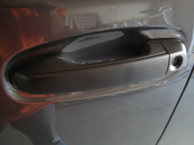

I'm not done yet. I still have the rear '4RUNNER' logo, chrome strips, and fog light surrounds to do but here is a pic of the final product so far which I like MUCH better than with the chrome accents:

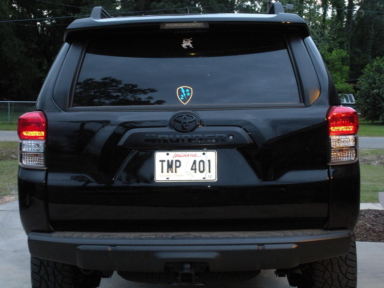

Tactical emblems
thought i would share some pics if anyone was thinking of doing the same
