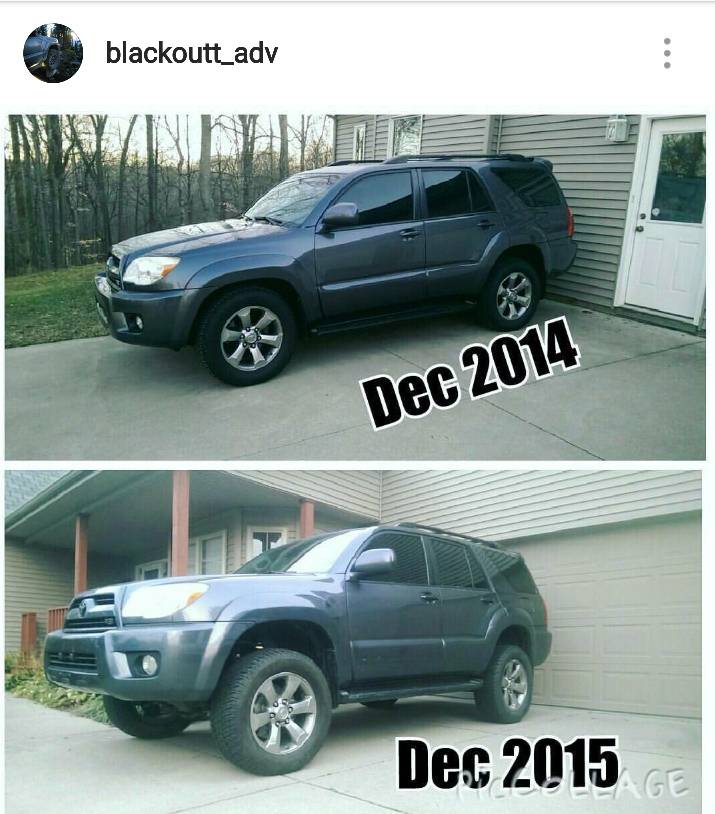

Day 1 December 2014 to December 2015
December 2015 to December 2016

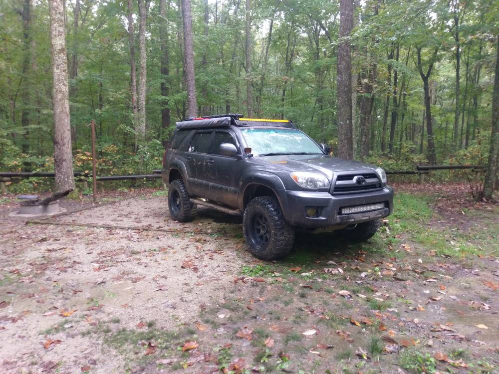

Suspension/Lift
Fox 2.5 extended front coilovers, remote reservoir with DSC
Fox 2.0 10" travel rear shocks, w/ required Fox lower bushing
Icon SS shock skids/roost guards
Dobinson 677V rear springs (1.5" daystar driver side spacer to correct lean)
SPC upper control arms (warrantied for greasable style BJ)
Wheelers super bumps front
Wheelers super bumps on custom 2" drop bracket rear
Differential drop
SS extended brake lines
Energy suspension sway bar bushings, lateral lock collars
Diff breather extended to gas filler
1" body lift
DIY taller EPDM fender liners
OEM LCA hardware
Weld bead behind LCA cam tabs
OEM front LCA with Moog greasable BJ and Energy suspension bushings
OEM rear control arms refit with Energy suspension bushings
Toytec adjustable panhard bar
5x XD 301 17x9 -12 wheels
5x Cooper STT Pro 295/70-17
Body mount chop, pinch weld flattened, liners pushed forward, bumpers trimmed, mudflaps removed

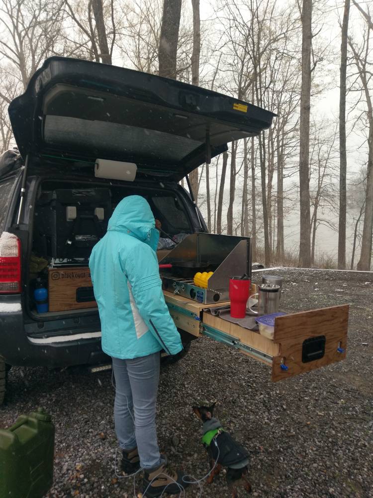

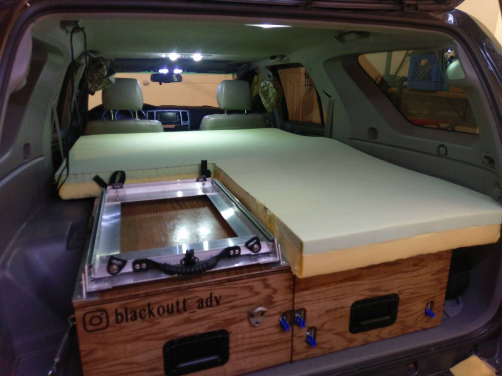

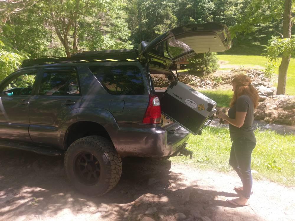

Adventure Index drawer system (diy)
Partner Steel 22" stove
Sleeping platform off of drawer system
Rear seat and double decker system delete

DFG tilting fridge slide
Dometic CFX40W with bag

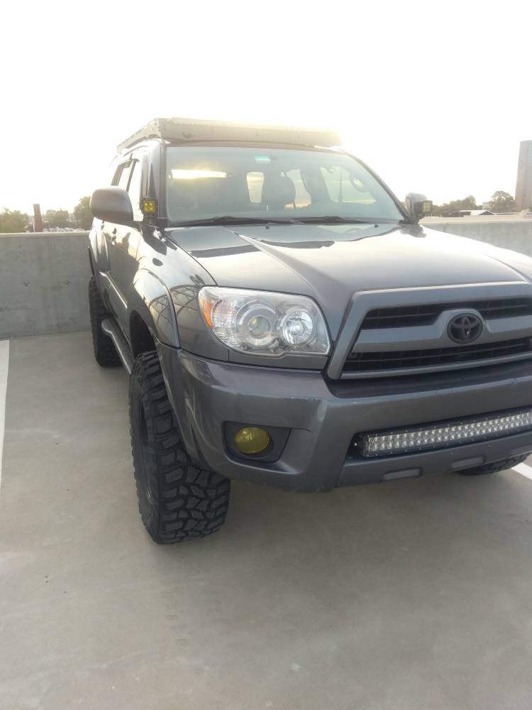

Anytime fog light mod
HID fog lights
Yellow fog light laminex
Mojavemadman bumper light bar mounts
30" Auxbeam curved light bar

42" Xprite sunrise light bar

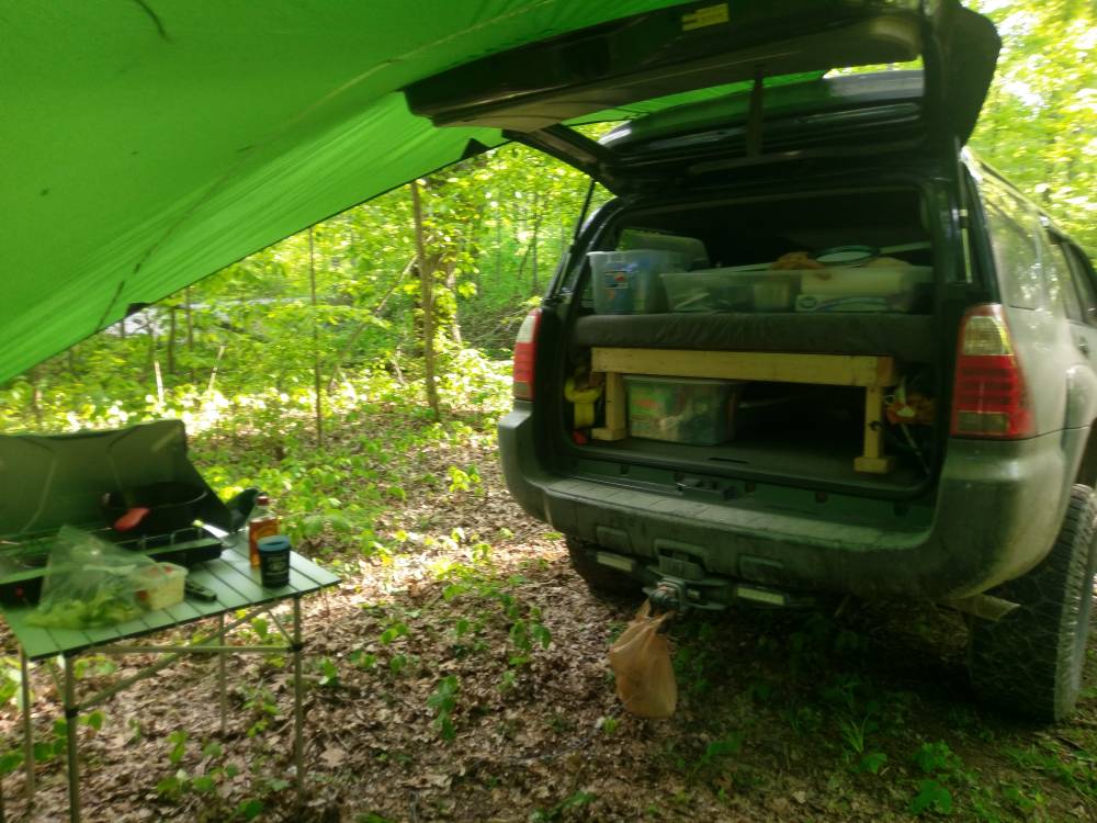

Old platform, driven by the height of a Pelican 60 cooler up front

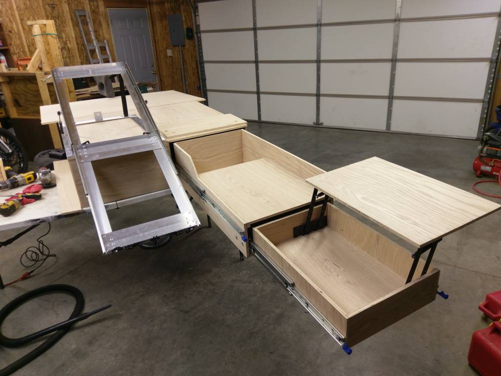

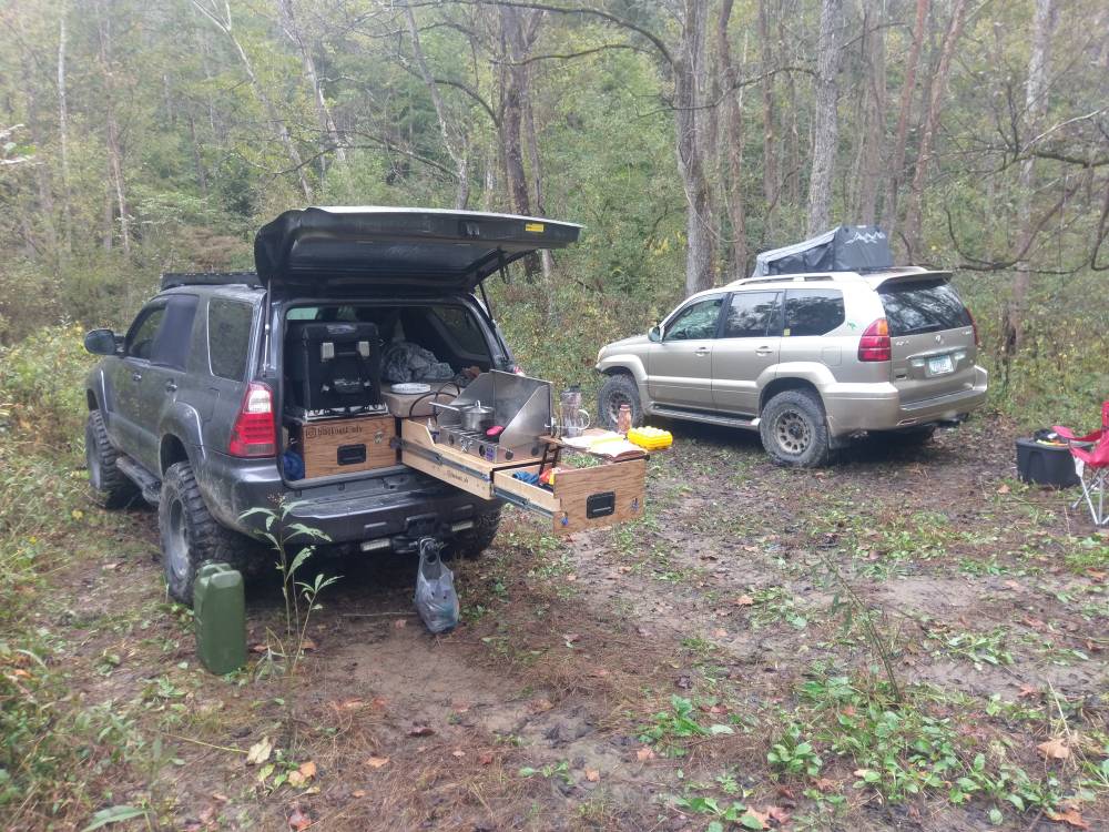

Building the new "Adventure Index" drawer system spring of 2018
Complete with tilting fridge slide

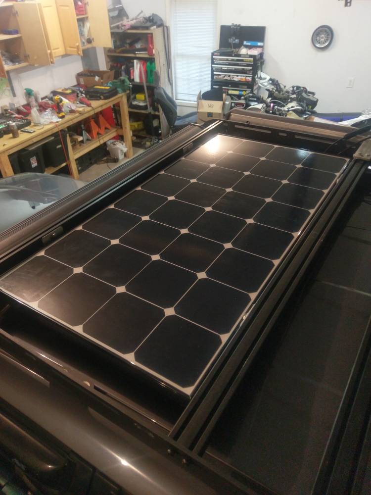

Renogy Eclipse 100W solar panel tucked down in over the sunroof. I don't use my sunroof and chose this panel because I wanted it to be slim, rigid, black framed, and a known brand.
Paired to a Chinese MPPT solar controller and connected to the aux battery to keep it topped off while the fridge runs full time.

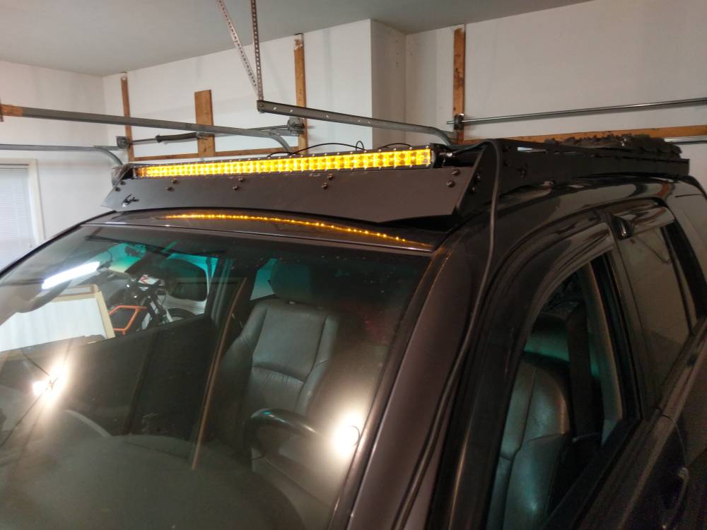

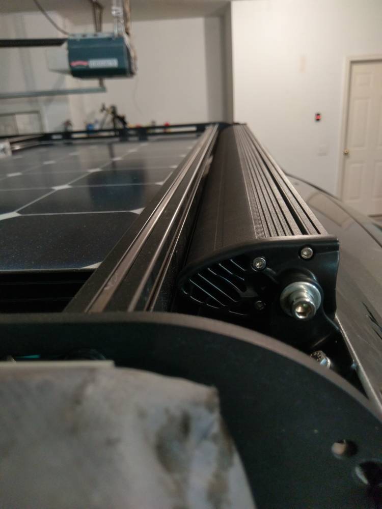

Xprite (cheap) lightbar mounted on the prinsu rack, trimmed wind deflector to get it tucked in as tight and low as possible. I liked the amber backlight feature for some reason, we'll see if it's useful or not.

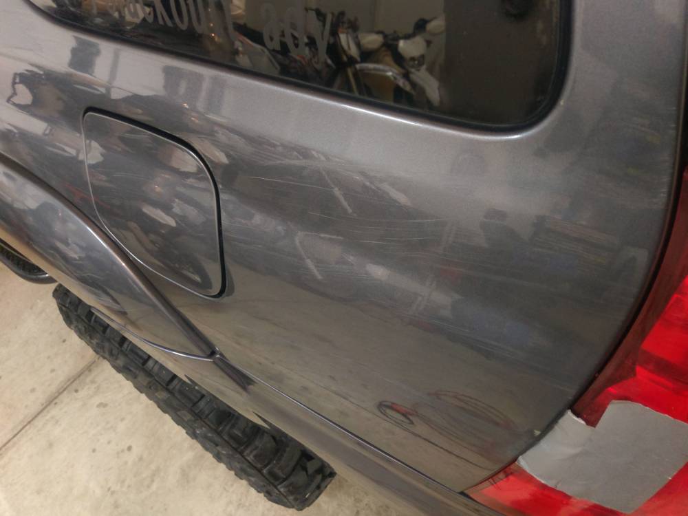

Got some yellow tint to match my ditch lights to my fogs. Also got hit by a 4wheeler on the trail and broke my tail light plus some deep scratches. But another successful weekend playing in eastern KY!

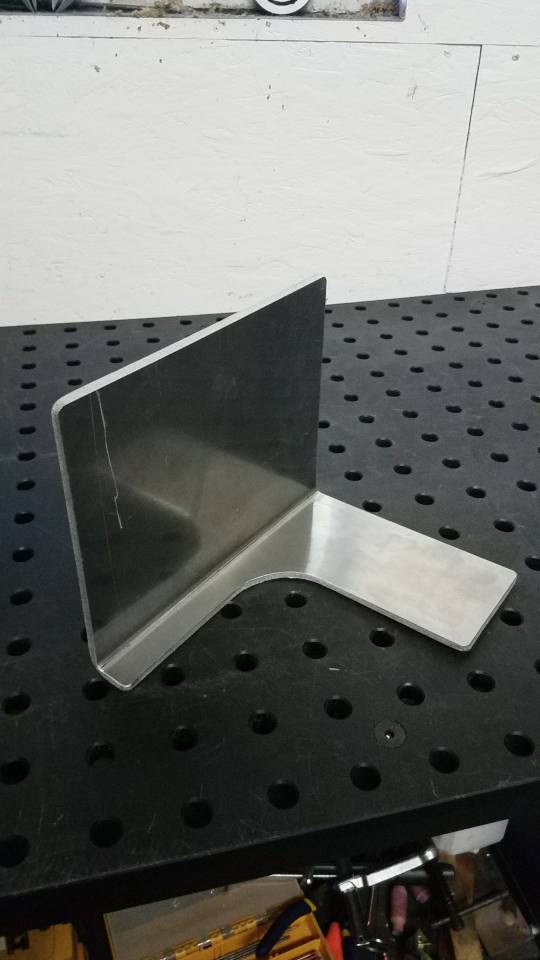

Wanted to also share my custom rear bump stop drop brackets for the rear wheelers superbumps. I love them in the front but realized I was no where near touching the stock bumps or wheelers if I just added their rear kit so I saved a couple bucks and made some. 2"x3" tube fits well in the space, offset the bump about 1/2" rearward to center on the axle. I might need to add some small shims later on to keep tire out of the body work that I dont trim but hopefully this is all the uptravel I need to give up with 10" travel rear shocks.

Great write-up. Have you since added solar? I ask because I have no plans to do dual batteries, but I do plan to add solar to my set up and am looking for ideas.
Yep I'm kind of out of order here but if you look at post #3 you'll see the solar panel mounted up. The solar is wired directly to the aux battery so that it still charges even if the rear fuse circuit breaker is shut off. It also charges the aux battery at a high enough voltage that it opens the isolation relay and charges my starting battery! It's been working well except when I park the 4runner inside (duh!) so I end up just plugging the 4runner into a small trickle charger when parked inside as it's no longer my daily driver. Drove it this morning and both batteries were at 12.8v before start up! You could easily add solar without dual battery and just wire it to a fuse panel to backfeed to your starting battery. Don't forget the large fuses at each end!
