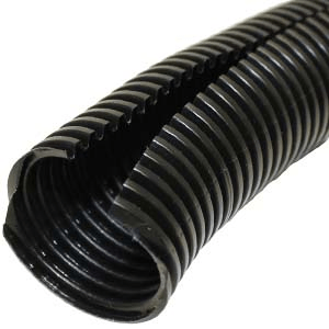

Once the connections are made its a good idea to cover the cables with some form of protection. I used this.
