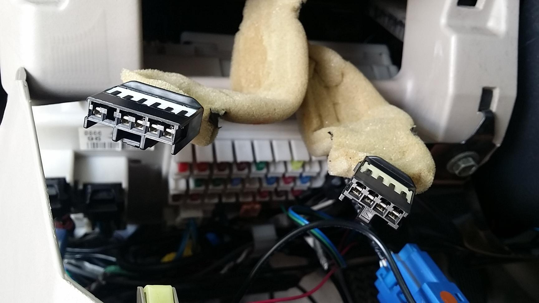

Just wondering if anyone happened to know what these blank harnesses were for, located behind the dash! I have Auto LSD, if that's any help. Thanks in advance!

Those would be for the airbag system so you can turn it off if i remember the vrs, and the other is the differential lock.
Yea I am pretty sure. I cant say 100% without seeing the color of the wires going to the harness but I just recently added the 115v inverter and it looks like the harness that would go to the on/off switch for the inverter.
Don't forget there is 4 other buttons there in some 4runners. where he is showing that picture i have 3 factory button and a blank. Mine all deal with the traction, dif and airbags.
I would assume its safe to say OP the connections are to one of the 3 options me and acronin mentioned. They usually use the same wire harness in all the vehicles even if the option wasn't included
