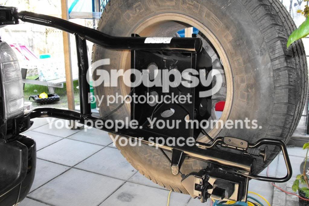

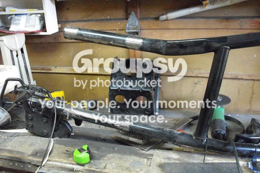

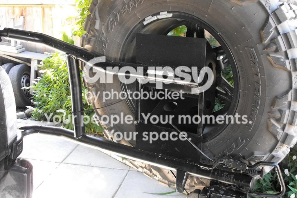

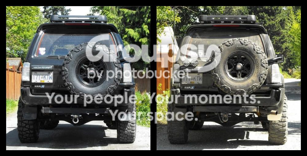

While in the process of welding, I also re-configured the tire carrier and move the spare tire 4" up and 1" to the left. The effect is a much more updated and lifted back end.
Don't know but I can only imagine the departure angle gained by raising the tire to be significant, with the trailer hitch being one limiting factor. Admittedly, the obstruction of the rear view from the drivers seat is more this time, but only to a certain degree..after all it's only 4".
Here's the original tire carrier config
30-2.jpg~original
The raised version
25.jpg~original

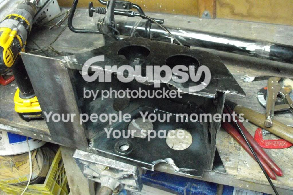

The tire mount off of the tire carrier rack
31.jpg~original
One of two 4" wide riser plates added at the bottom
32.jpg~original
The comparison shot, before pic ( May 28, '11)to the left still showing the un-modified hitch and one BFG tire still mounted. After pic (Sept. 6, '11)is the most recent pic to date, with all the additional gizmos to it........Just sharing!:shrug:
23-1-1.jpg~original

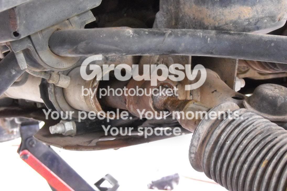

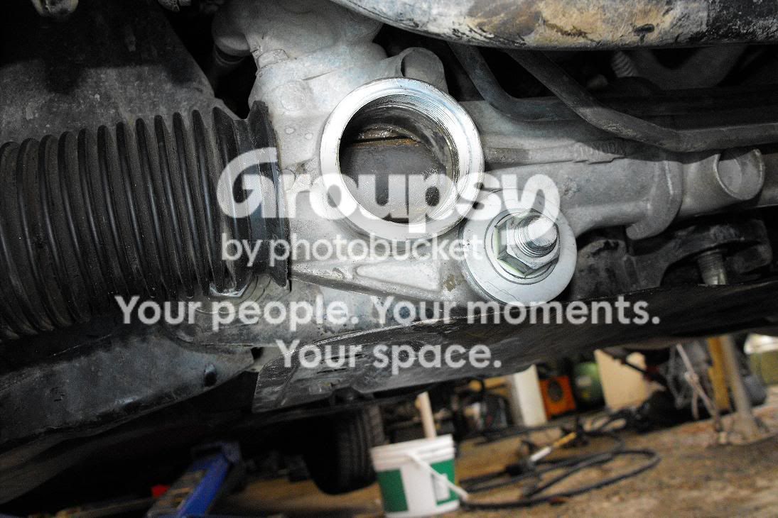

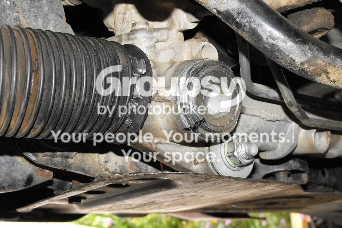

Well I've really been hampered from doing any kind of wheeling activity due to the Inner tie rods that I found needed replacing. I was afraid to add any additional damage wheeling might cause, if I did.

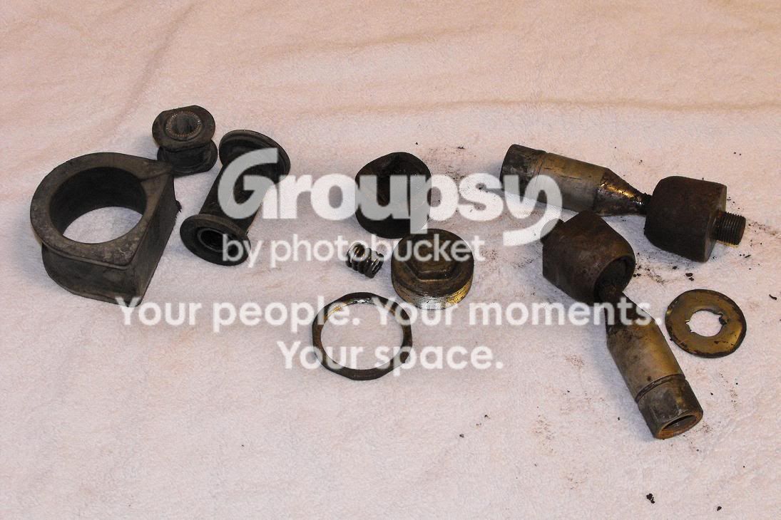

I ended up having to also replace the Rack Guide, guide cap, spring and the nut, which I ordered from Toyota Parts Cheap. I ordered the parts off of a 2001 4Runner. 01-02 models came with the newer style Rack Guide. And while in the process of tryin' to fix the rack, I also ordered some Polyurethane Steering Rack Bushing Kit from Wheeler's Off-Road, Inc.
The tie rods by the way were ordered from Napa boasting a Ltd. Lifetime warranty.;):
The steering rack has no leaks whatsoever so replacing it would've been out of the question.
With the guiding instructions of my mechanic friend and following some of the How-to's and write up's others have already laid for us, tackling the job can actually be straight forward. Sorry no repeat write ups here.
Only pic....Right side Inner tie rod.
1-23.jpg~original

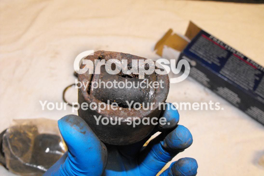

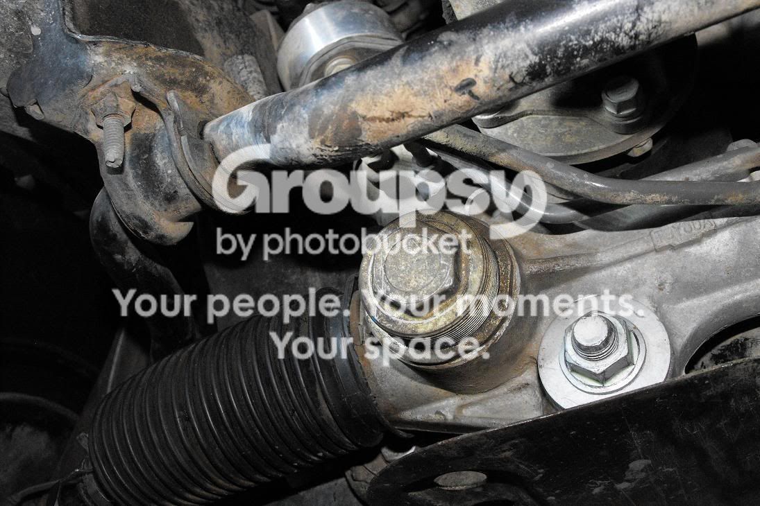

Old Rack guide cap..
2-20.jpg~original
Yummy rack...Ever notice the TOYODA stamp on the rack housing?
3-18.jpg~original
New style guide cap w/ locktite'd cap nut. Also seen is a new replacement ITRE boot clamp from Toyota.
4-18.jpg~original

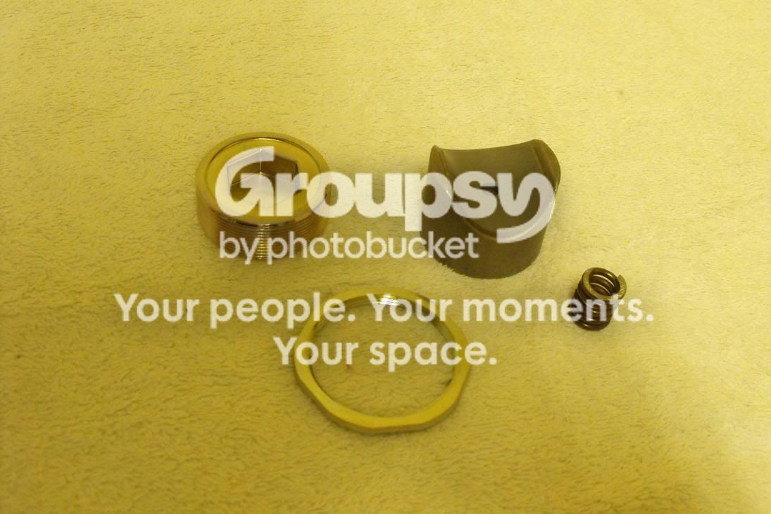

Roller type guide
6-15.jpg~original
01-02 4runner parts
11-8.jpg~original
I took no pictures of the new steering rack bushings but here's what I replaced, along with the old miscellaneous rack guide bits and old ITRE's.
5-16.jpg~original
Minor snags I ran across..
The 19mm bolt in the middle atop the rack housing was a pain to remove at first but it gave eventually. And ofcourse removing the Diff drop was an extra step as well.
Doing the rack guide adjustment can be abit frustrating..atleast for me. I just went by feel according to the steering wheels stiffness and adjust accordingly, while also avoiding slop on the steering rack, seen inside the Inner TRE boot/bellow..That meant adjusting the guide cap, driving, adjust more till i get the right feel on the steering wheel.
ALL fixed!! Now the steering definitely feels more responsive and everything was history..Thanks for all the wonderful write ups and tips that saved me from spending big on a new steering rack.:guitar2:

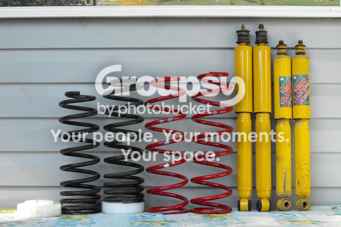

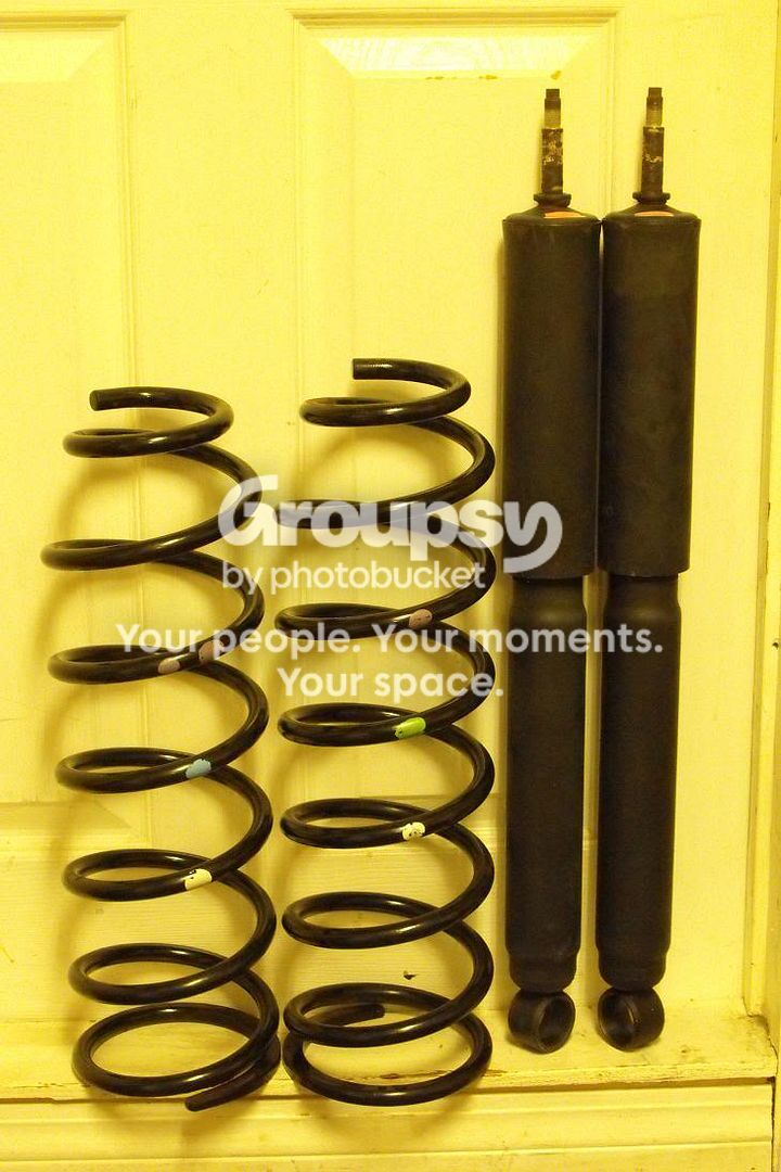

While awaiting for the parts, i snagged a set of 97 LC 8wrap coils and shocks for $50 Cad...now that's not a bad price at all for the set. The LC owner ordered a set of OME kit including 861's for the front. He owns a dual locked, solid front axle monster. I'm hoping to be wheeling with him come next year.
Here's when I got 'em..Double purple-light blue-white(passenger) & purple-green-white(driver).
7-11.jpg~original
I painted them red and since I still have the front OME struts in yellow, I closely matched the shocks the same color.
Height comparison shot with the 890's
8-8.jpg~original
890's with one on top of a 1.5" Cornfed spacer....MY old set up.
9-8.jpg~original

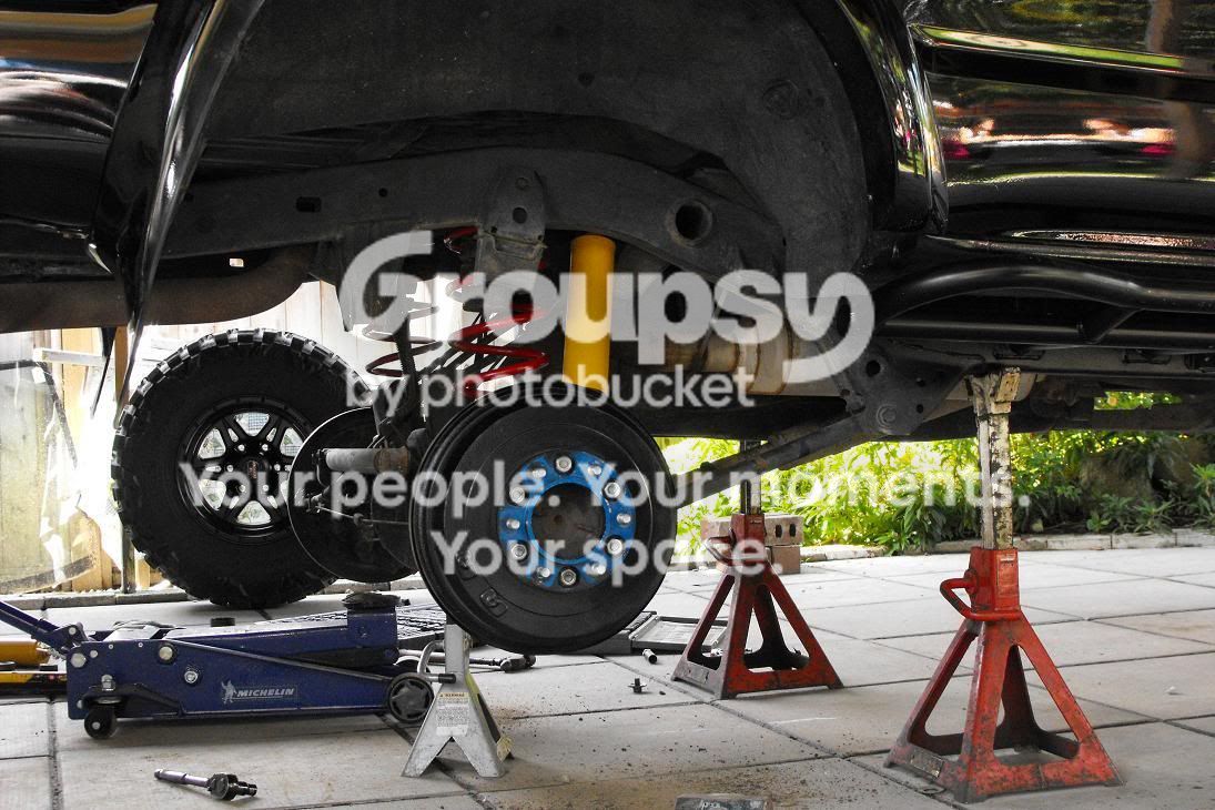

And during the LC set install..boy, do those 6Ton stands help aton? he he!
10-7.jpg~original

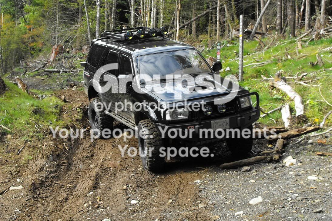

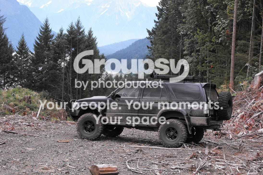

After all was said and done, the LC coils netted 1" taller than my previous set up..Holy! it was too tall, so for the next two days I loaded the rear cargo with 4 stock tires on wheels, 2- 90lb power blocks I use for working out...oh yeah the 2 jack stands too! Gotta settle those springs down from being unloaded.

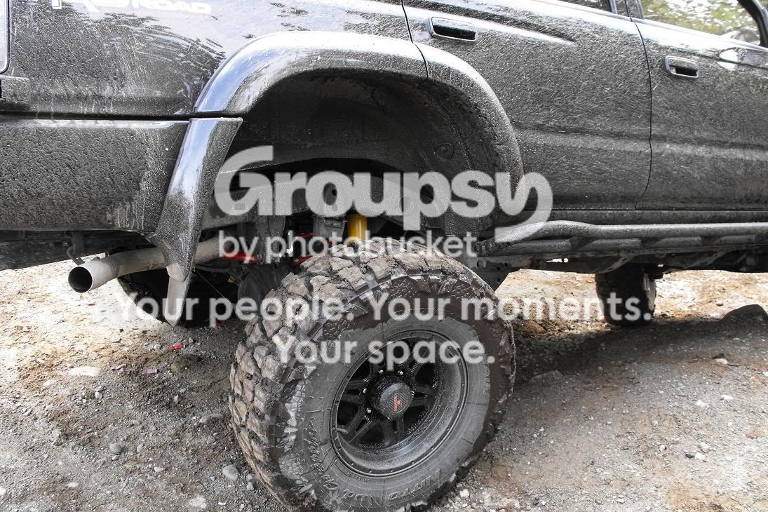

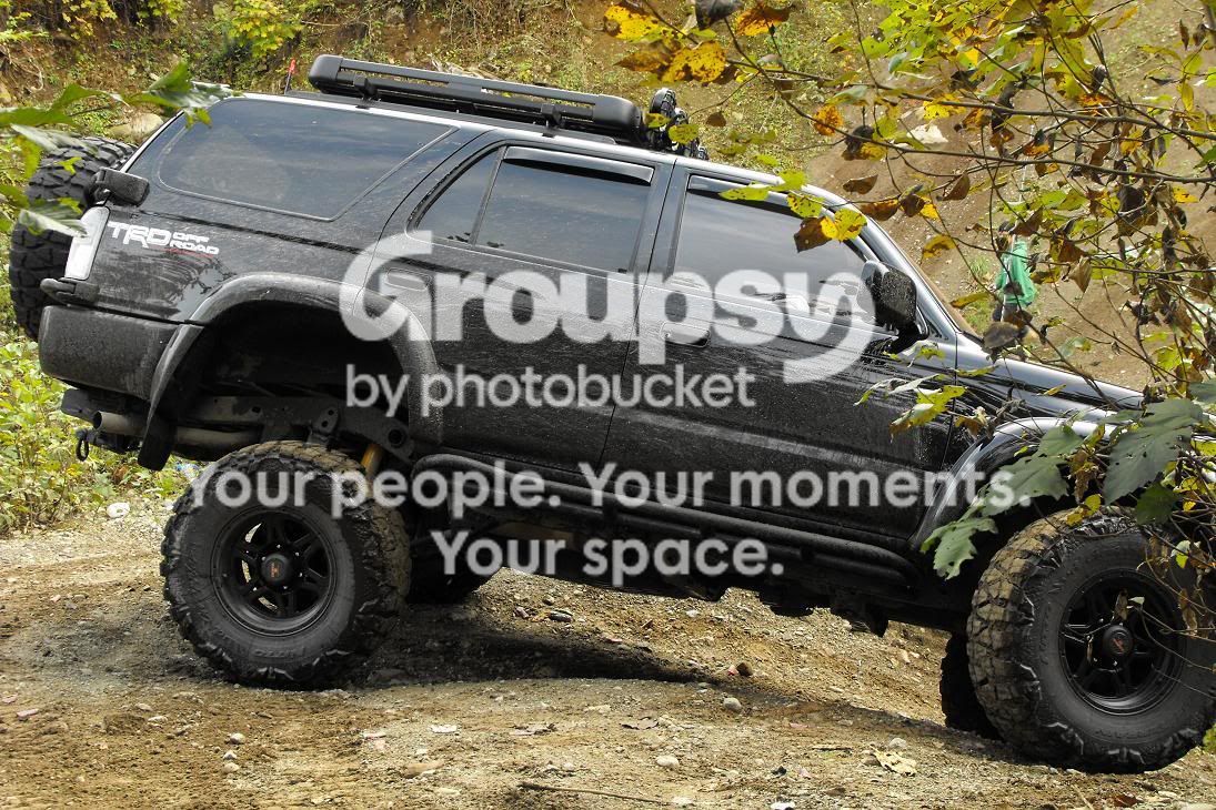

So, my usual wheeling buddy and I went farther east to Chiliwack and found us some nastier than usual logging roads and I tell ya, those coils and shocks didn't disappoint. I felt alot cushioned on long rocky-trail runs....flexes too!
10-8.jpg~original
11-9.jpg~original
9-9.jpg~original

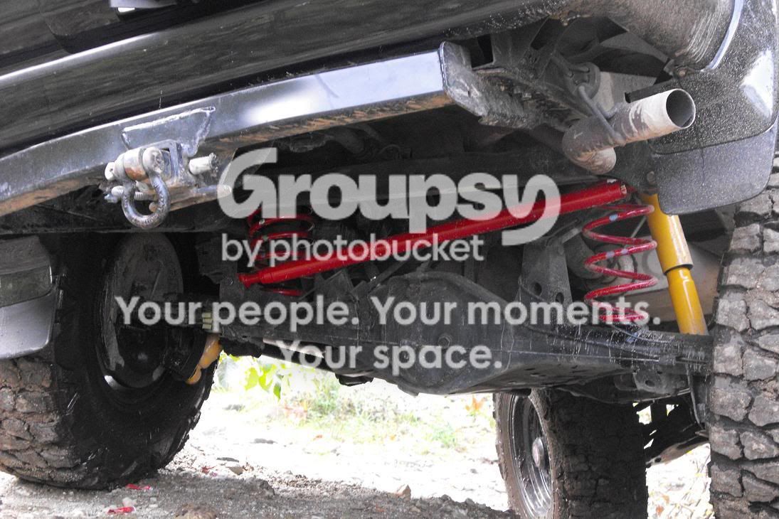

Flexing it...Sure I can do better!
4-19.jpg~original
5-17.jpg~original
Also painted the trac bar red..
2-21.jpg~original
