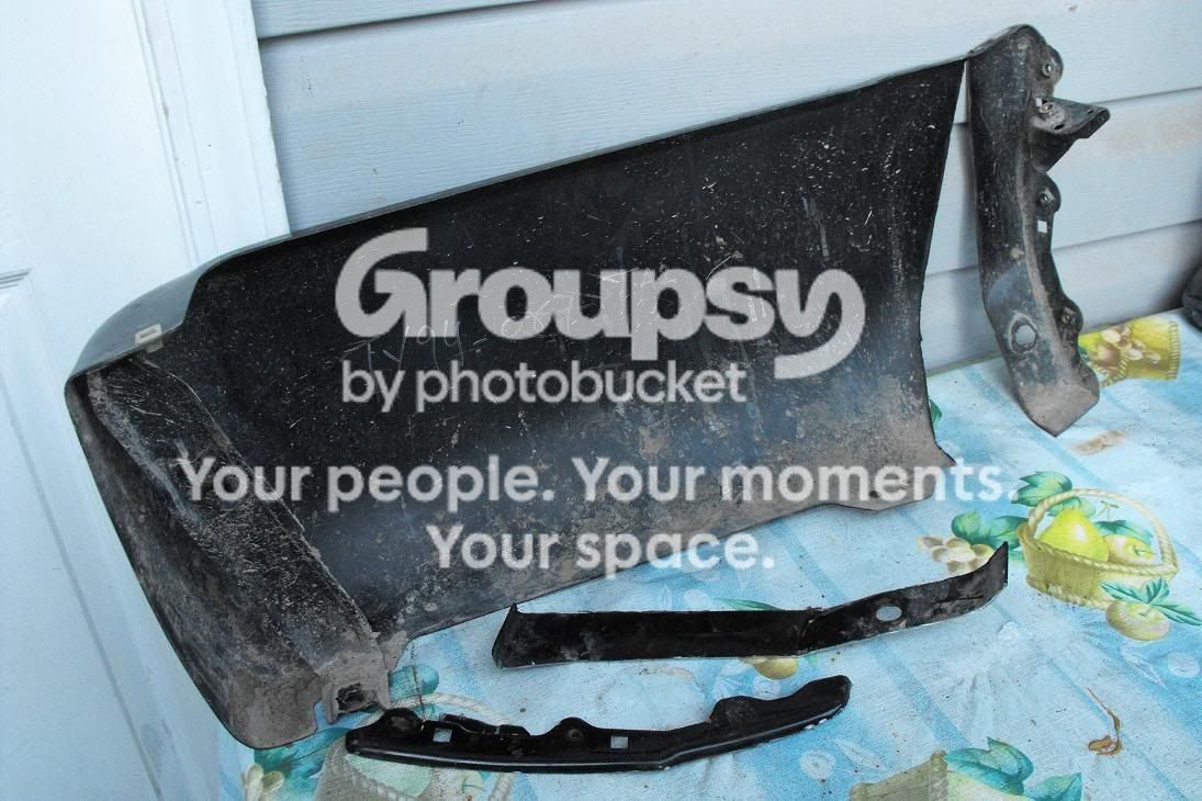

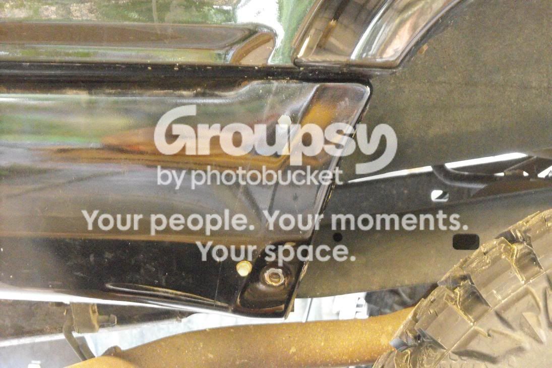

The process of how I did it..

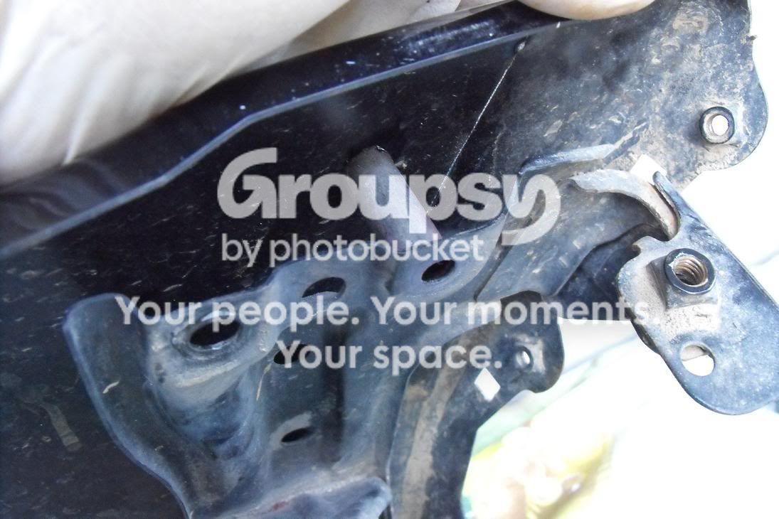

Upper bumper mounting point to be removed
Now since I have mudflaps, all I needed was to re-position the new mounting points for the bumper which will still be hidden under it.

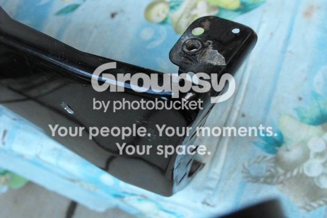

Here's a pic of the two new holes I made to the left of the cut line, see the existing bolt hole to the right?
The new upper bolt is replaced by a longer one and requires a 1 1/4" spacer/sleeve between the actual bumper surface and the bracket, so when the bolt is tightened the bumper will not get crushed. The lower bolt needs a 1/4" spacer/sleeve only, remedied by using a typical nut.

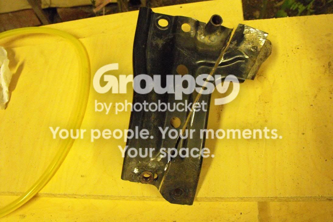

Here's the cut piece of the bumper bracket showing the welded in upper spacer and the lower nut mount. These are the new bolting points for the bumper.
The shorter version bumper showing where the cut was made.

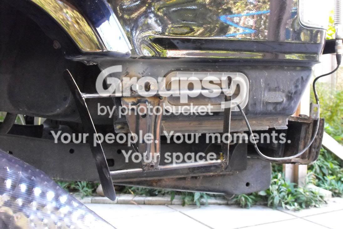

Fast forwarding to the welded capped tubings that acts as the rail guide for the mudflap mounting plate welded to a solid rod. The alignment and distance of the two tubing is paramount so the rod glides in and out of the railings without bind or resistance. Also notice the cut on the seam weld of about an inch for extra clearance. I made series of cuts then folded and re-welded the seam weld.

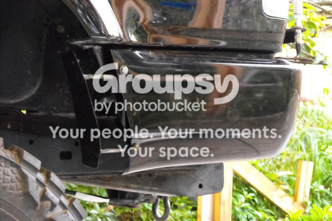

Sorry for the blurry pic, but here shows the bumper mounted covering the rail system. The only thing left is to screw on the mudflap to the plate. Everything was painted with black rust paint, filled the tubings and doused the glide rod with grease.

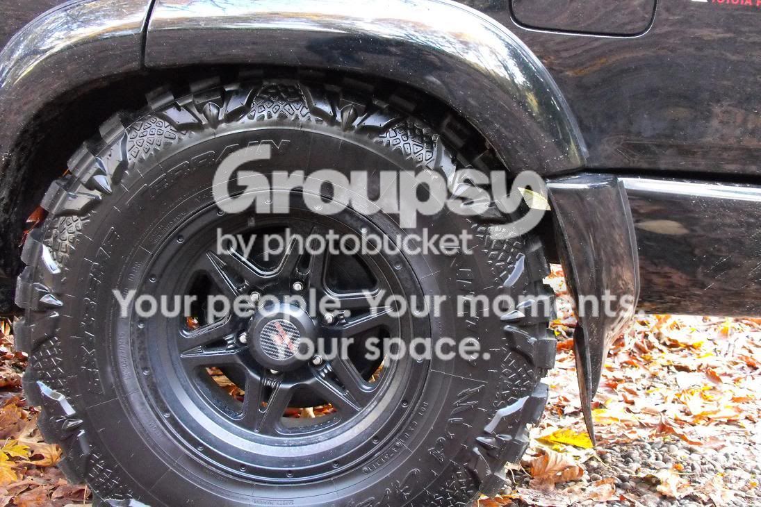

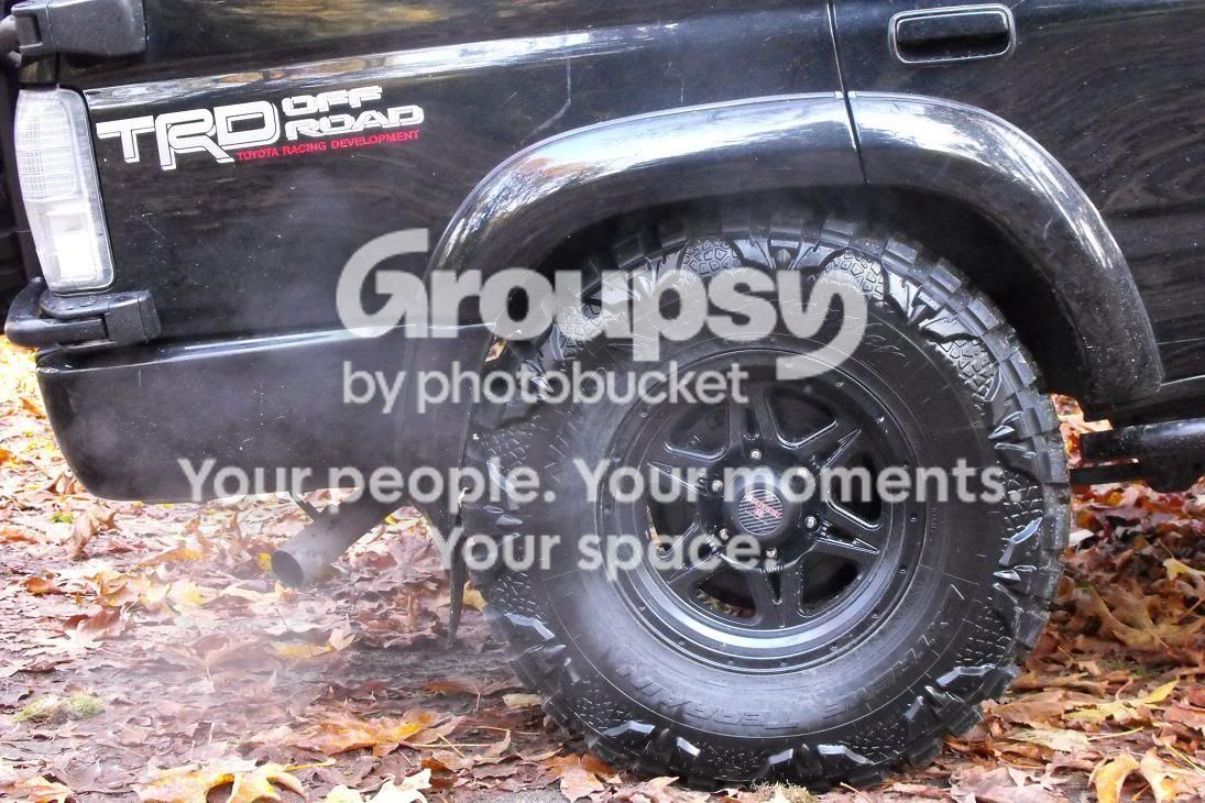

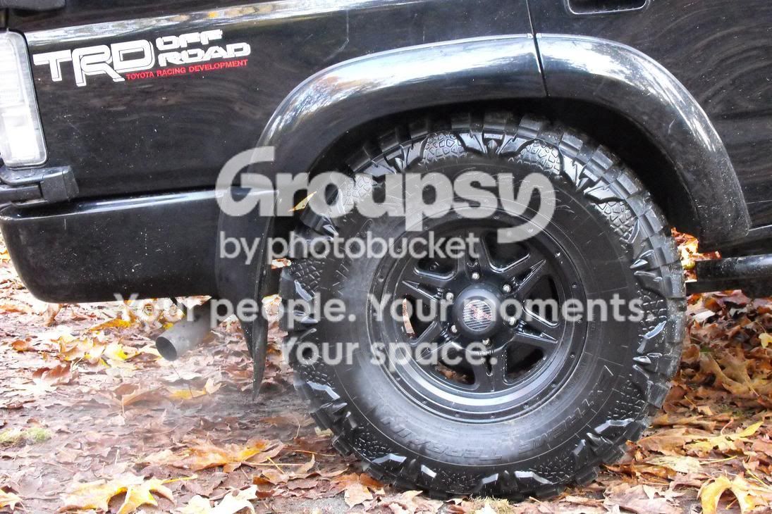

I found a mild embankment and tried out the mod i did. I always cringe at the sound of the tires rubbing hard on the mudflaps....not this time. I've eliminated it with more room to spare. I also noticed that my tires will actually stuff further in on the wheel wells upon inspection.

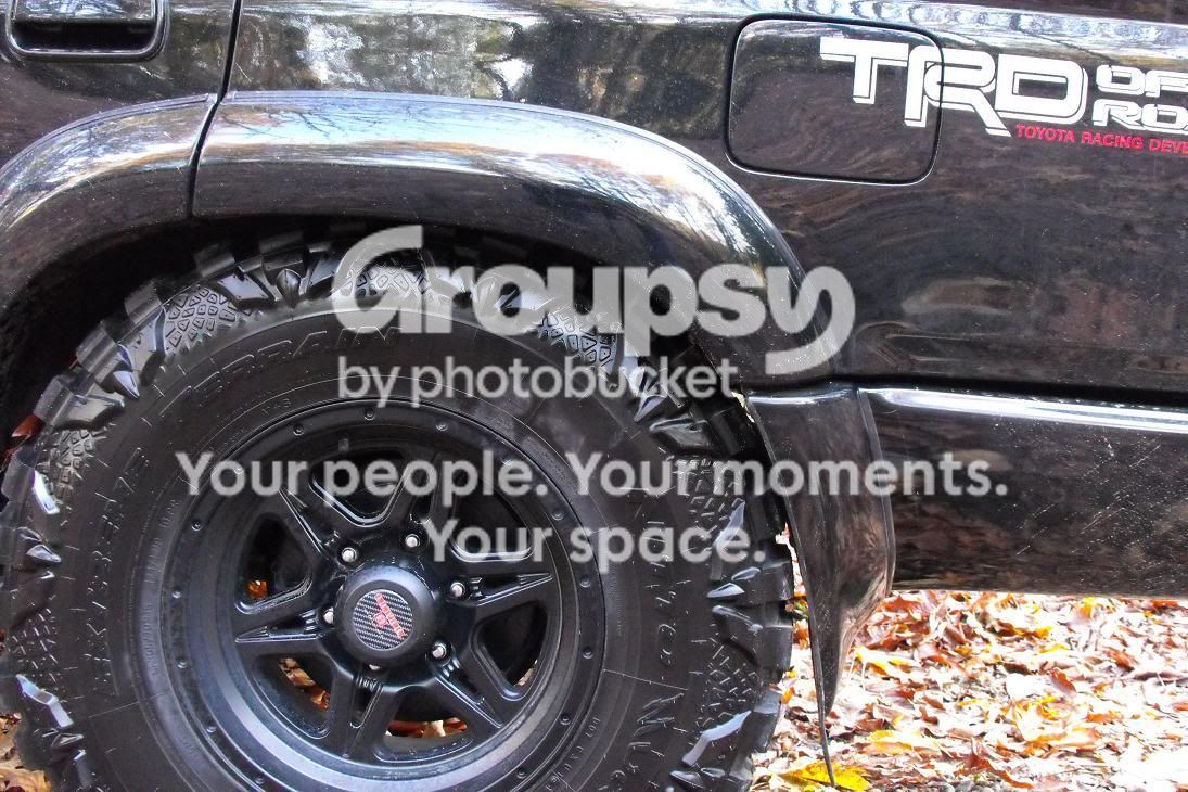

If you can see here, the mudflap was actually about a half inch off from being ligned up with the upper flare. The tire already went past where the mudflap would've already stopped it going further.
Same shot only I moved the mudflap backwards. I've got just another 1" of extra room to play with. Next time when I wheel, I'll push it to it's full potential and see how much further the tires go. But so far....I'm a happy modder!

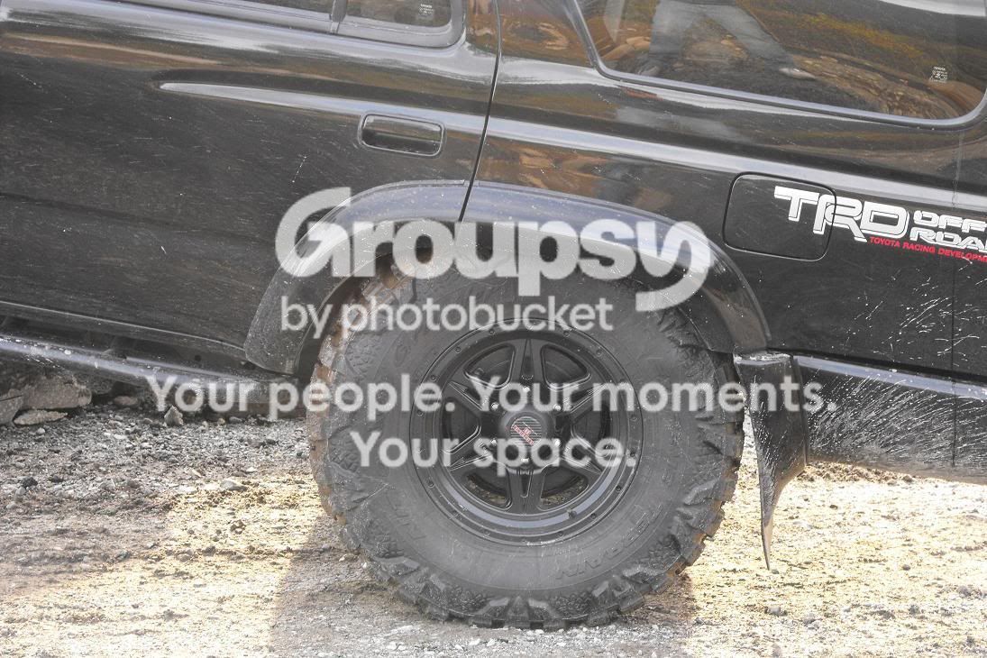

With the mudflap still ligned up with the flare and tire already rubbing.
Same shot...

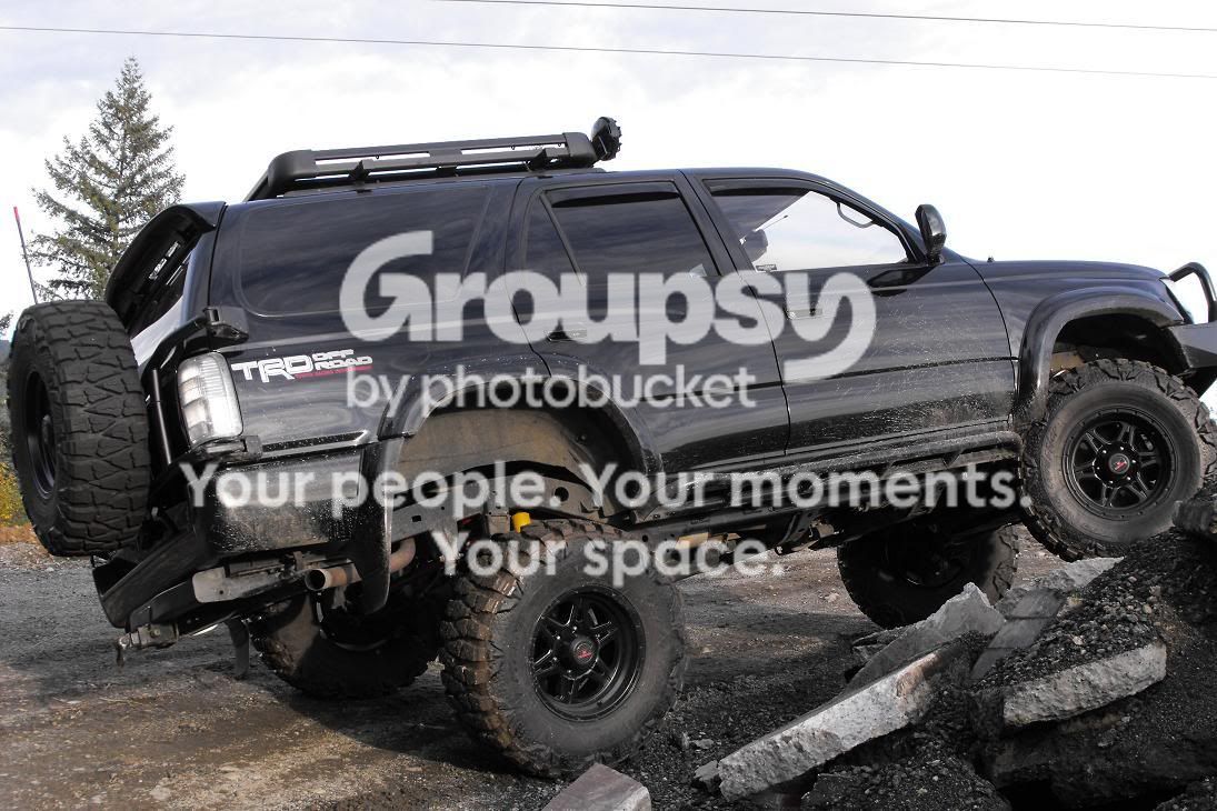

I wanted to get more satisfaction out of my built contraption and the result was just, well....Stuffed!

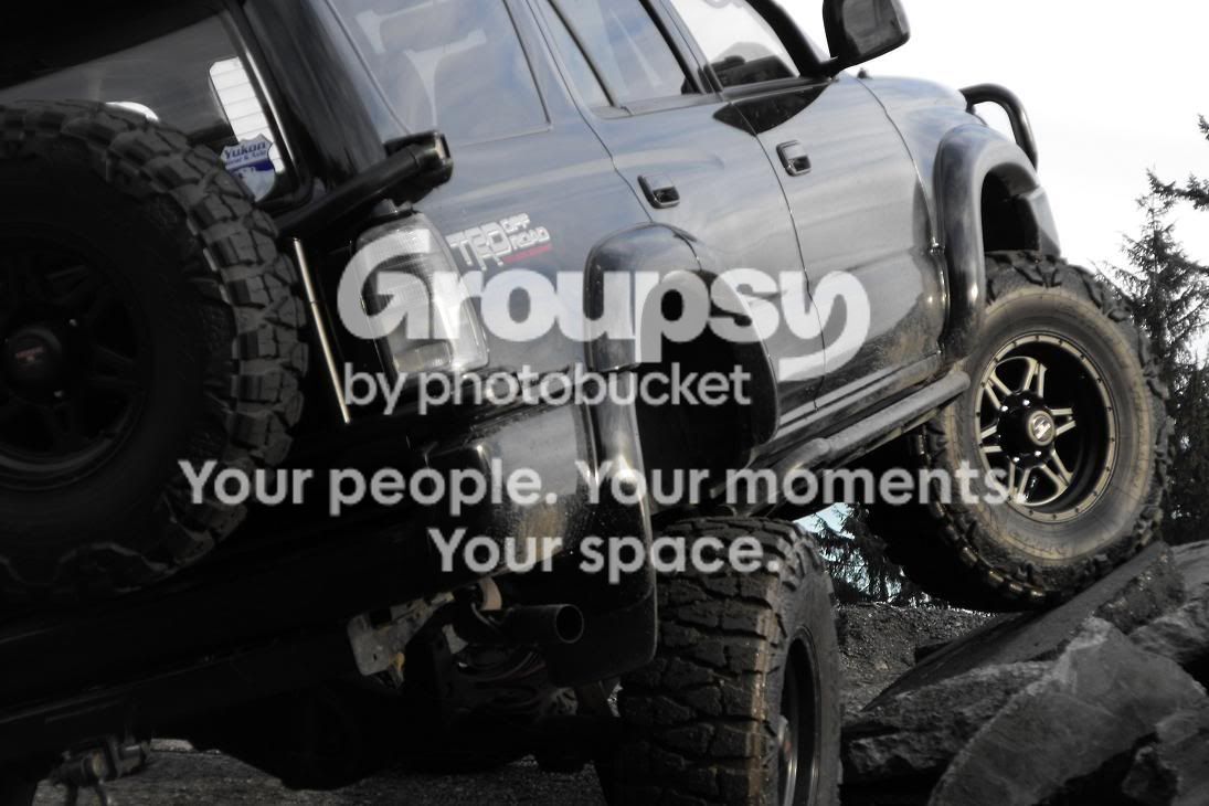

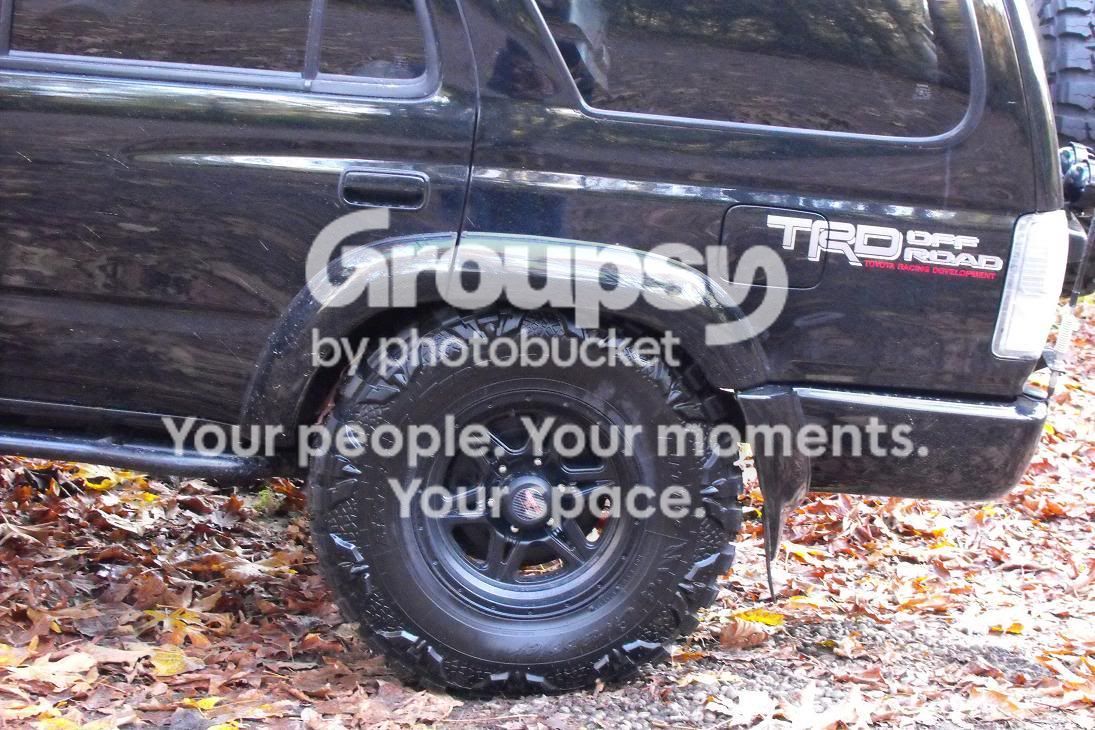

Here are some further test result photos:
I still have room behind the tire at this point.
As huge as an improvement this mod gives my truck off road. For me the ability to revert it to it's original configuration maintaining the stock form is equally just as important.
