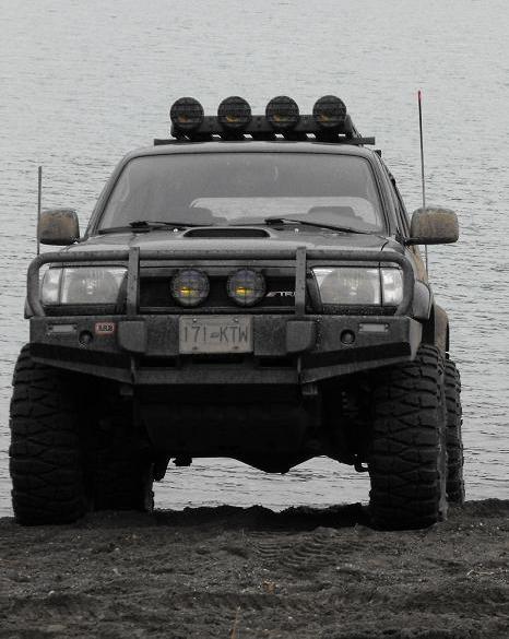

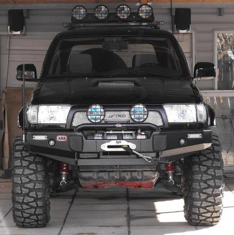

I HAD to see a before/after side by side, so I cropped a couple of your pictures....
That's genius! :trophy: It's not even an ARB anymore man. The only thing ARB about it anymore is the mounts, and you even modded those for the body lift.
Looks like you're getting pretty comfortable with that welder already... if you didn't have the time in this bumper, I'd say sell it and build your own. Who knows what you'd come up with if you started from scratch.
Oh yeah, congrats on the new winch too! I'm curious to see how you fabbed in the mounting plate for it, because I can see you changed that up too.

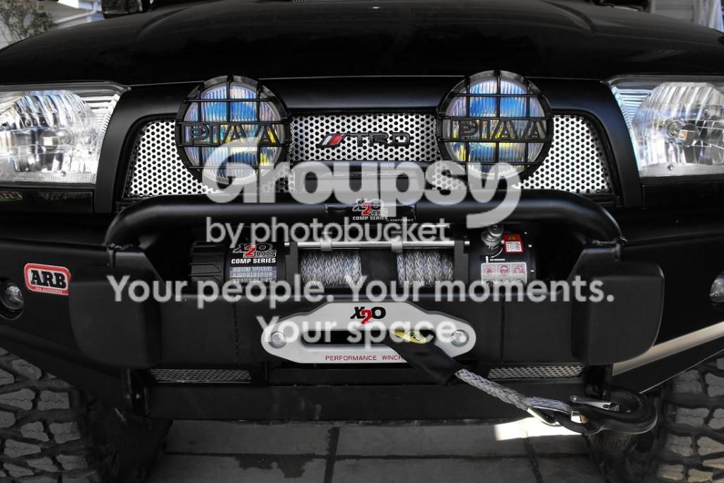

dammit blcktpgsr, now some of keys on my keyboard don't work cause of too much drool, that looks epic!
what year grill did you use for that?
You're missing some tubes. Just thought I'd let you know.
Well unfortunately that's all the tubing we'll ever see on the re-designed bumper,,,no more no less..
Ok, i want an ARB like THAT. That is awesome. Your truck deserved better than a stock ARB anyway. :)
Maybe I'll try and submit this prototype design to ARB and hope they will consider it an update.:lol:

I guess without the ARB badge, people will actually think of it as something else if they didn't know I had ARB to begin with.

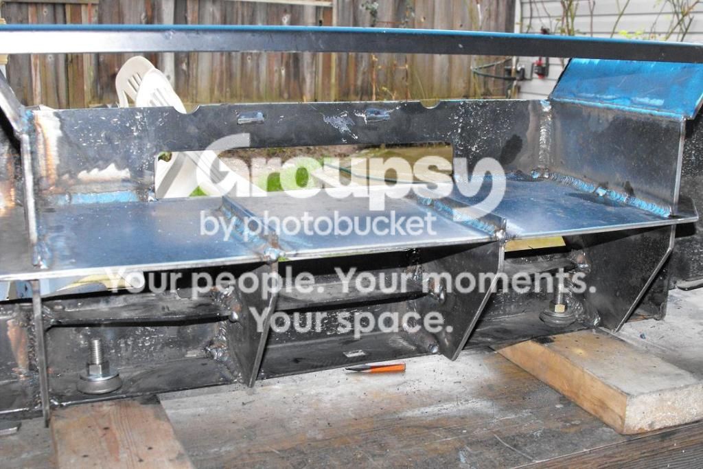

Thanks. The base plate is made up of 3/16" sheet reinforced with 4 vertical slats welded together and all around the bumper....just to think I over did things. Check Photobucket for the photos shortly!

The grill is made of rigid aluminum I got from Metal Supermarket for $12 and it measures 4' x 1'.

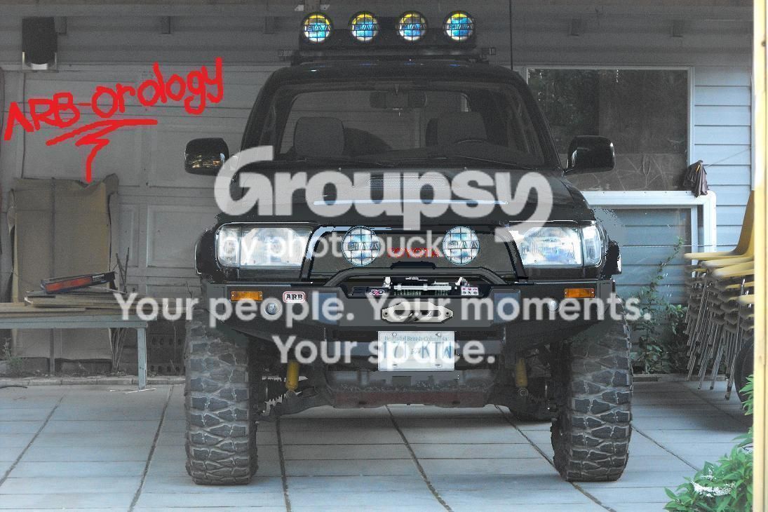

I have been looking at what I could do to revise the look of the ABR bumper and since I also wanted to incorporate a winch to it, I started doing some designs with my truck in the Paint program.
The new look of the ARB is actually inspired by Armorology. I liked how they showcase the winch and the overall shape of the bumper itself.
This is what I came up with in Paint 12 days ago...I call this ARB-orology bumper:lol:

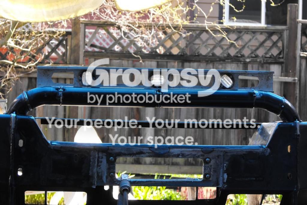

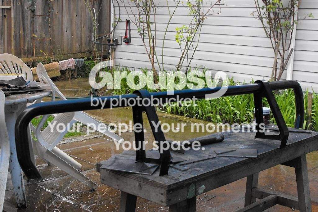

Here's a few pictures along that build
No part of ARB went to waste..re- the top bar and headlight hoops were re-used for the PIAA's new light bar. Instead of renting a tube bender I elected to chop up portions and welded them together.....A total of 6 pieces were used.

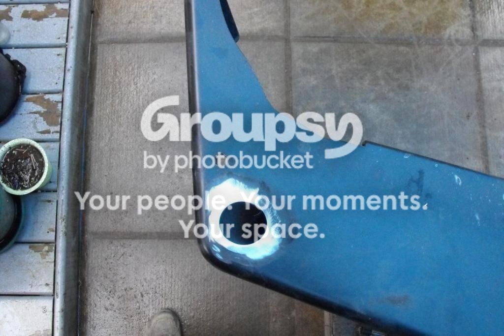

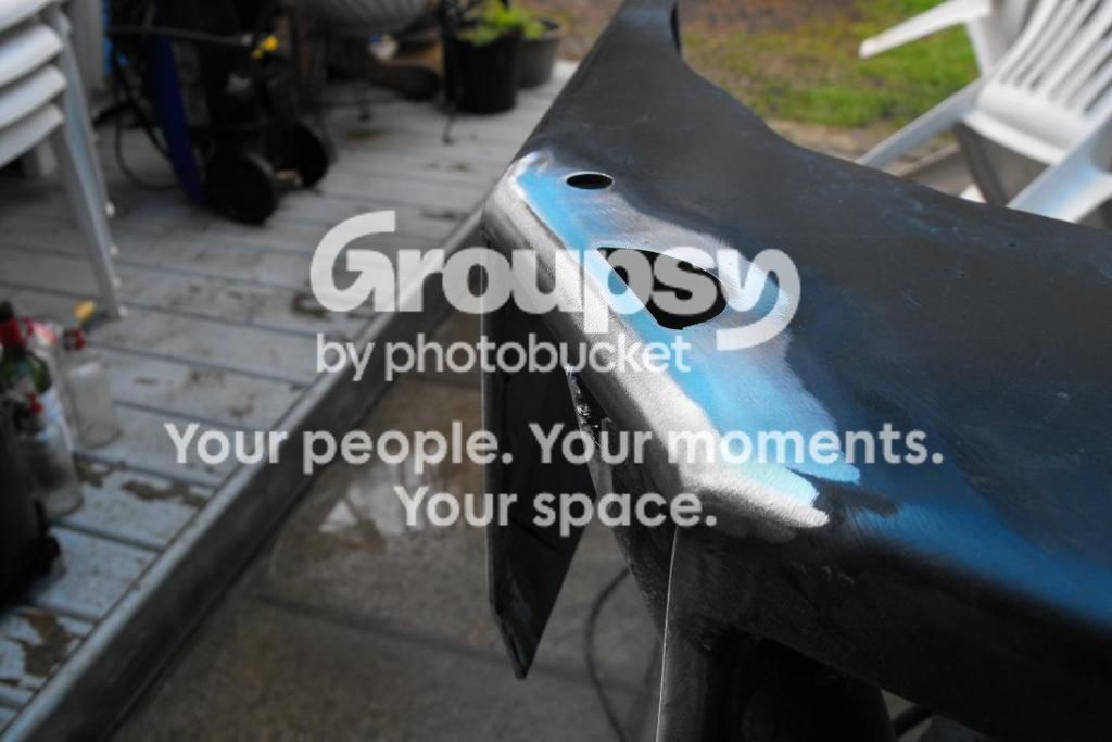

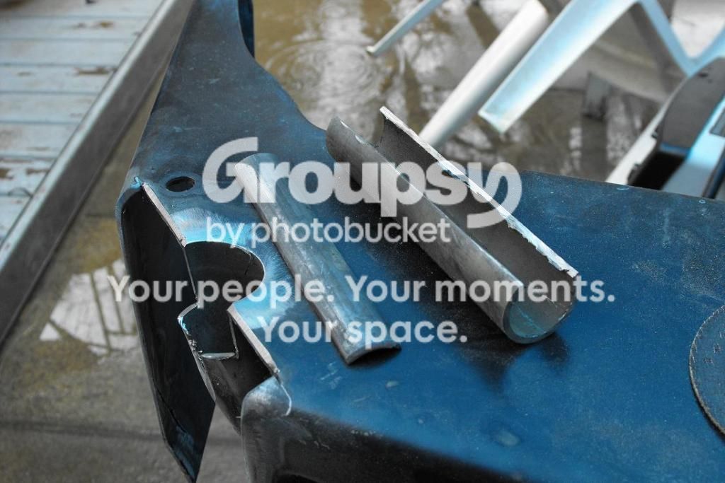

Here are photos of the trimmed squared bumper corner to give it abit of a rounded slimmer look.
10-2.jpg~original
11-2.jpg~original
To replicate the rounded edges, I used a 1 1/4" OD tubing.
13.jpg~original
15.jpg~original

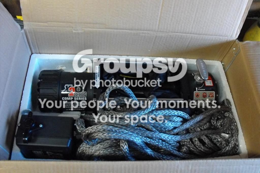

For the winch base...I utilized some 3/16" plate with 4 vertical slats welded alltogether and around the ARB bumper itself. Where the feet of the winch sits, I slapped another 3/16" under the base plate to give it more rigidity....Also better piece of mind. And some plate gussets were later added under the plates. The fairlead plate mount was doubled and re-inforced.
44-2.jpg~original
Smittybilt X20....How could I hide such elegant beauty?
71.jpg~original

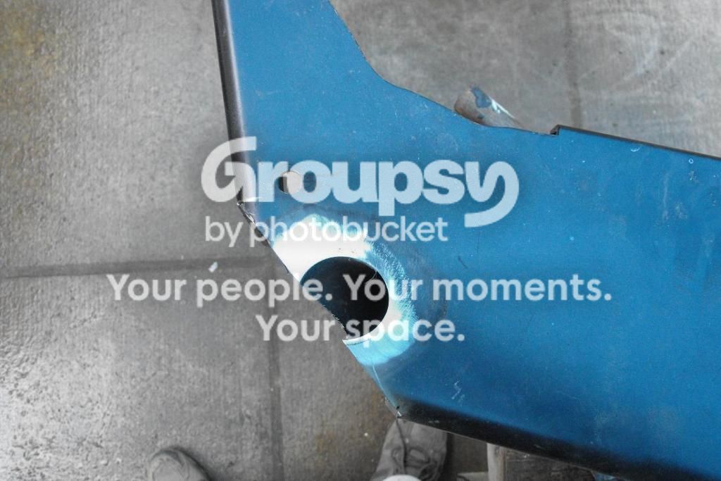

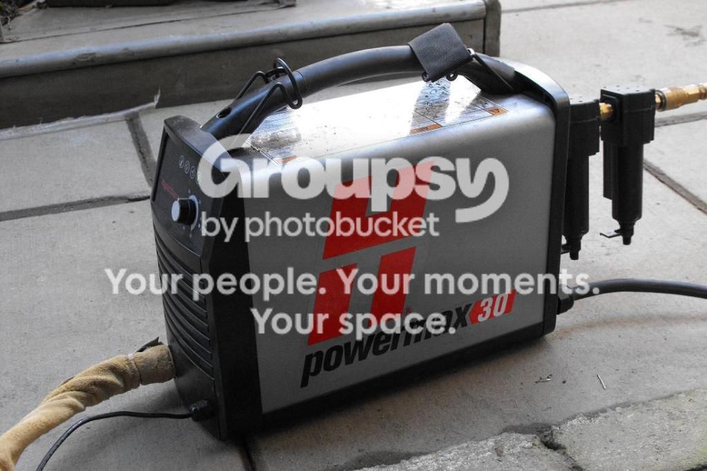

When I first did the ARB, I stupidly used some 1/8" angle iron for the frame end caps, simply because that was what's readily available..I know!..Now I doubled it up and replaced them with a 1/4". I had to borrow my friends plasma cutter to get access to the old end caps and boy, did that make things a whole alot easier. Talking about using the right tools for the job.
4-1.jpg~original

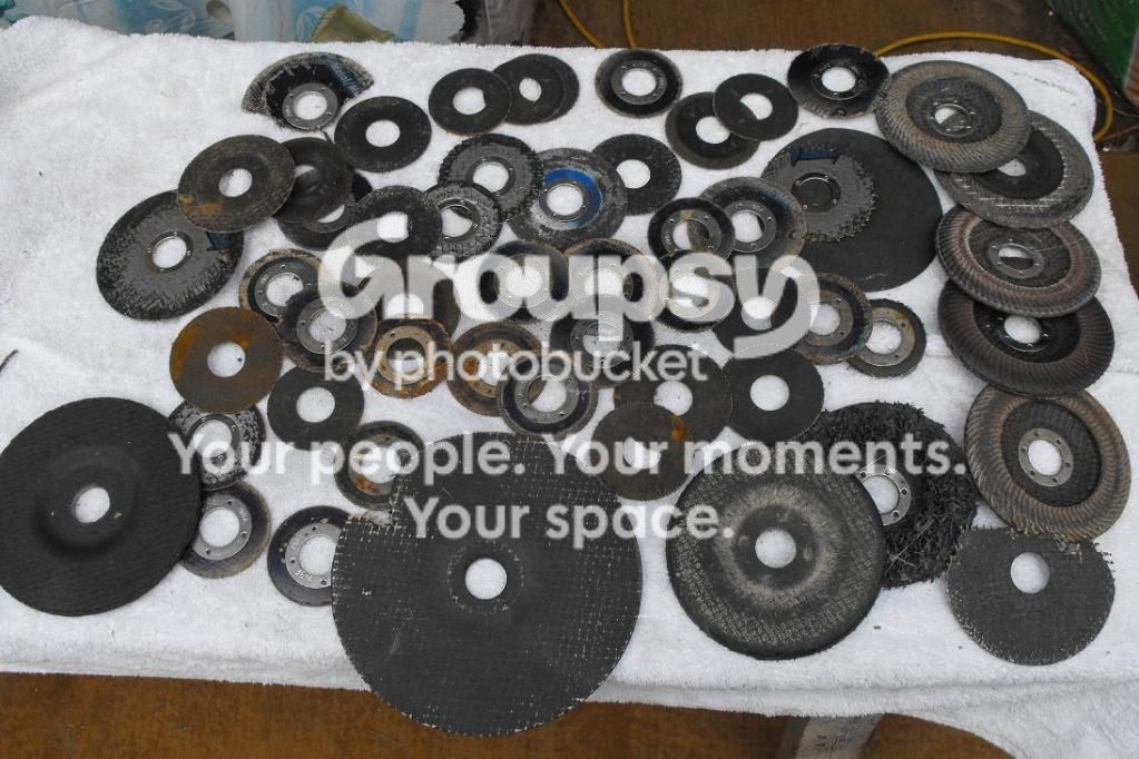

.....And have you ever seen a pile of cutting and grinding discs this much lately?
97.jpg~original
