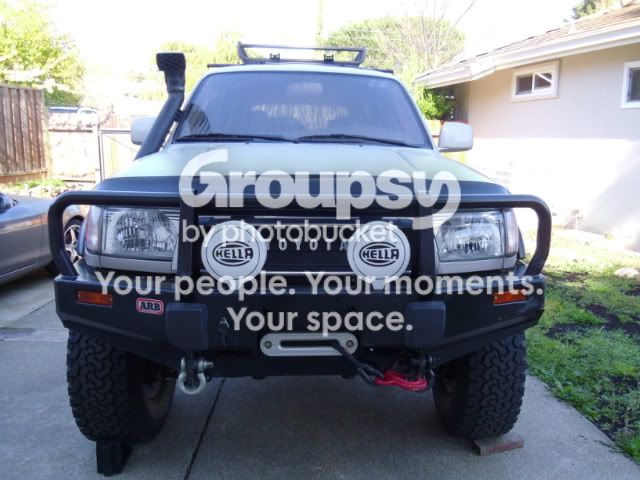

New bumper mod
Holy cow blcktpgsr, I'm late to the party. Just seeing your shots of the modded ARB, that looks totally awesome.

Hey t4r4life, grab your welding kit and come over. I'll buy the cutting/grinding wheels and beers.

Oh that's quite fine, better late than never, lol! Yeah Eric can handle somethin like this no problem..maybe tell him to make 2 so I don't have to do it for my brother.:bravo:

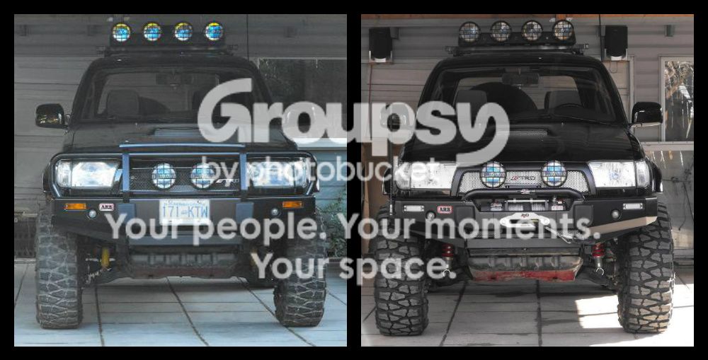

BFAD did a comparison shot in the previous page, and here's another.
