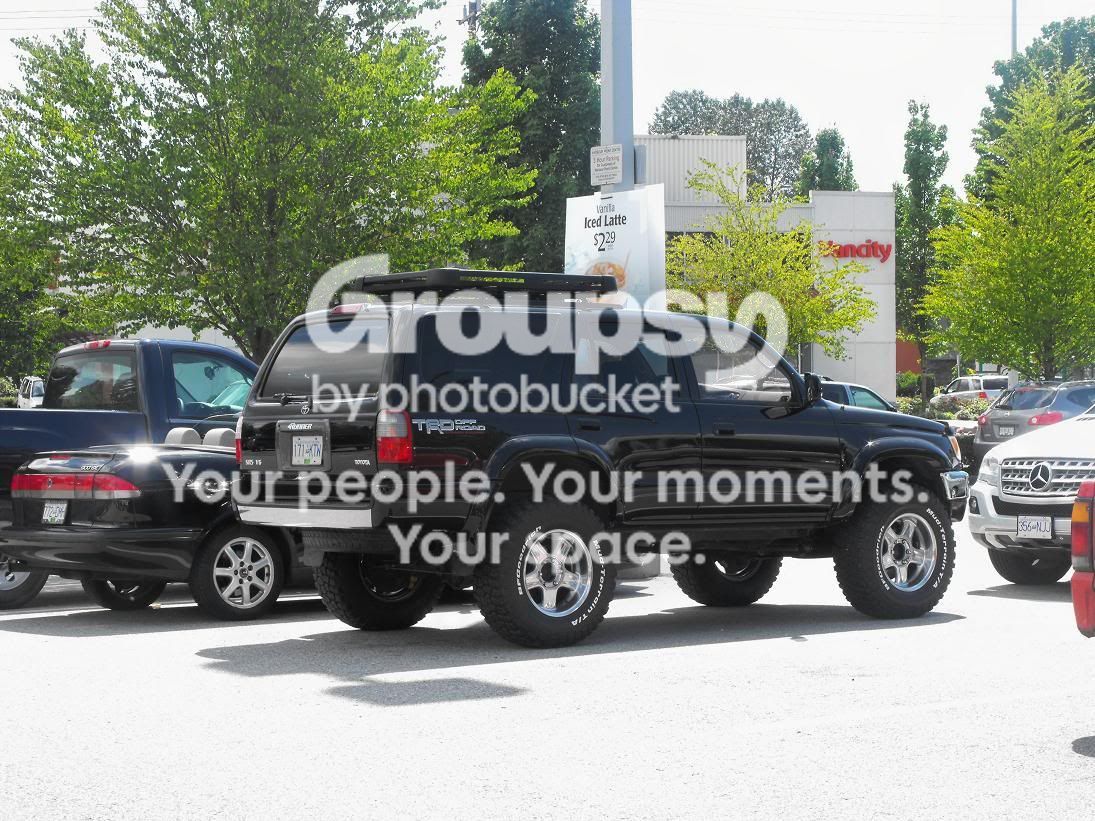

Very nice truck!

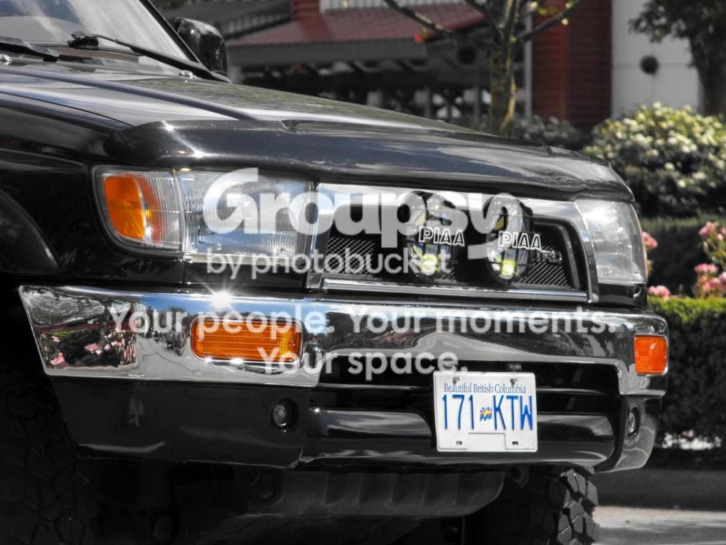

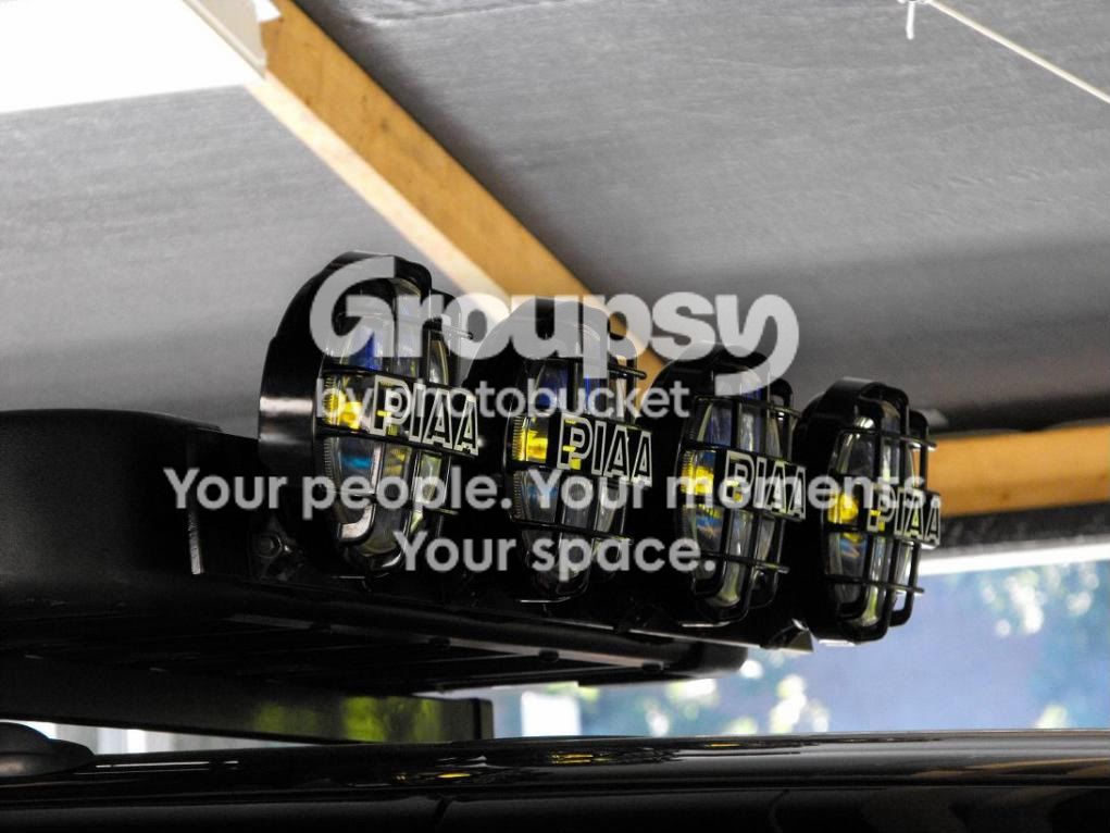

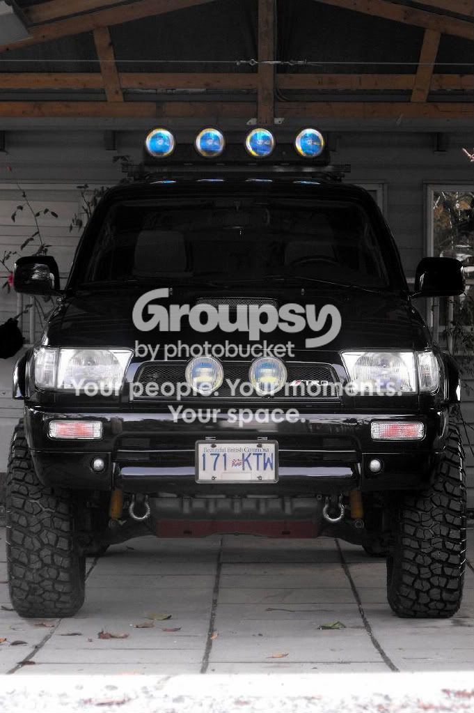

How do you like those Piaa's? Are those the ion crystal yellow?
I'm looking at getting some of those for myself
I noticed you're in vancity too :hello:
Ones on the front are Ion crystal fogs
On the roof are Ion crystal driving....i love them.

Have you had any problems with the popo because of the lights being on the roof or that they're yellow? Do the lights produce a yellow beam or is it deep yellow almost amber?
I'm hoping to get my lights done by sometime this weekend
Ok guess i'll be fine with two sets of lights at the most then.
Yup you'll be fine running two sets. It shouldn't be enough concern to upgrade an alternator. As for the roof mounted lights I haven't had any issues with the cops, not even at the time when I parked next to a bunch of them having coffee at Tim Hortons.
I avoid using them as much while on the road and while they produce yellow beam, they are super bright and can still blind oncoming traffic and vehicles ahead. Own with caution!:lookout::police::jk:

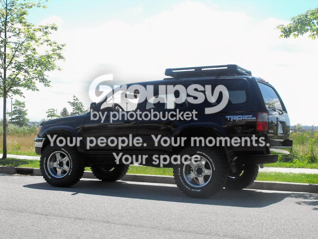

The truck wouldn't be complete without the tires so after much debate I opted with BFG M/T km2 285 70 17's
Mounted on the rims and on the rig
moremudterrains2.jpg~original
moremudterrains5.jpg~original
moremudterrains10.jpg~original

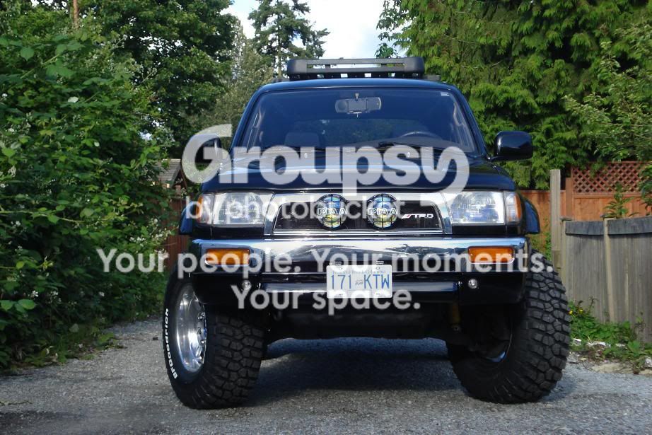

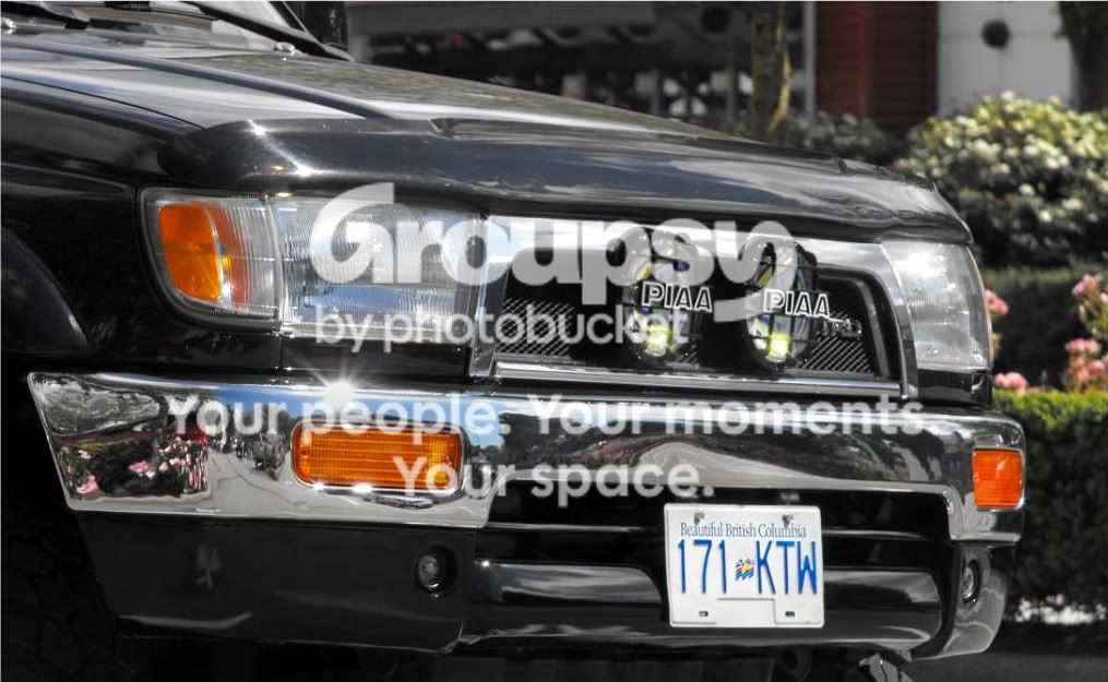

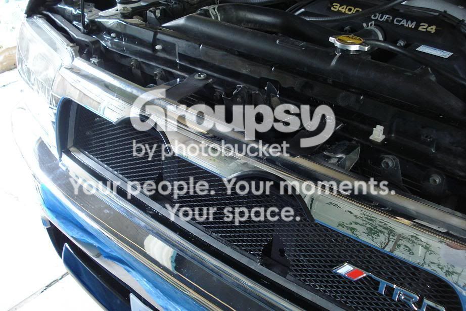

I have a set of PIAA 520's sitting in the closet(another freebie from my brother) ones that I've always wanted to mount on my bumper but having the 01-02 grill presented a set back as it sticks further out compared to my stock 97 ones, let alone the fact that 97's have short bumper...there was nowhere to mount the lights onto..So I resorted back to using the original 97 grill..While I'm at it I thought of doin' the Satoshi mod thinking It'll give me more room so the lights don't stick out...so I did...
I went the extra mile and modify my chrome grill to better flush fit the lights, fab up a bracket in front of the rad to hold the lights secure.
foglightstryout2.jpg~original
foglights6.jpg~original
trd_16.jpg~original
foglights3.jpg~original

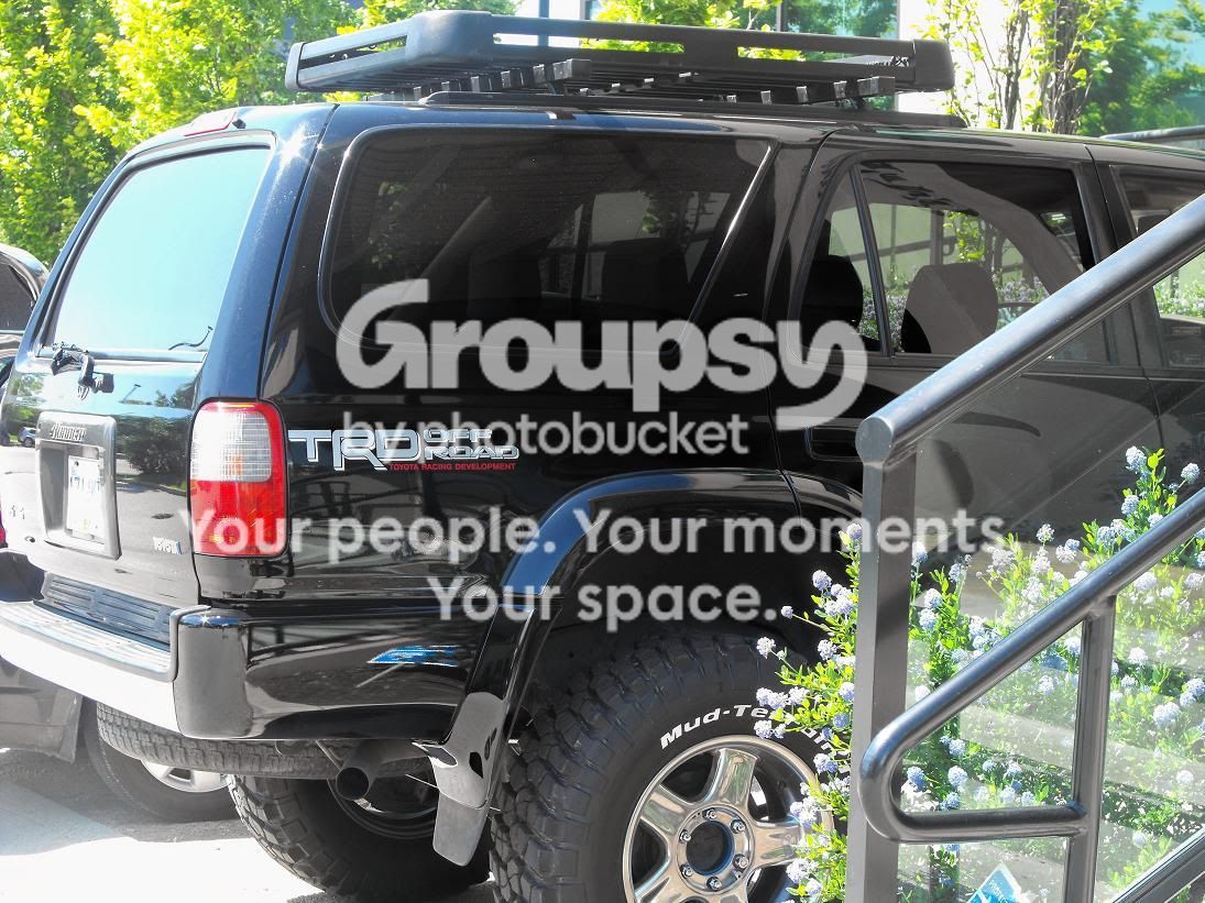

Any chance you've ever figured out what brand/model that roof rack is?
Closest in comparison I could think of is Jaos, difference being that mine has a more lower profile appearance. There's nothing branded or stuck on any of the surface, so i see no way of finding out.
My brother's had it since 99 and he did say that it used to be silver in color just like Jaos' rack and some of it is still showing on the underside.:shrug:

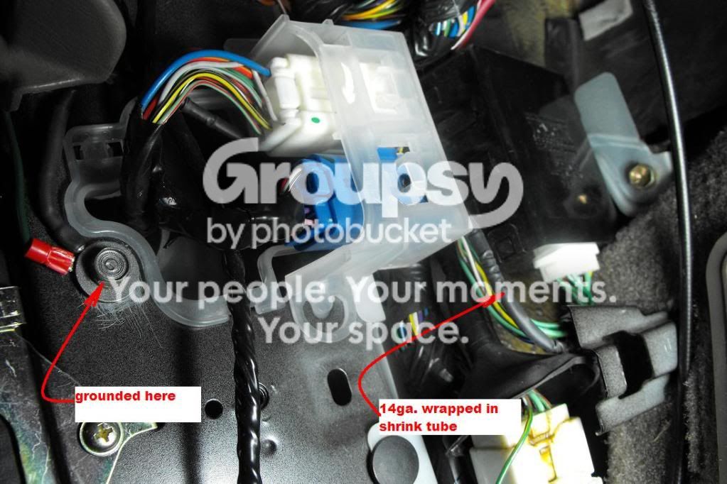

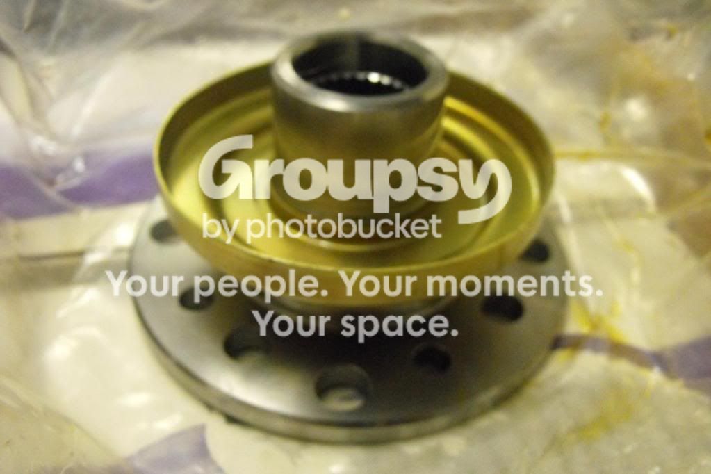

So after tinkering about doing this simple mod for a long time, I finally went and did it this weekend....It's the Blue Wire mod that enables the use of the factory electronic locking differential in 2WD and 4Hi aside from the usual 4Lo. Tried it and it worked just as explained it would. Another one crossed off my to-do list:banana:
12-2.jpg~original
13-1.jpg~original

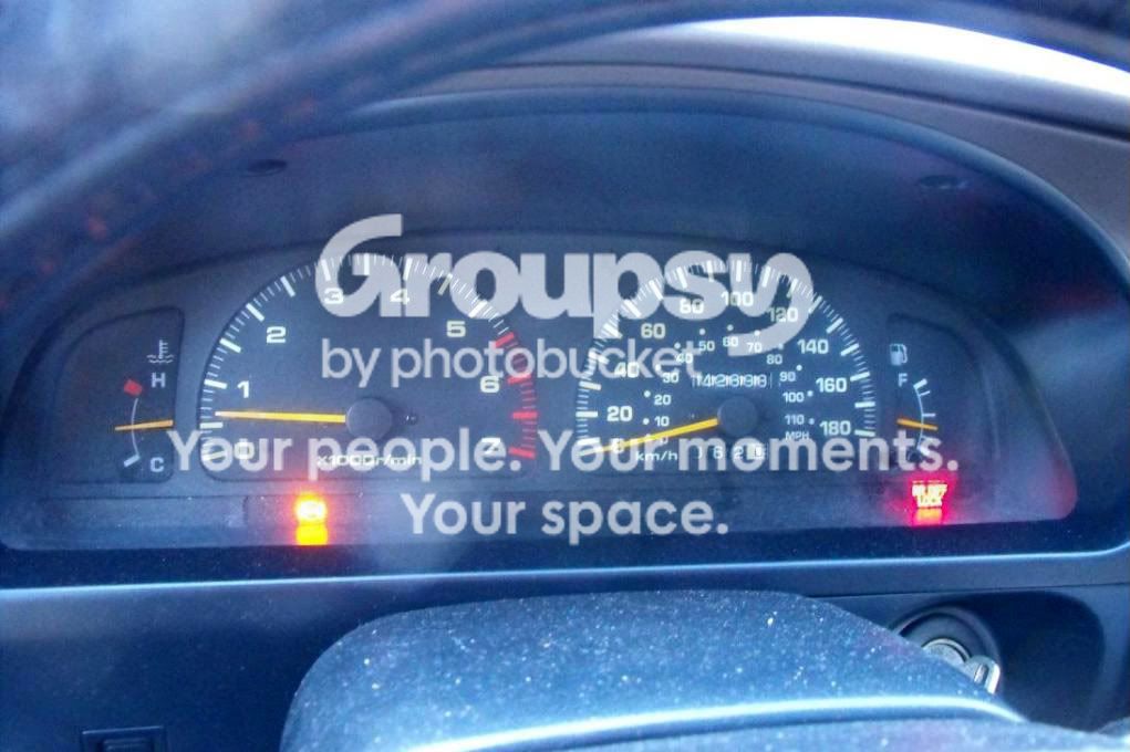

ABS disable in normal driving

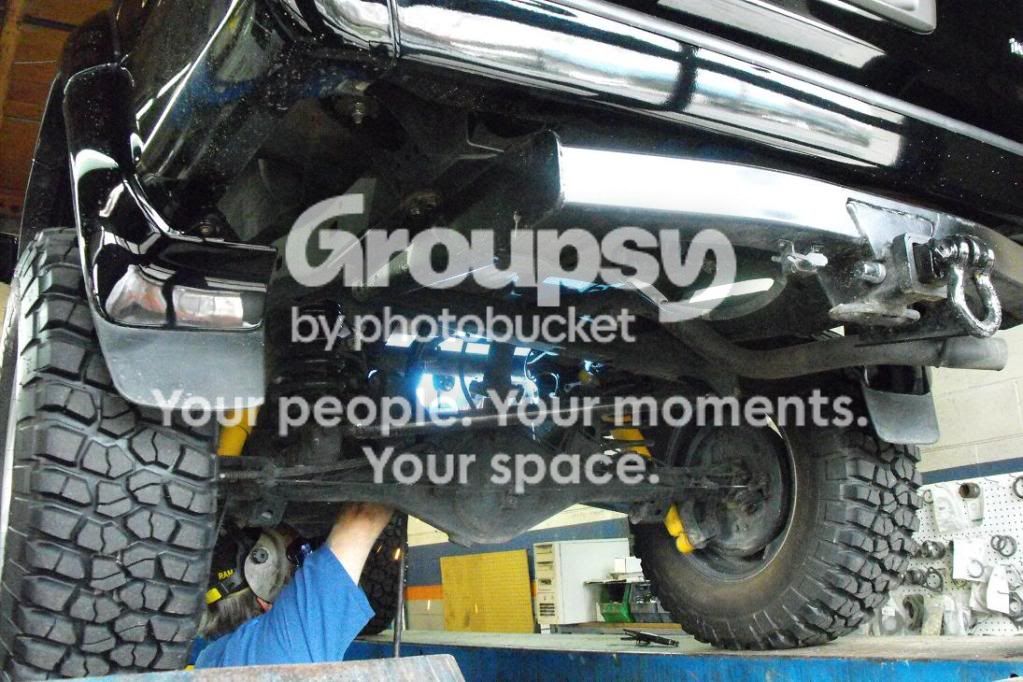

Also went to the shop and had them install my Flowmaster 50 series SUV..It produces a low growling sound that I'm looking for so I couldn't be happier with the choice. Now I listen more to it than the contents of my ipod.:guitar2:

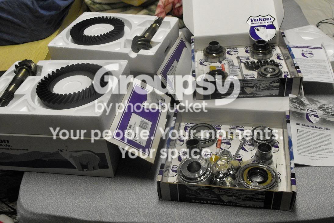

Now I might not be able to have these installed 'til after winter or 'til I can save enough for install cost but it's good to have them waiting in the wings..
I scored it from a guy in town who originally wanted to install it in his locked 98 Tacoma, now his growing family forced him sell it and get a dual cab Taco that would remain stock, so it was time for these to go as well.
3-7.jpg~original
2-10.jpg~original
4-4.jpg~original

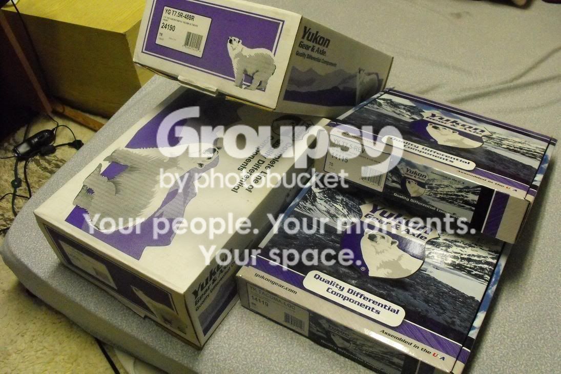

4.88 R&P plus Master Overhaul Kits in it's original packaging from Randy's Ring & Pinion in Everett, Wa.
The kit according to the part numbers were confirmed 100% to go into my 97 by a guy who works there, and the help of Mauzer, quicksilvr and brian2sun helped securing my decision to purchase it. For $500 CA. it's a win!
