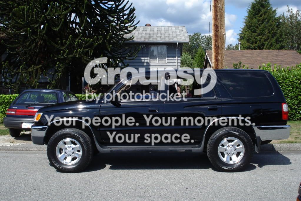

Recently I was showing someone an early post from your build thread and noticed the Runner when you first got it. Then looked at where it sits today, hope you don't mind me scavenging your pics (didn't find a good current profile pic).:doh: Great work man looking forward to more.
truck008.jpg~original
7_zps75aaa787.jpg~original

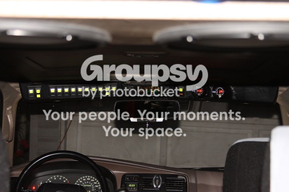

...Well i've been thinking about merging all my switches and possible future ones into one location. This would include my Back Window, ECT and Diff Lock, add to that some Winch controls and my lighting switches. Mine are currently down to the left of the steering at the moment( can't be too proud of that pretty pic there), and if I was planning on having more than 10 possible switches in one location, well i'd be better off looking for an alternative.
84-1_zpsa665636b.jpg~original

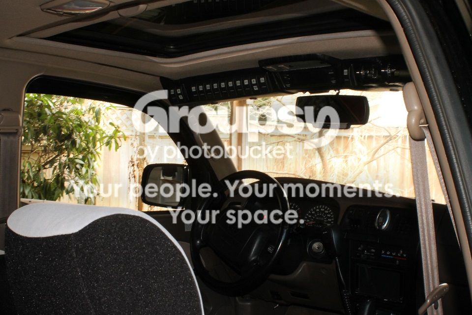

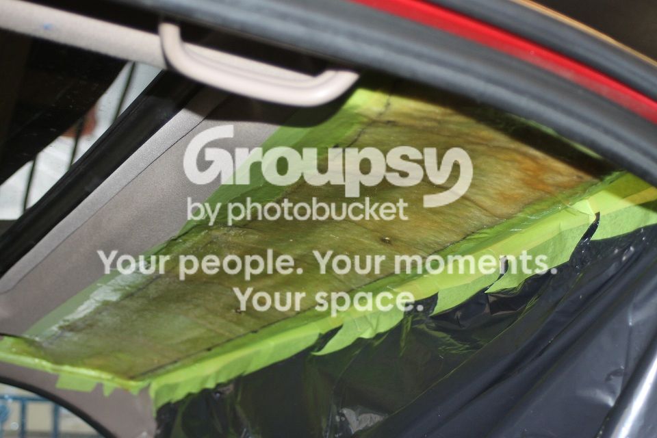

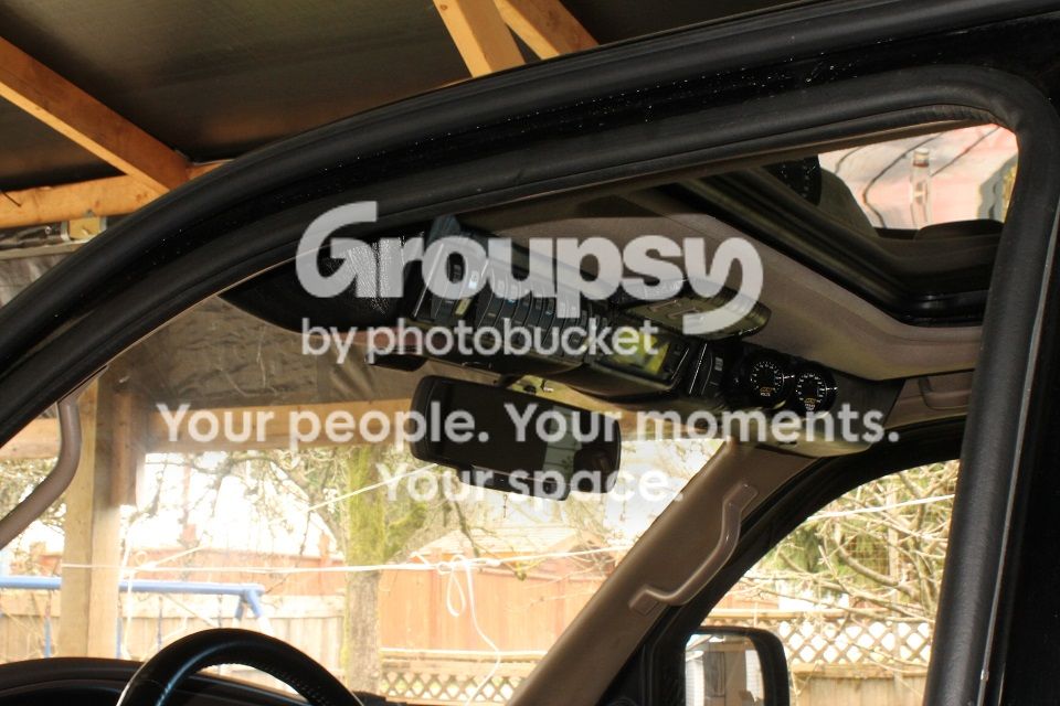

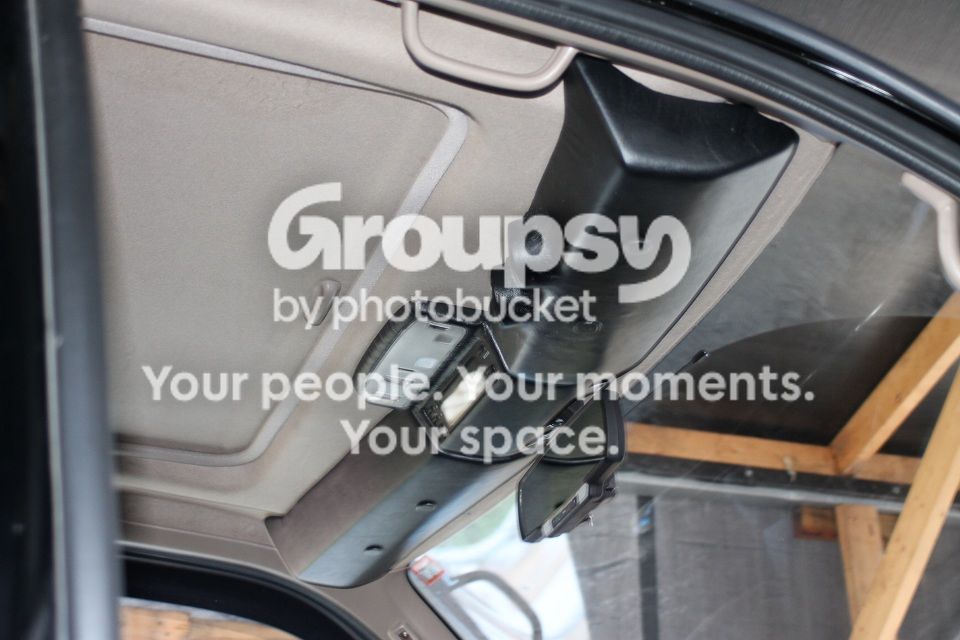

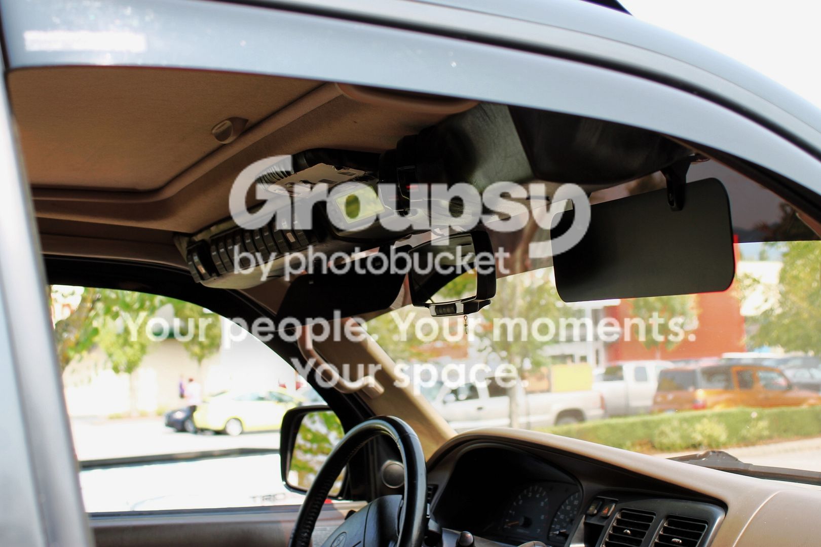

Given the limited setting in the 4Runner, I was determined that the best place for a bank of switches would be up on the headliner.

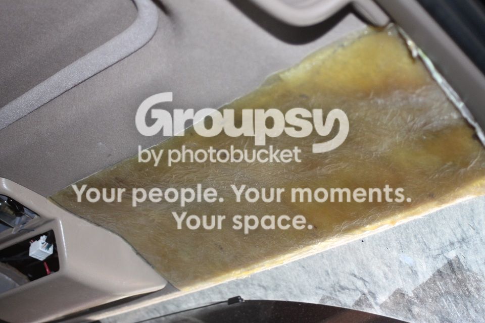

All was set only to find that the 4Runners headliner was comprised of irregular angles and contours and simply laying down a base for the switch pod wasn't gonna cut it. It just isn't gonna hug the headliner flat. My take on that was to lay down mats of fiberglass to conform and follow the shape needed. First I covered the headliner with some green masking tape
for the resin to adhere to. Removing the headliner would be an option allowing you to work on the floor more conveniently while fiberglassing, but I didn't bother with that unnecessary step.
I did 3 layers of 8oz fiberglass from end to end. First layer. Initially, I wanted to incorporate the FMU with the whole switch pod and make one long unit but opted on the modular 3 piece design.
Fiberglass base after splitting in half and mocked up to see fit.

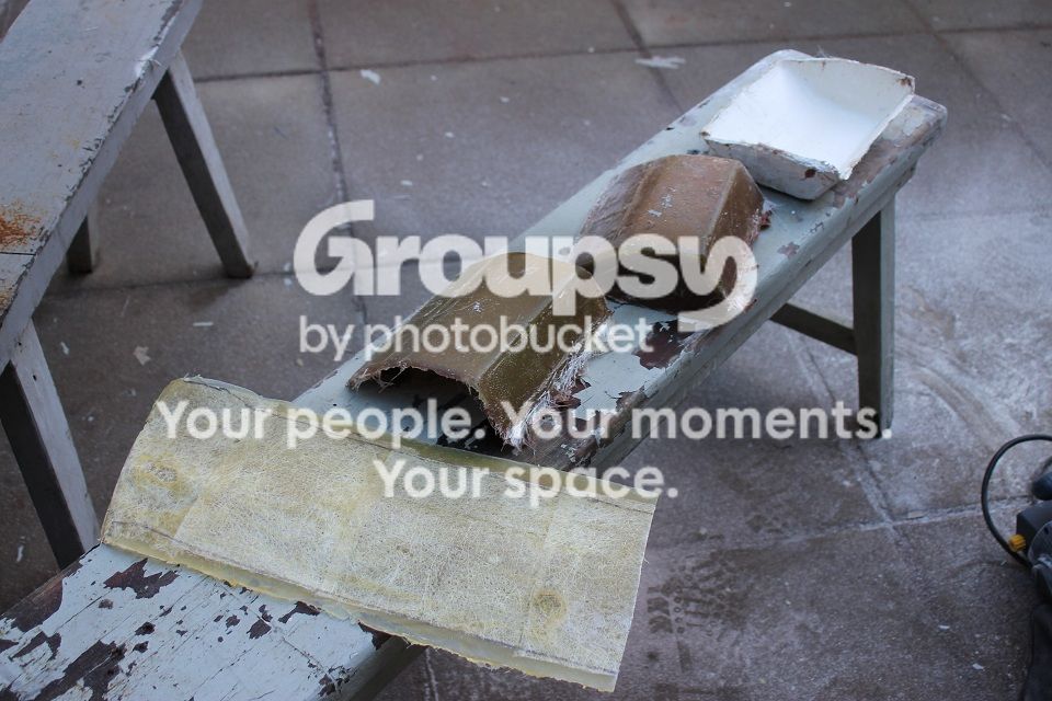

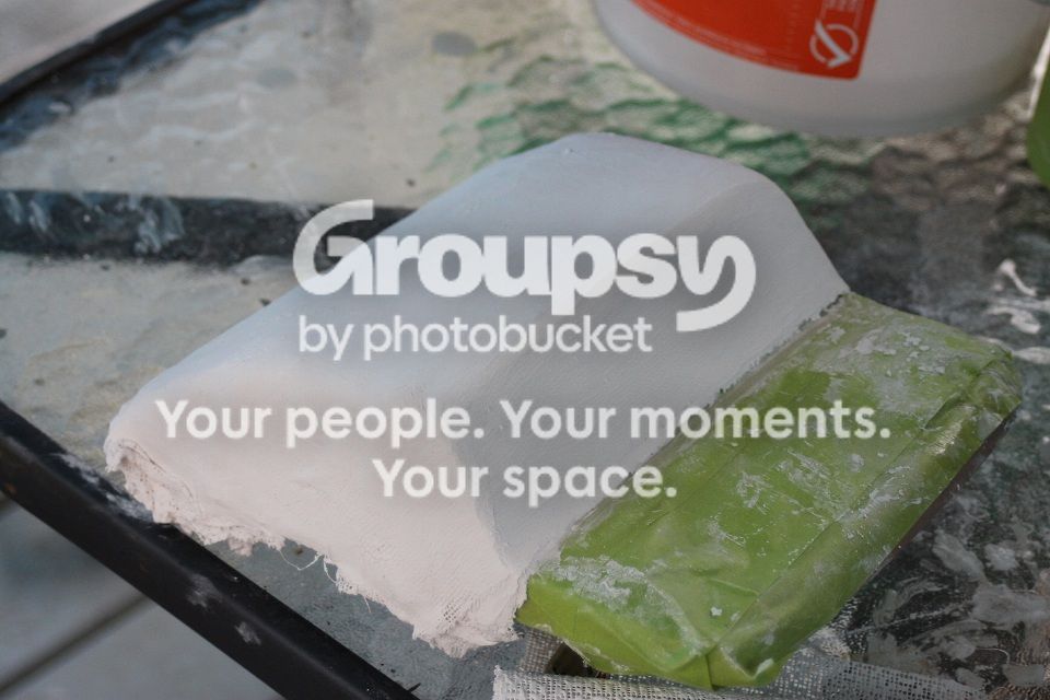

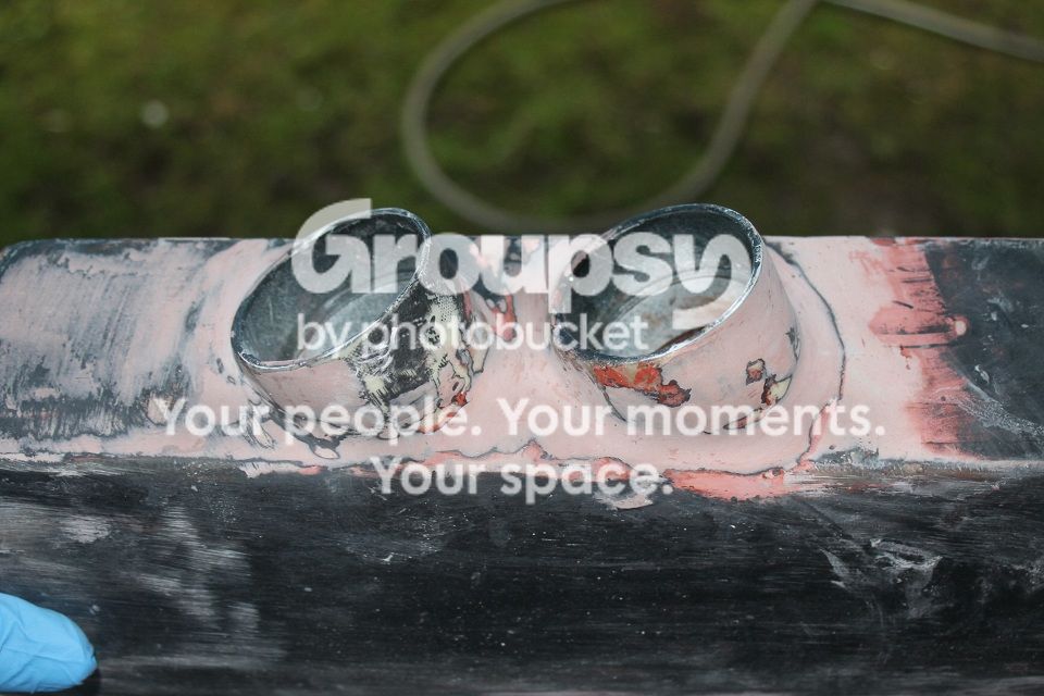

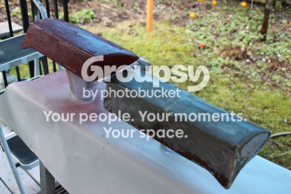

After that's done, it was time to tacle the actual switch pod housing. For that I used the shape of my FMU shell case and just make a mold out of it. To begin with, I used some plaster to create the overall shape of the shell, let it cure and harden and I've got my mold.
With the positive mold ready, fiberglass followed. I needed to make atleast 4 of those shells, 2 each on either side of the FMU. Here's a pic of those glassed shells fused together. Remember that headliner base I made in the beginning?? It's also fused with the casings with more fiberglass.
8-6_zps41520302.jpg~original
Both sides done with one being primered. Since the surface was almost smooth, I only needed a few touches of body filler to finish 'em off.

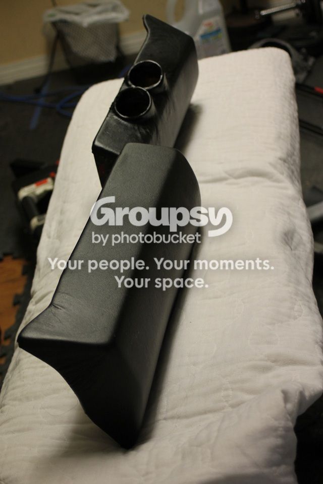

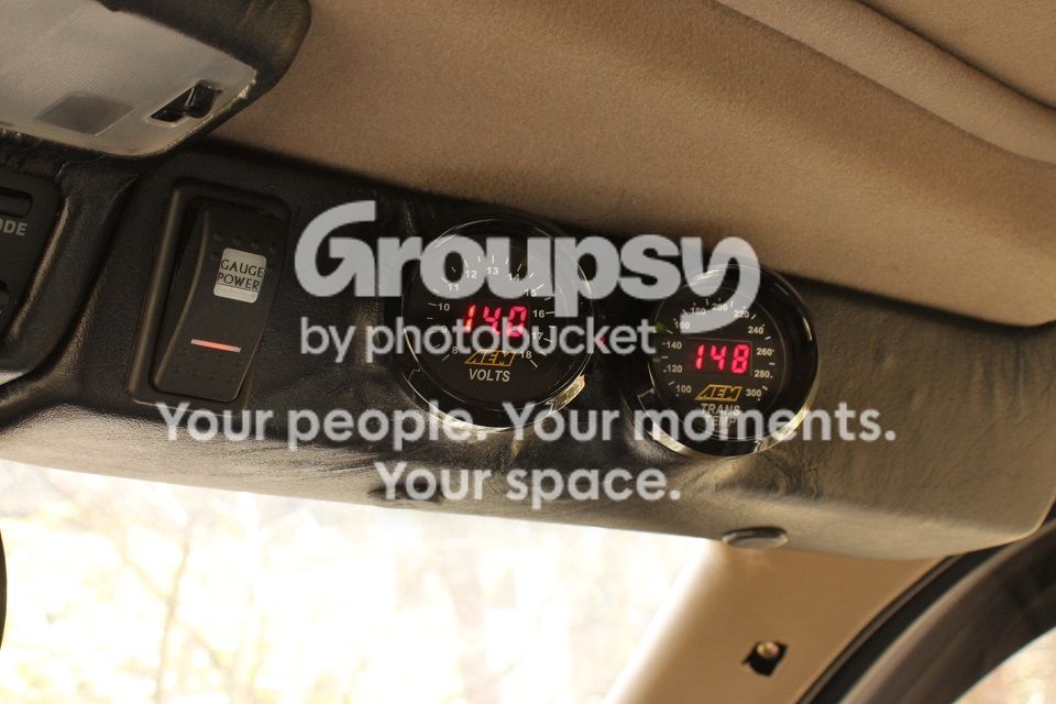

My project would also involve some gauges from AEM(voltage & trans) so for those I had to make pods to enclose them in as well. Went to the hardware store and bought some 2 1/8" abs tubings. Long story short....more glassing, bondo'ing and sanding. The gauges are gonna be on the passenger side so in order to have a better visual of the readings, I directed the orientation of the pods to face the driver.
Ready for priming

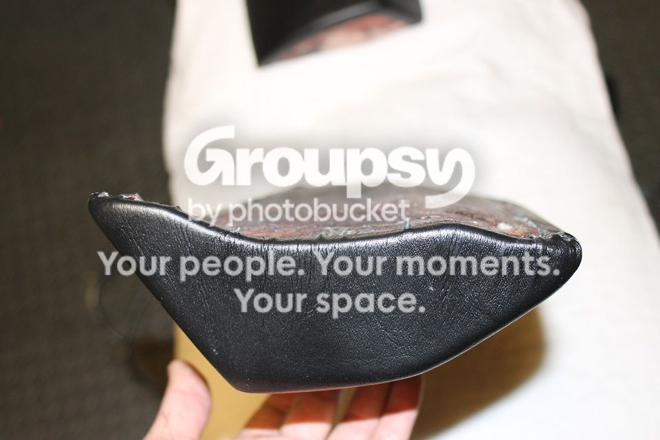

For the cover, I chose synthetic leather vinyl in black to match the dash trims in the 4RUnner. The FMU was also covered in the same fashion.
The pods are done.

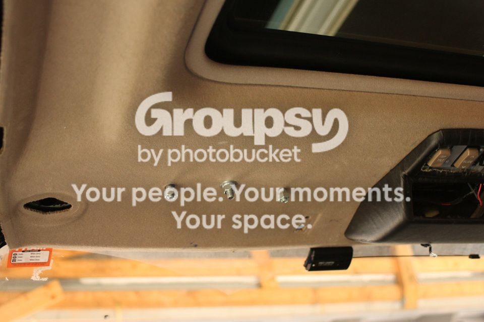

Here's a good side shot of the passenger pod indicating the irregular shape of the headliner the base needs to conform to in order to hug it flat. Drivers side is exactly identical.
To attach the pods onto the headliner, I made a flatbar with 3 bolts welded on and slip them inside. This shows the bolts sticking out with the middle one holding it secure in place.
I drilled thru & thru holes on the pods and covered the bottom holes with plugs which are also covered in black vinyl. Now it's just a matter of bolting up the pods and on I go.

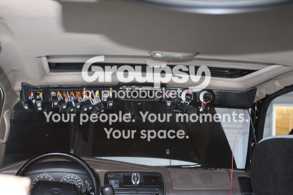

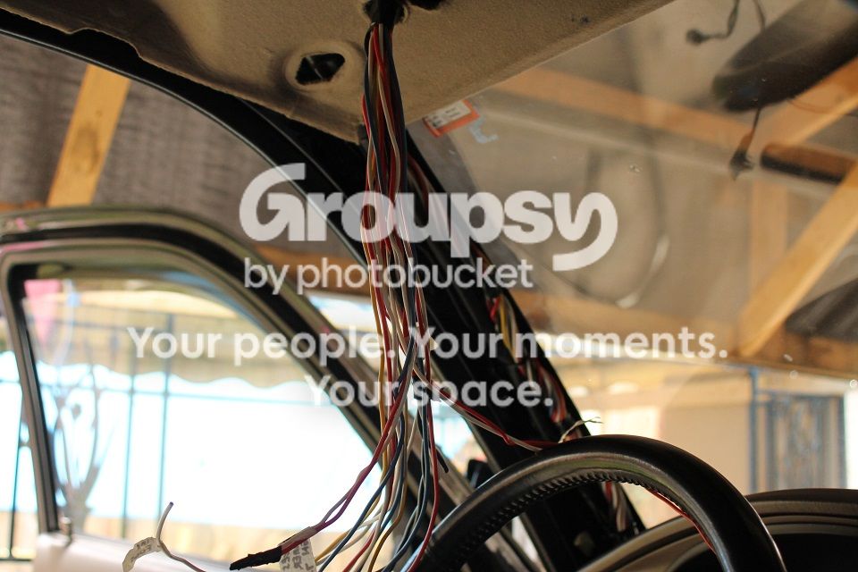

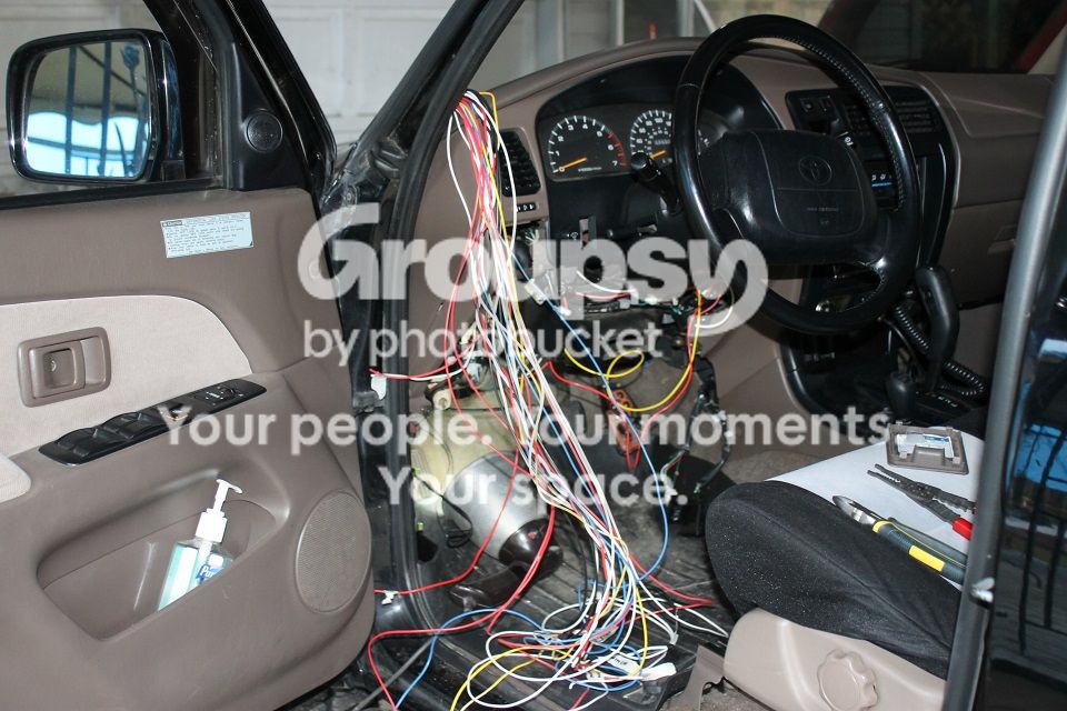

Holy mayhem! I would have a total of 12 switches so a whole bunch of wiring needs to be run. Got them all labeled up as I go.
So I basically just drilled another hole on the back of the switch pod for the wirings, switch holders on the front and began wiring 'em up. I got abit carried away with it and forgot to make a few shots in between.
14 strands of 16 ga and 6- 18 ga wires for a total of 20 wires were used to run all the switches including two ground wires, switched +12v and dash light circuit wire.

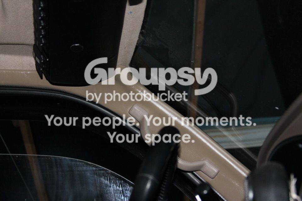

Thought you wouldn't ask? .....the a-pillar and cover trim just doesn't have enough room to cram up that many wires to make 'em all fit. I'm already using that space to run my roof light wirings so how'd I do it?

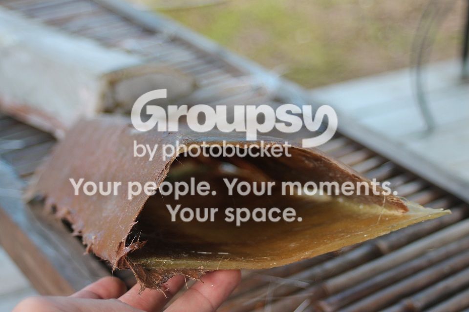

Here's how. I took the a-pillars and modify them to basically fit atleast a 1" diameter of wiring combined. Simple enough? Yes it was. all I needed to make was another mold and give the a-pillar a wiring super busway.
Took a 2" round stock and chopped it in half, fiberglass 3 layers over it on the a-pillar. Once hard, I removed the molded piece from the a-pillar and cut away the flat section of it. Now we all know that fiberglass doesn't stick to plastics, so to mate the new mold with the a-pillar, I used a heavy duty vinyl spray to do the job. Again I used a color matched vinyl to cover the entire trim piece.
Comparison of the old and the new, red color is primer.
Looking at the new a-pillar. See any exposed wires, no?
And here's how they look like looking at the front.

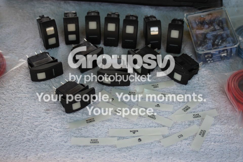

I ordered the Contura II's from Jim at OTRATTW, nice guy to deal with by the way. Also I decided on making my own labels for them using my Brother P-Touch label maker... The dual windowed rockers are for the WINCH's "in" & "out" and the BACK WINDOWS "up" & "down" buttons. Unfortunately, OTRATTW don't carry these rockers so for those of you interested, let me know where to order them.

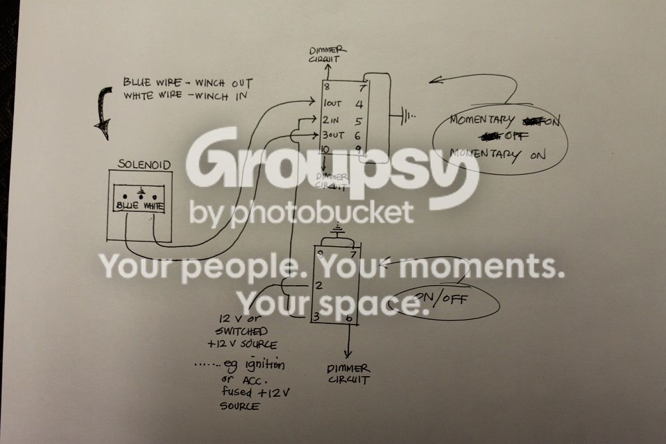

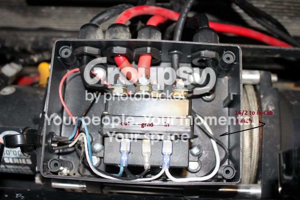

Here's the solenoids guts while noting my observations regarding the controls for the in-cab switches for the winch.
There are 4 wires in behind the controller plug, 12v, grnd, in and out. The blue wire in the solenoid controls the "reel out" function and the white wire is for the "reel in".
I elected to get the 12volt source inside the cabs fuse box for the Master switch and just tapped into the 15amp ACC using an add-a-fuse..Surely you can also use the same 12volt inside the solenoid itself if you wish to do so.
Also for the momentary switch, you can use any switch of your choice, I just happened to have the Carling ones in hand..

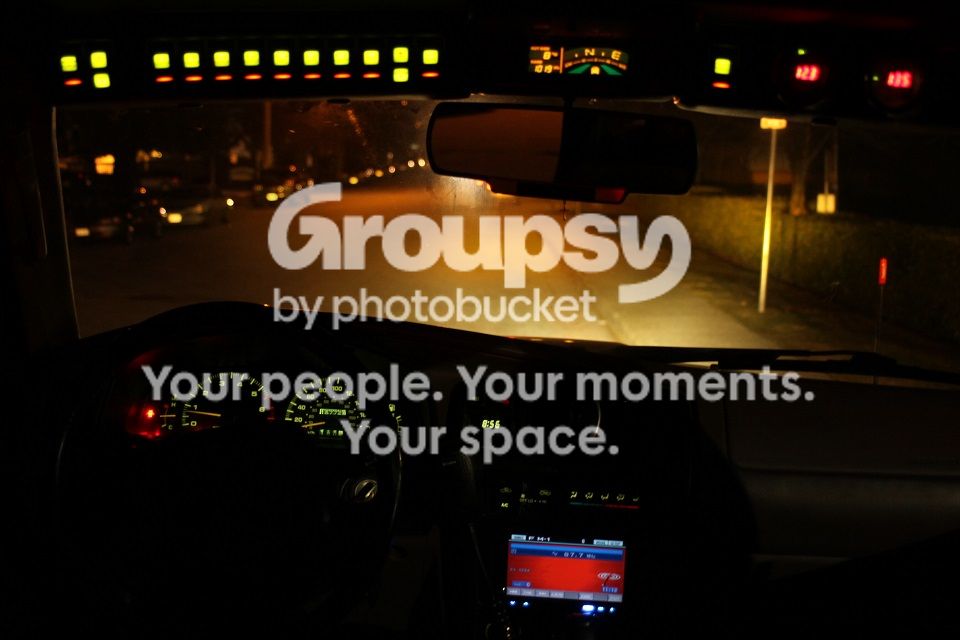

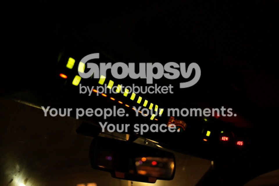

Green is with the dash on and amber is the switch on indicator.
13-4_zps5171a95b.jpg~original

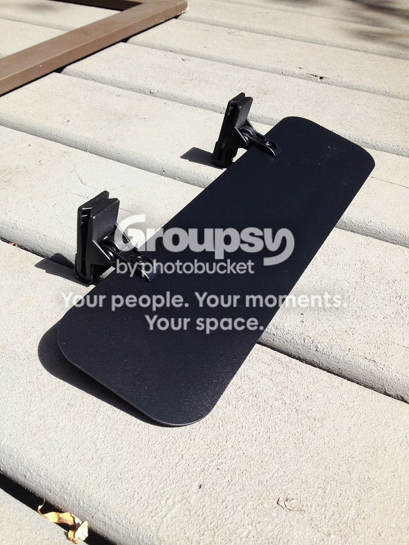

The stock sun visors were then replaced with a clip-on type ones. They came in a smoked tinted version but upon using them, I found them to be too translucent and I still get blinded by the sun. I simply painted them using some plastic primer, flat black paint and then some matte clear to protect them from scratches.

Question: Do you ever feel that the switches are too low/close to you, and "in your face" while driving?
Honestly, not not at all man, they aren't exactly in my line of sight to even be called distraction. I'm about 5'10 and they're still above my head......In my normal comfortable seated position, my eyes are about 20" away from the switches so plenty of space in between. Tilt your visors about 2" down and thats how low they are from the ceiling.
The only time I get really distracted while driving at night is when I can't help myself looking at them to be dazzled by them, lol but otherwise they're not "in your face" close at all.
Also the light emmited by those green LED's are more like a diffused dull neon color so they're not overly bright. They-don't-shine-up-your-face-green!
