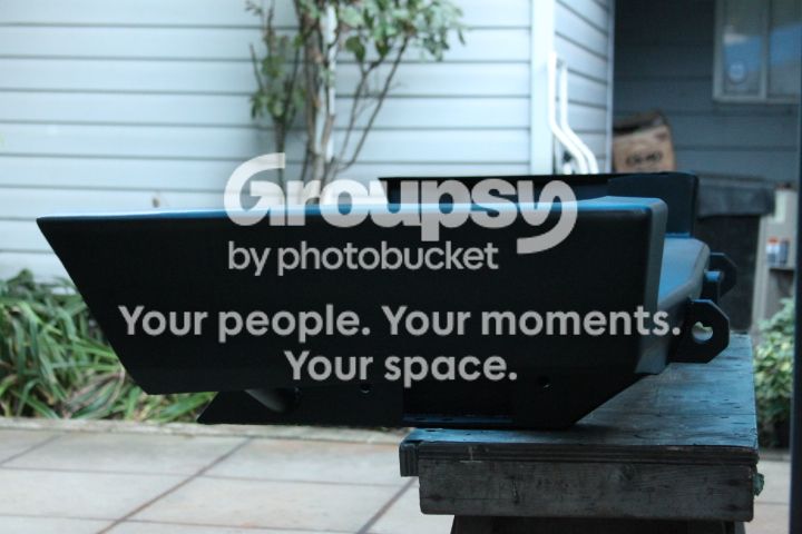

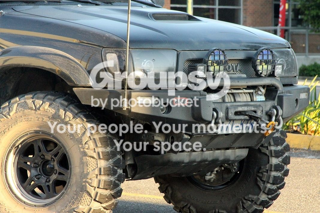

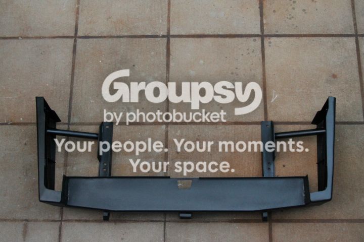

My ARB bumper underwent another surgery. By that, i mean it is now much slimmer in it's overall design. The depth and thickness of the bumper is very much comparable to it's counterpart..Infact it looks alot smaller.

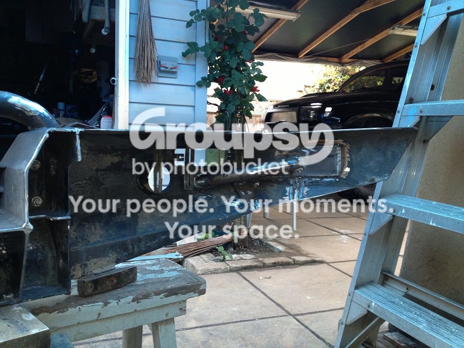

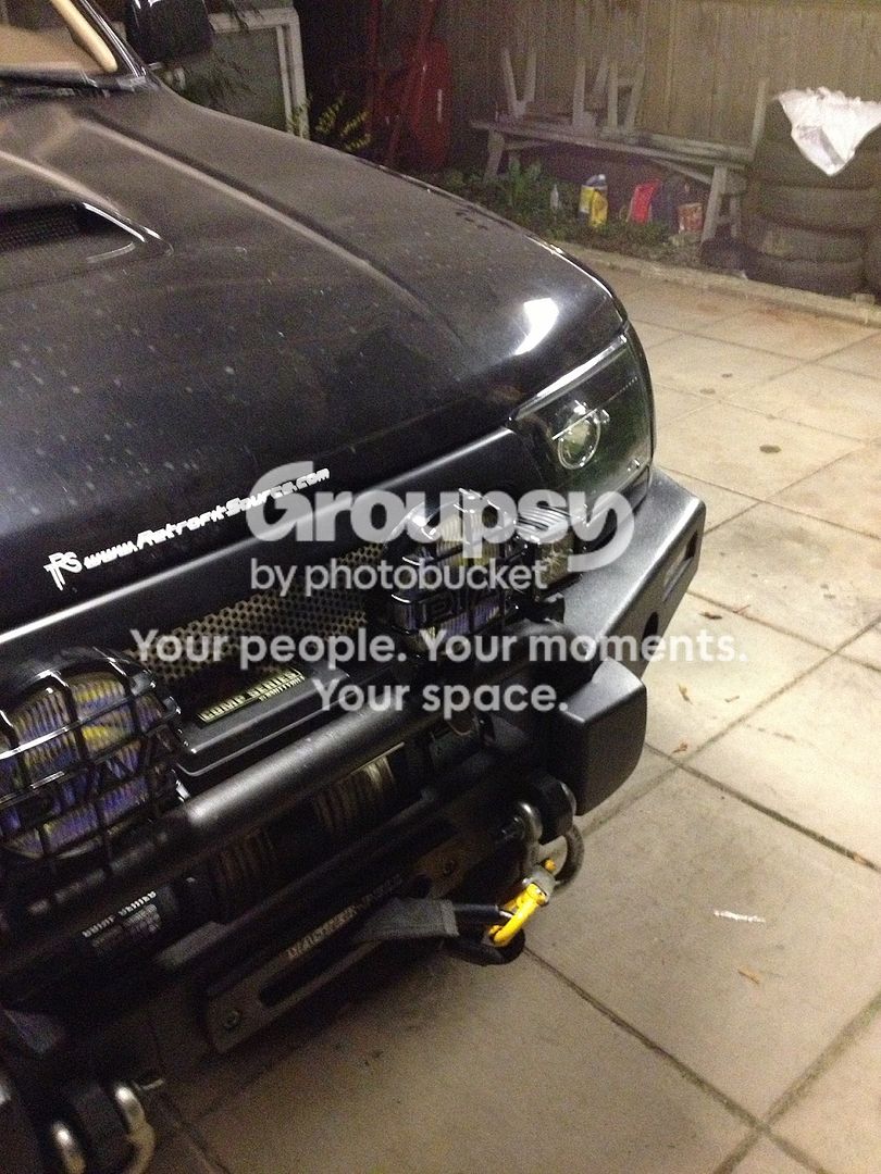

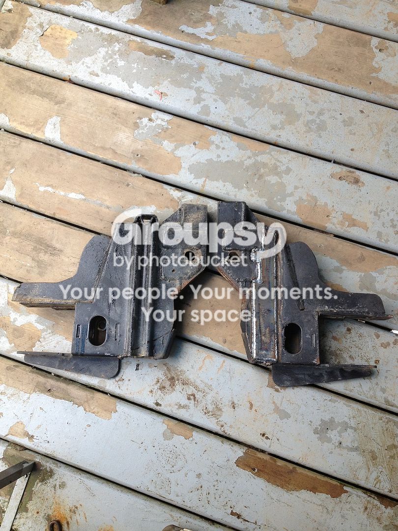

Basically to make the bumper shorter, I needed to shorten up the length of the brackets by about 2"+/-. I eliminated the wavy sections of the brackets to make that happen. Just so everyone's clear, I've had that part braced up to begin with for the purpose of winching so the whole airbag compliance argument was never there from the start. Maybe i'm paranoid about it, but that's the way i've had it from the get go. Coincidentally, the 2" of depth removed, proved to be just perfect just right before my Smitty winch hits the rad vertical support.

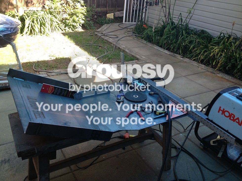

I uded a 3/16" plate and welded the two parts together and at the same time added more bracings on the other side of the brackets.

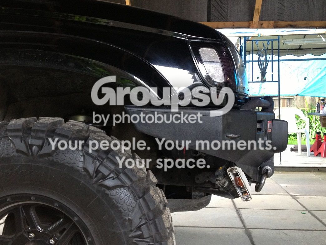

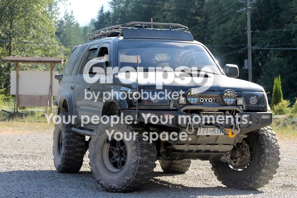

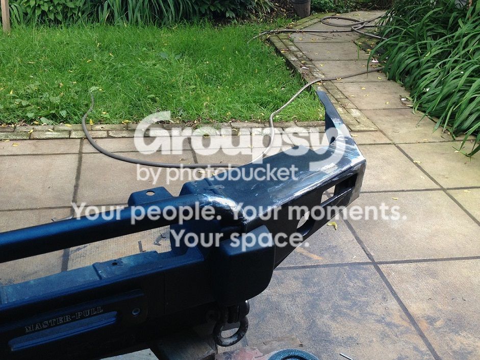

Here's a profile shot of the shortened bumper..I played with the notion of putting extra tubings atop the bumper in front of the headlights shown in this photo, but ultimately decided against it.
And there's a reason why in a minute.

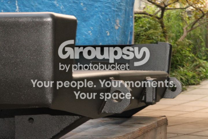

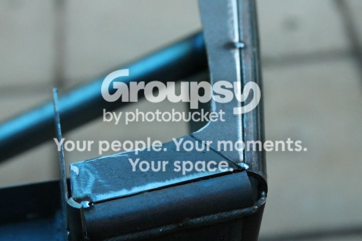

I went all out and scrapped the corners plates making the bumper from a 3 sided to a 2 sided design, also I flared it out to make the bumper meet the wider SR5 flares.
Braced up the straightened side of the bumper from the inside with a 4mil 1 1/4 round stock.
Why stop there?

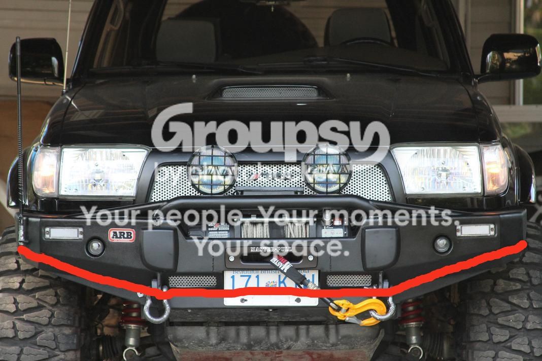

Part of the whole remodeling of the bumper was to make it look more sleeker and slimmer like I mentioned. So apart from just making the bumper shorter in depth, I must also make it thinner in height. That meant choppin' up the whole bottom section which would include the clevis points.
Yikes!
Here's my crude representation of where the chopping starts, from the bottom of the red line down to everything else inside the bumper.

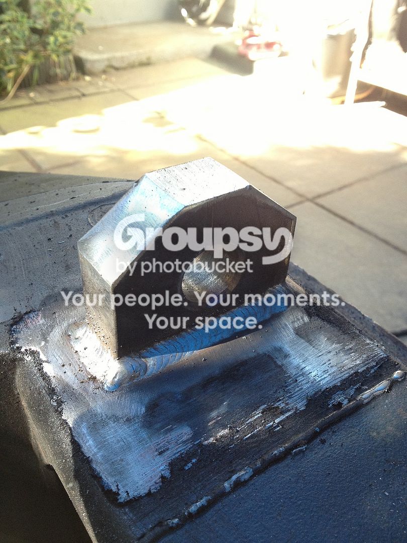

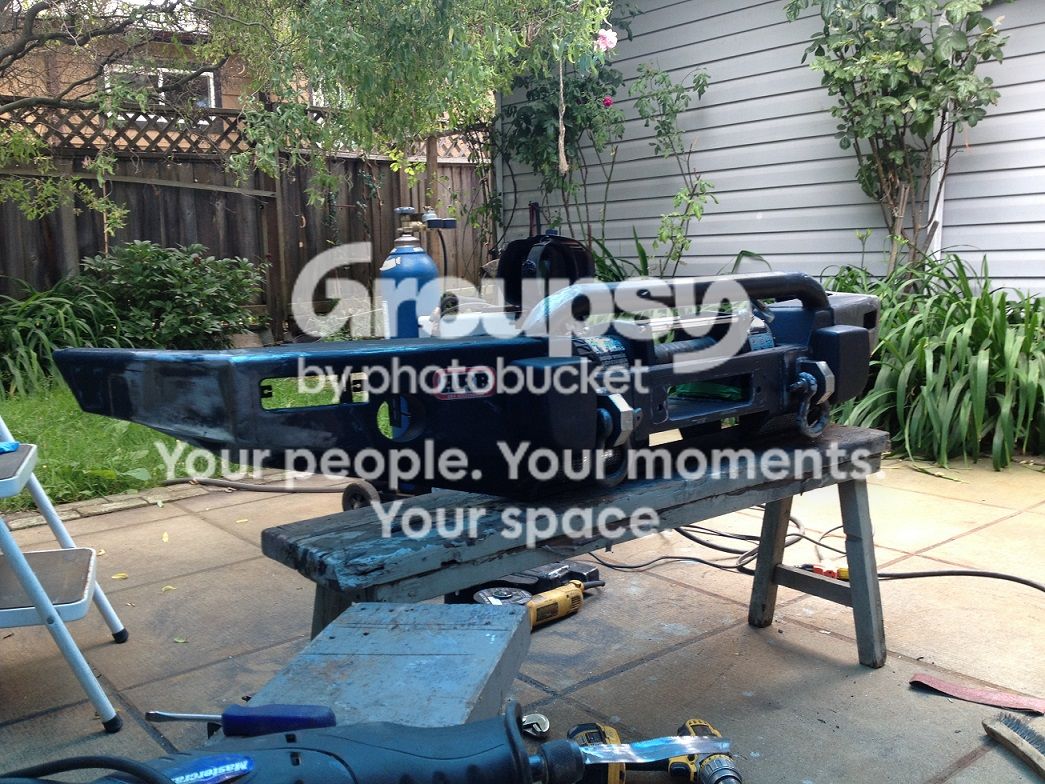

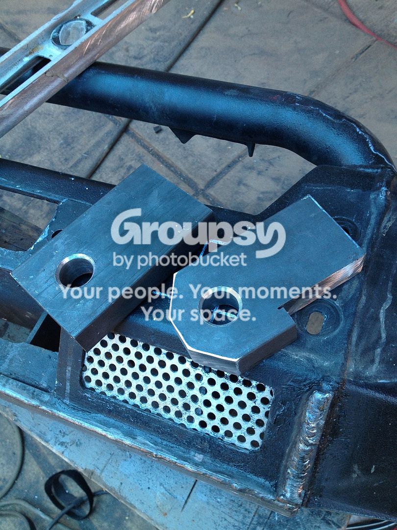

I needed to incorporate the new clevis points somewhere on the bumper, and for that, I bought a pair of 3"x5" cold rolled steel. I also didn't have access to a drill with an oversized mandrel + a drill bit, so i had the machinist bore a 15/16" hole for the shackle instead.
The placement of the new clevis shackle mount was essentially vital and I had just the right spot for each of them. Long story short, these clevises were welded at the front, back, on the winch' platform and on the secondary vertical support I previously integrated...all tied in with the main bumper core support piece. The length of the clevis bar was just shy of the where the winch sits.
All ready for paint.

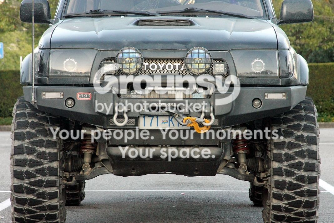

Shorter..
Thinner..
..and sleeker!

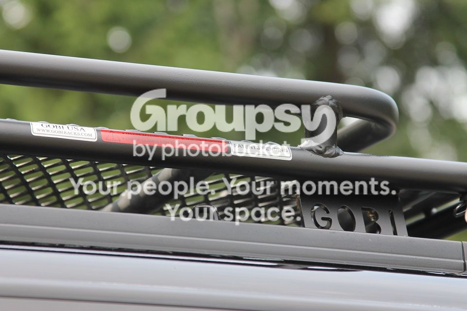

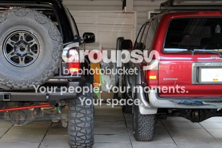

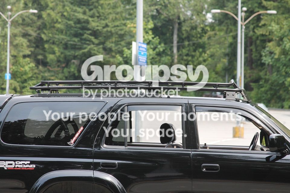

Oh yah...got the new rack.

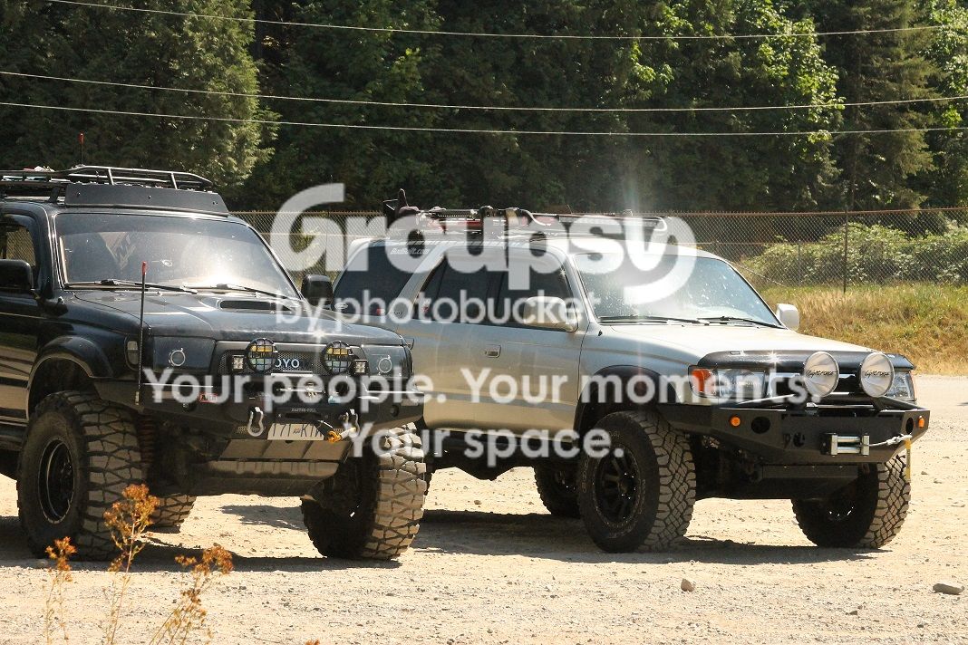

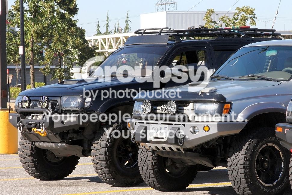

The newly re-designed ARB next to Outdoor Logic Bumper + the Gobi rack.

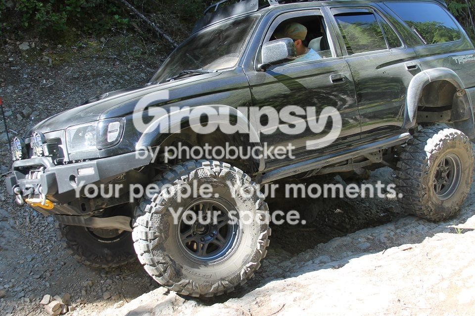

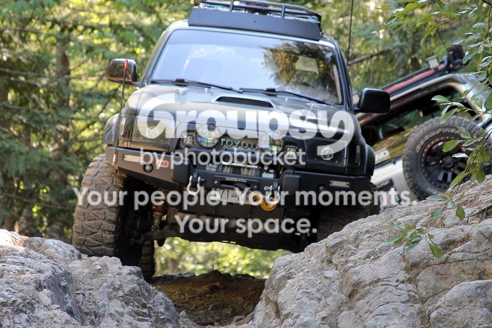

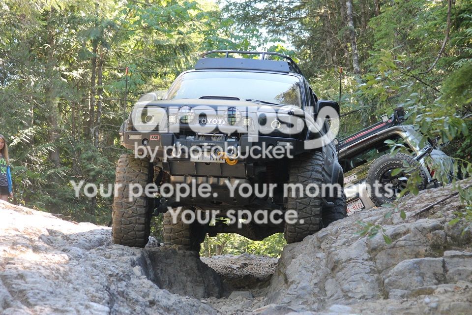

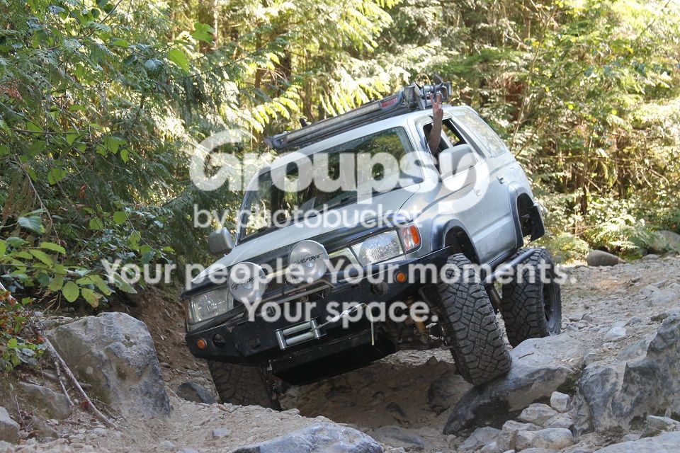

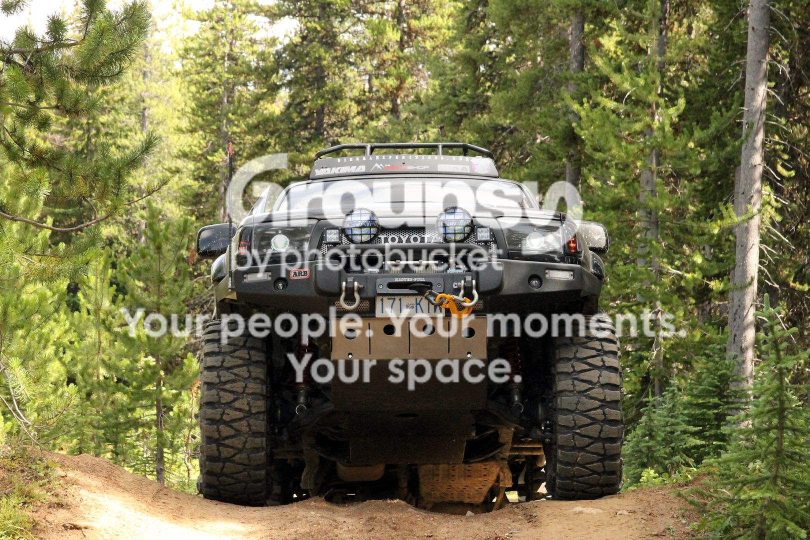

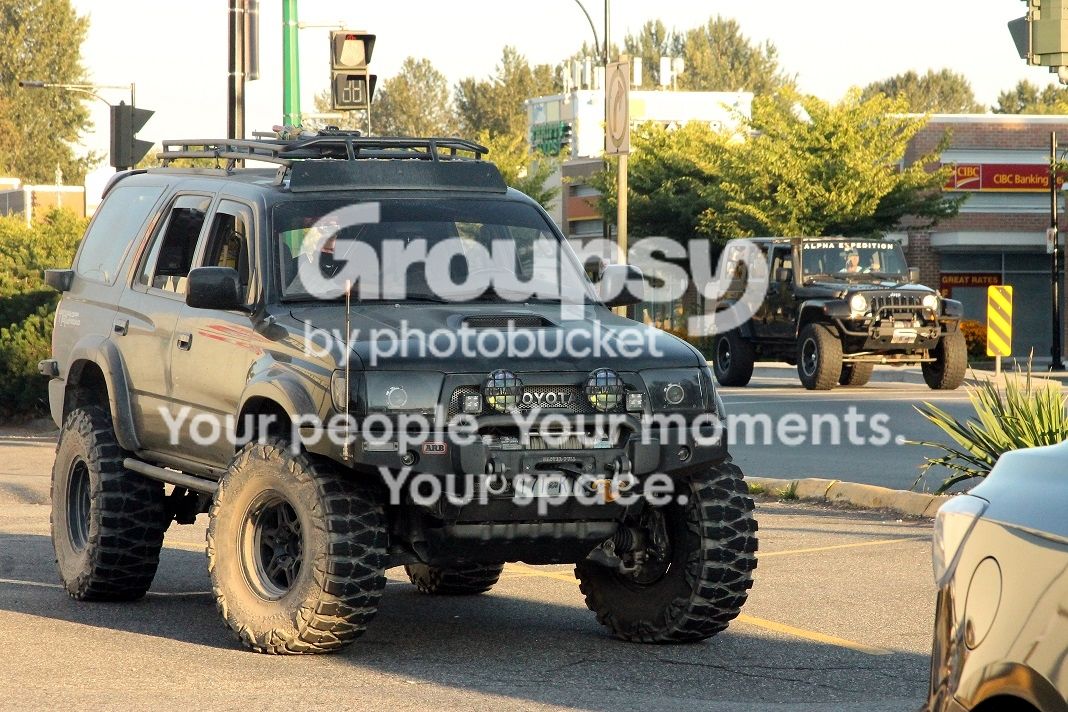

Bonus pics from our wheeling Monday. martin1991911 from Alberta came to town and I just had to show him some good wheeling spots.
D amphibious runner.

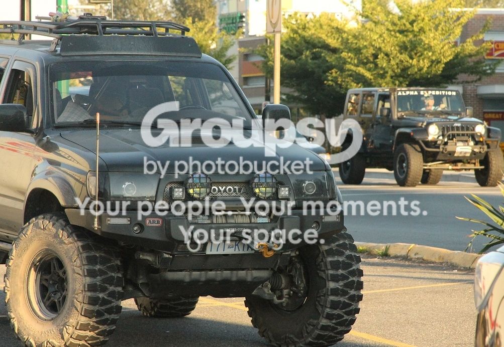

Ps, how did the guy with the grey sport mount his sport skid plate?
I asked myself that...Why go through all the trouble when I could just design my own to my personal likings. Well to simply answer that, I already purchased the ARB long before I even knew how to even lay down a bead of weld. Plus I love tweaking stuff up.:nod:
As far as the skid plate under the Silver Ltd., that is something I would need to get back to you about...I'm not so sure, but by pure guessing, it's no more than a fabbed up bracket system holding it.

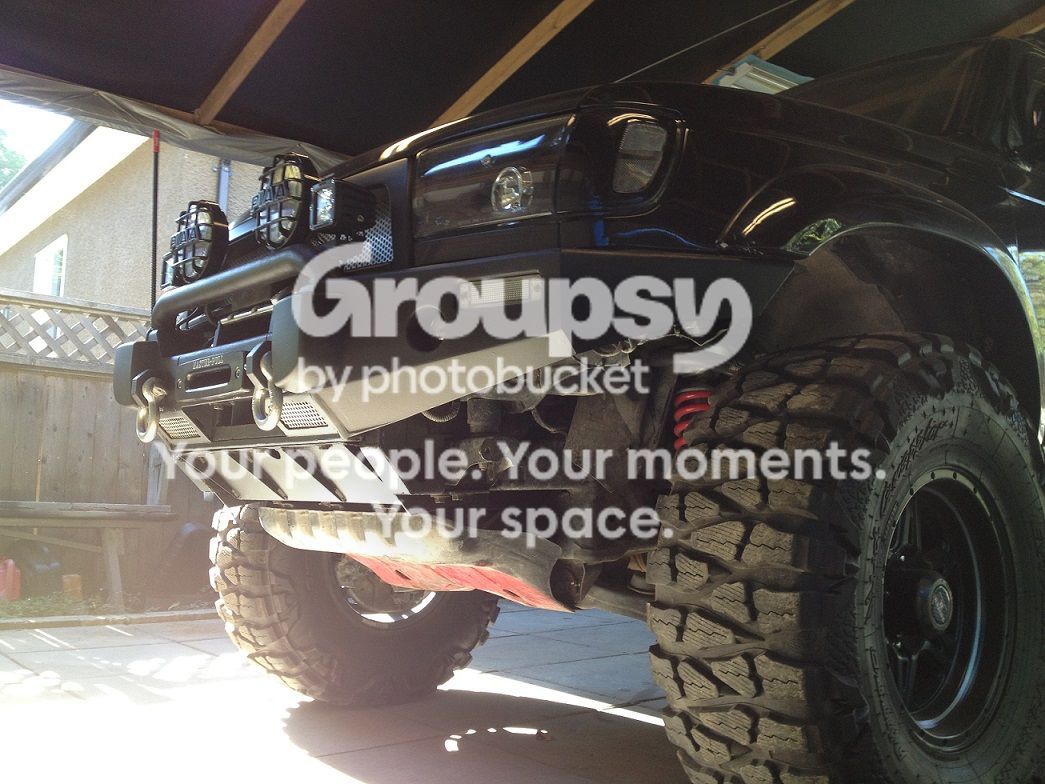

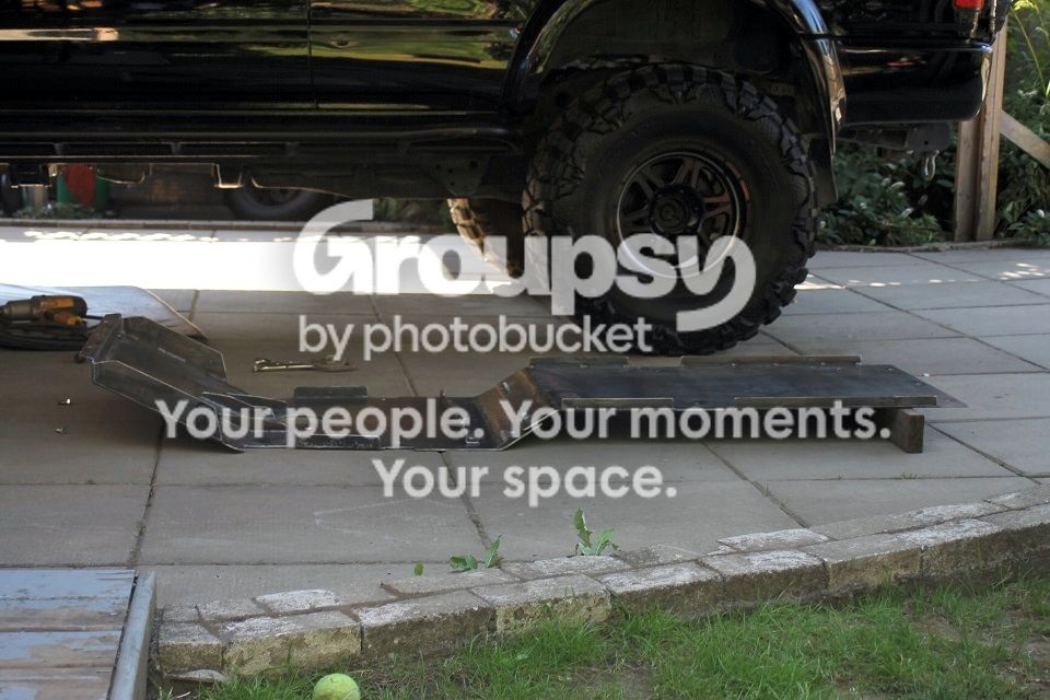

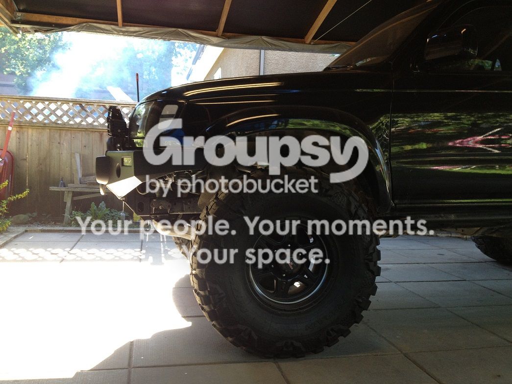

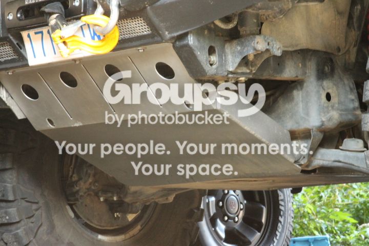

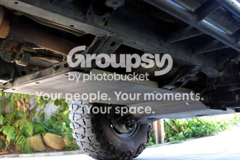

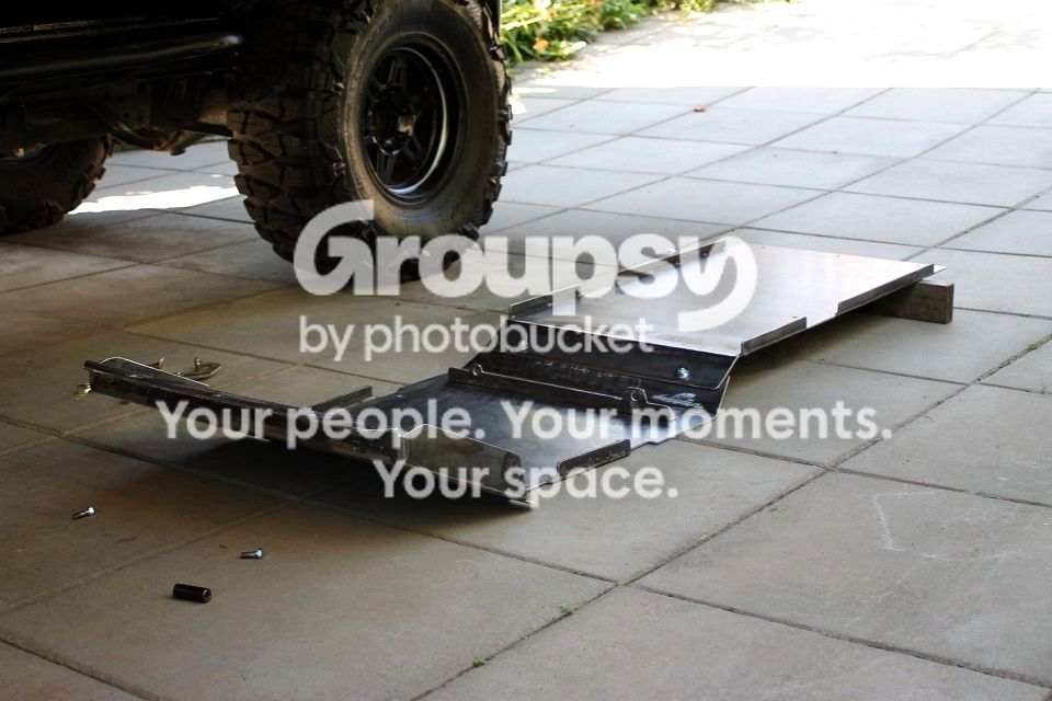

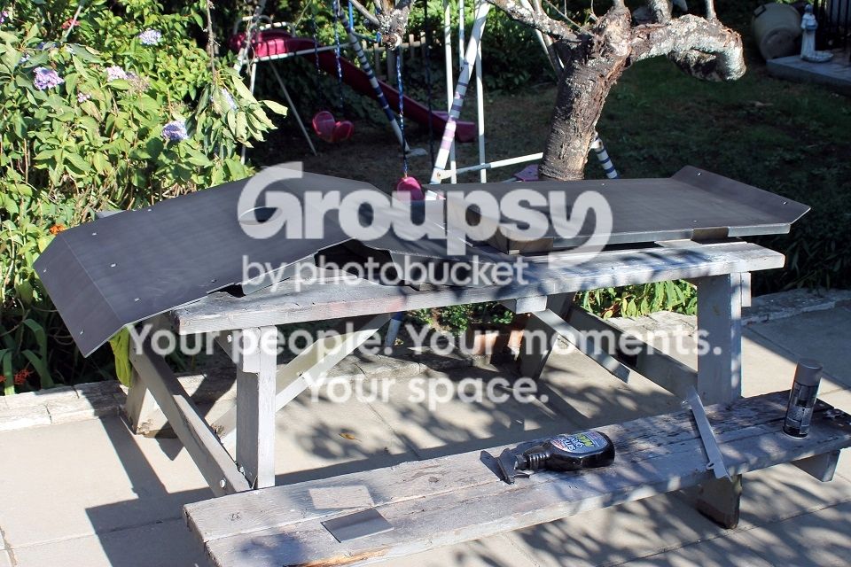

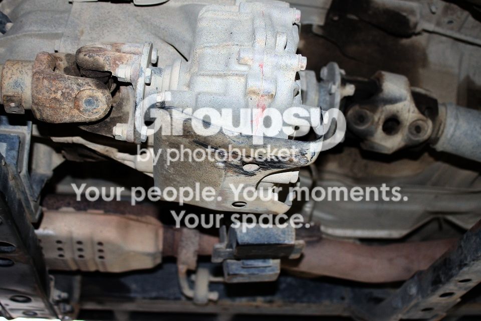

It was time I did something to armorize the underside of the 4Runner, so I went ahead and built an IFS and belly pan out of 3/16 steel. This was before the trip we made to Whipsaw on August 16-18, and I wasn't sure how the trails were. So i said better be sure than sorry. Besides, my transfer case cover, front crossmember had some scrapes and gouges being up that high, let alone the front skid.....No more!
Rad guard made from some aluminum sheet!

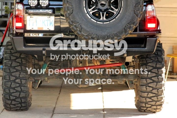

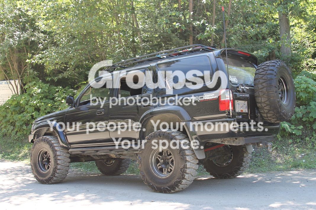

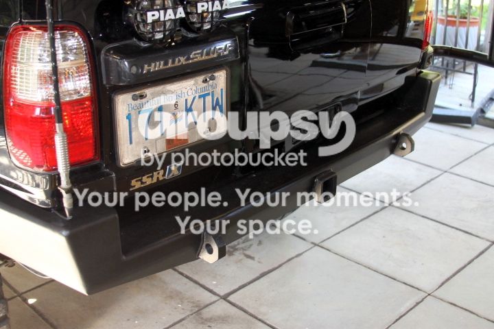

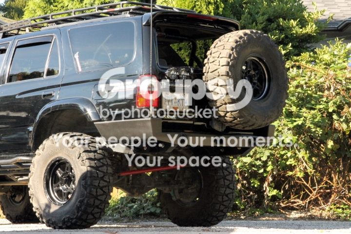

...Just a week ago, I also started designing a rear plated bumper after taking a hit on my stock ones.

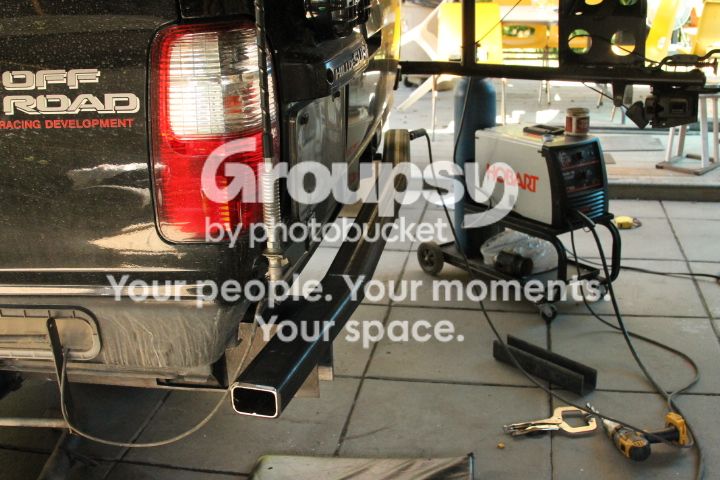

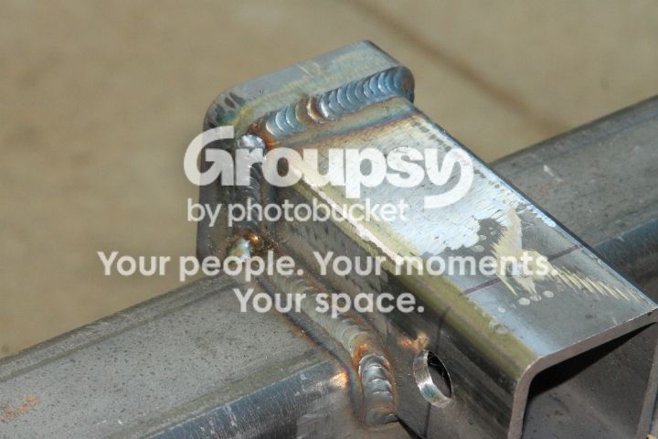

1.5x3x.250 rectangular tubing cut to follow curve of the 4runner. Setting to tack on top of the frame brackets that were made to fit a 1.5" BL.
After notching the .250 walled tubing to accept the hitch receiver.

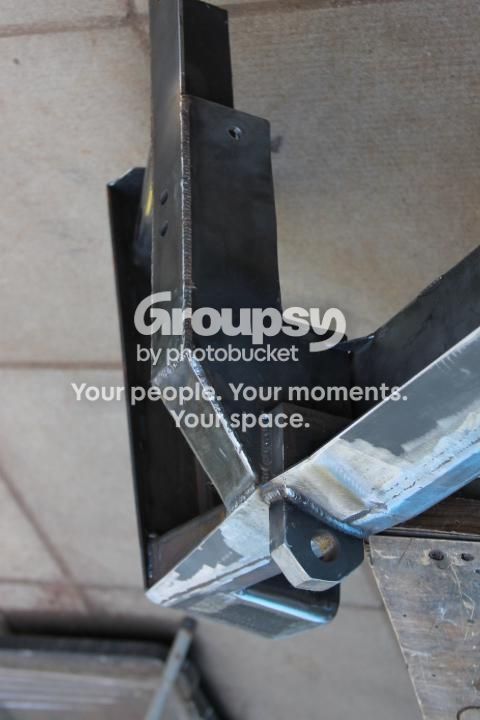

6" Shackle mount welded in & out.
Rounded top edges to match the front bumper.
Fast forwarding....Bedlined!
The bumper weighed in at 107 lbs. Materials used varied from 1/4" thick plates for frame mounts, some 3/16" plates for overall cover and gusseting, 1.5"x .125 tubing for side bumper support and 1/8" plate for the filler plate, etc etc!
Hardwares used are 1/2" grade 8 rated. I'm just over 30 lbs from the old bumper and hitch combined.
