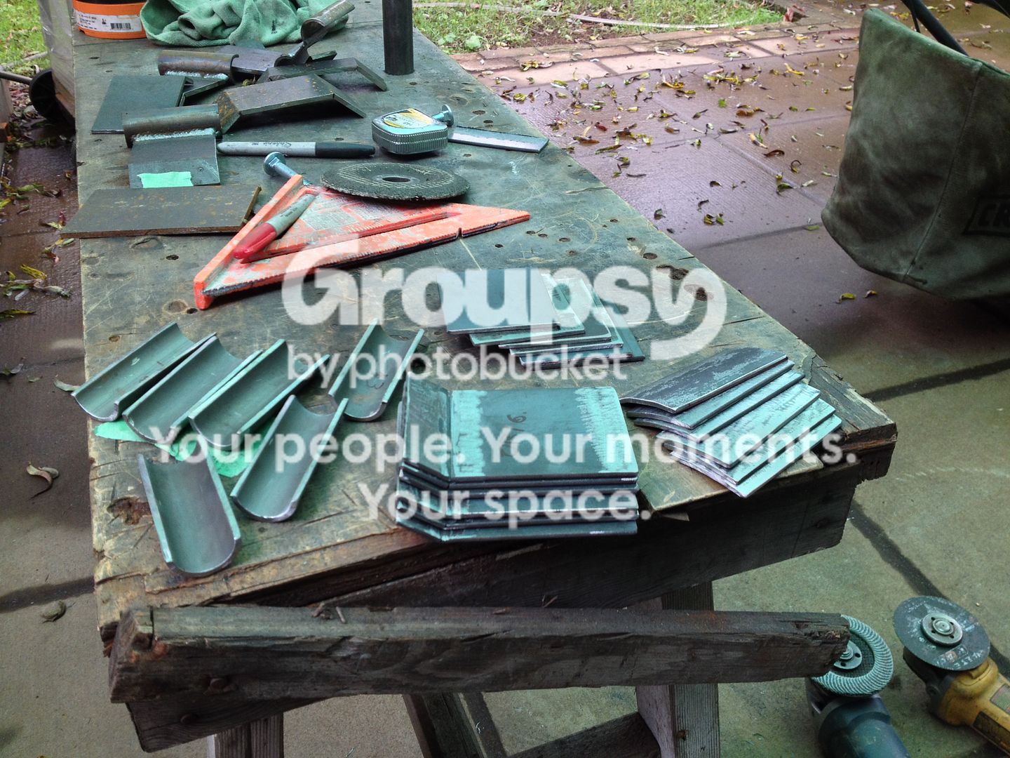

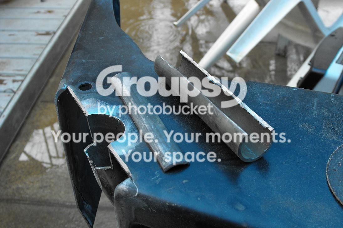

What kind of tools are you using to make your bumpers and skids? Did you cut round tubing to get the rounded edge pieces? I really like the idea of building your own bumpers/armor, but not sure what a good place to start tool wise would be.
Just your typical tools like a 4 1/2" angle grinder, cutting, sanding and grinding discs, cordless drill and bits plus step drill bit. I used the angle finder for the skids as well this time, and of course the welder, lol. Have atleast two angle grinders so as to save some time from interchanging the cutting and sanding wheels.
For the round corner edges, I just cut a quarter from a 1 1/4 tubing like I did for the front bumper. See pic.

Hmmm ok so you did you whole bumper by using a grinder to do your cuts??? Yep I can see how your neighbors might hate you :D
Get spoiled with a plasma once and it is all over from there you'll never want to grind another thing again lol
That's about right, also my air compressor is just 8 gallons, (mainly I used it for airbrushing) and I'd hate to be delayed every few seconds everytime the tank has to fill up with used air.

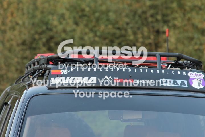

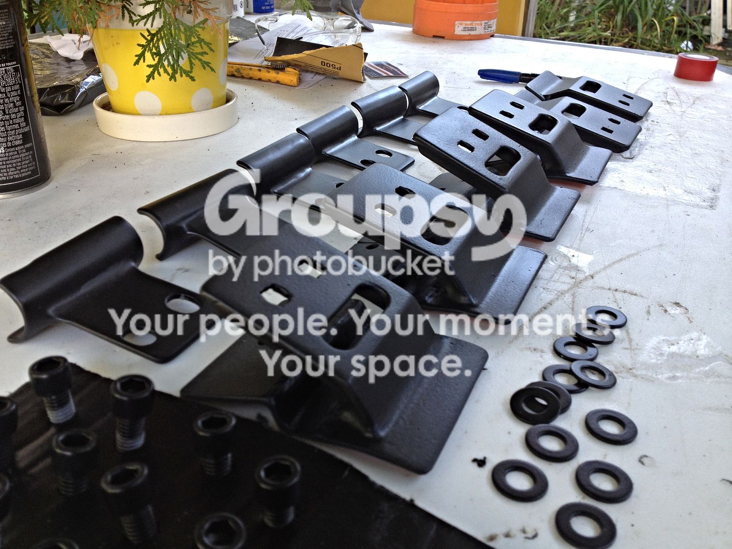

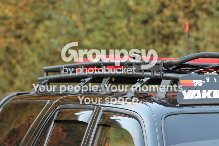

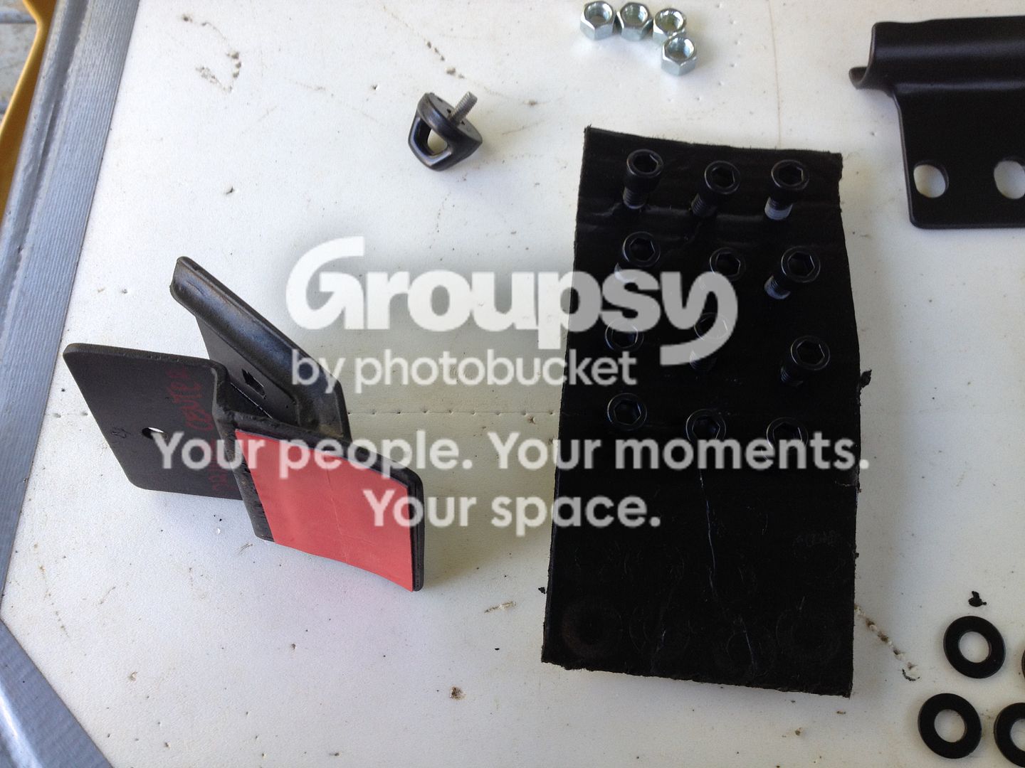

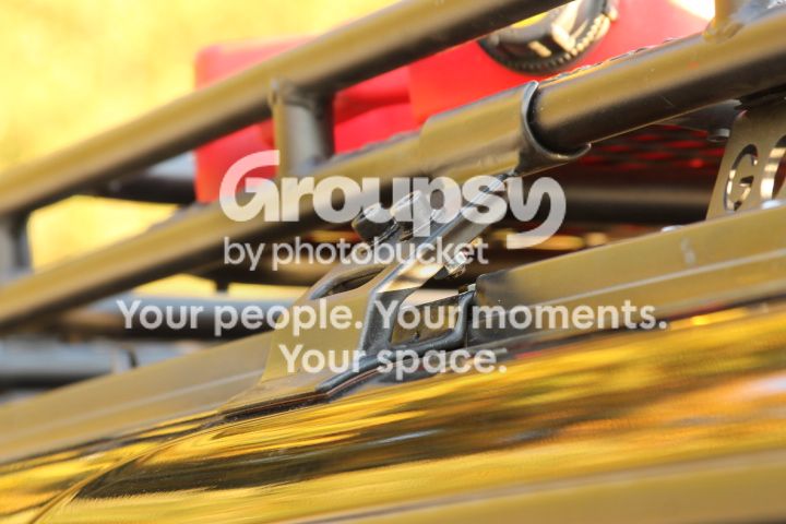

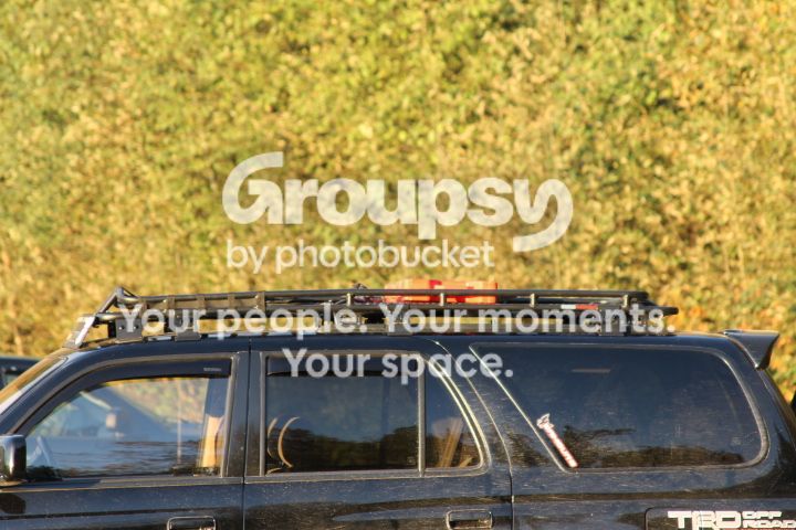

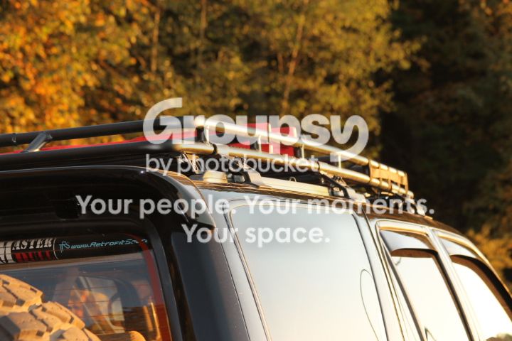

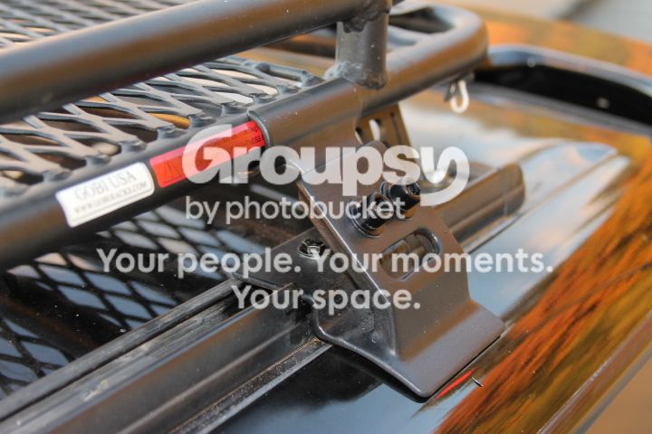

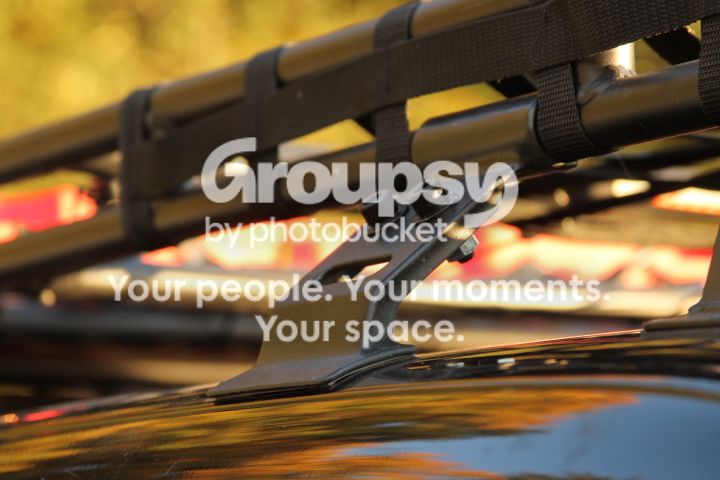

Hey GL on your rack venture with the 5th Gen model! Talking about rack, I did some little personal touches on my Gobi recently.
I've always admired Landcruisers and the likes that have legs on their racks that attaches to a channel. I also like how they make the rack appear to have wider stance because of the legs.
This is my imitated version.
I prefer having the feet of the rack outboarded from the tracks. It still uses the existing track to attach from.
REAR
MID
FRONT
:playball:
