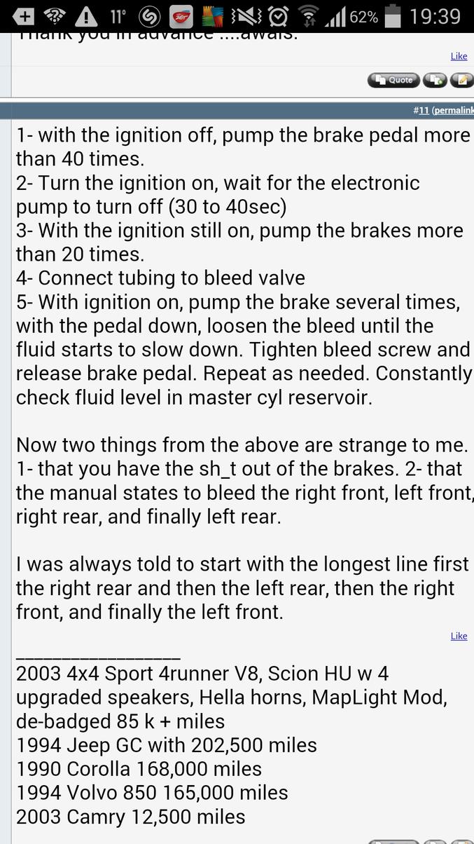

I just replaced my front calipers yesterday.
I bleed brakes the same way like i did with my previous car mustang gt 05. Brakes are working but I have to press the pedal really deep. If I press the pedal second time brakes are really strong like it should be.
I guess I didn't bleed brakes in a proper way. Should ignition be ON while pumping ?
I have started from right rear wheel than jump to left rear than right front and left front.when Fluid was without bubbles I just screw bleeder back.
Any DIY or manual would be appreciate. I was trying to search but i didn't find the answer.
I found this post but not sure if it's the right way
