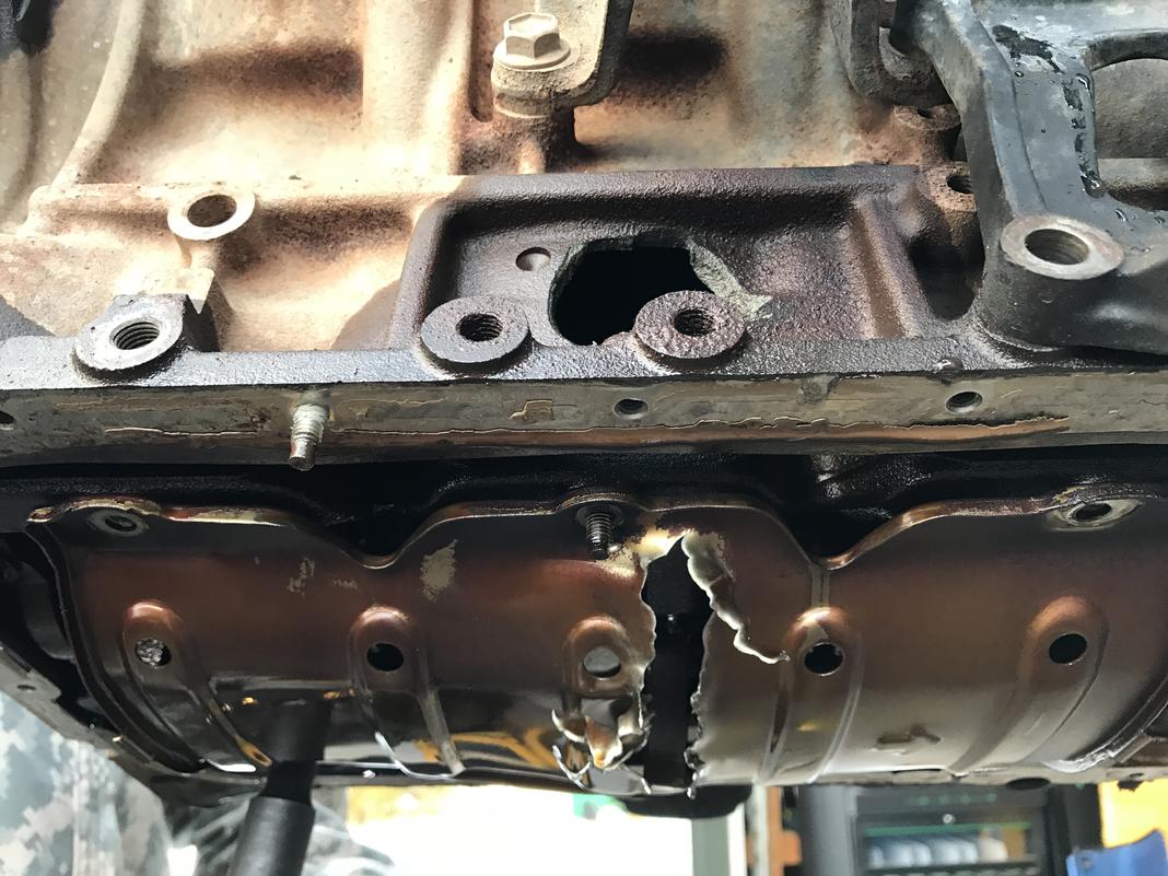

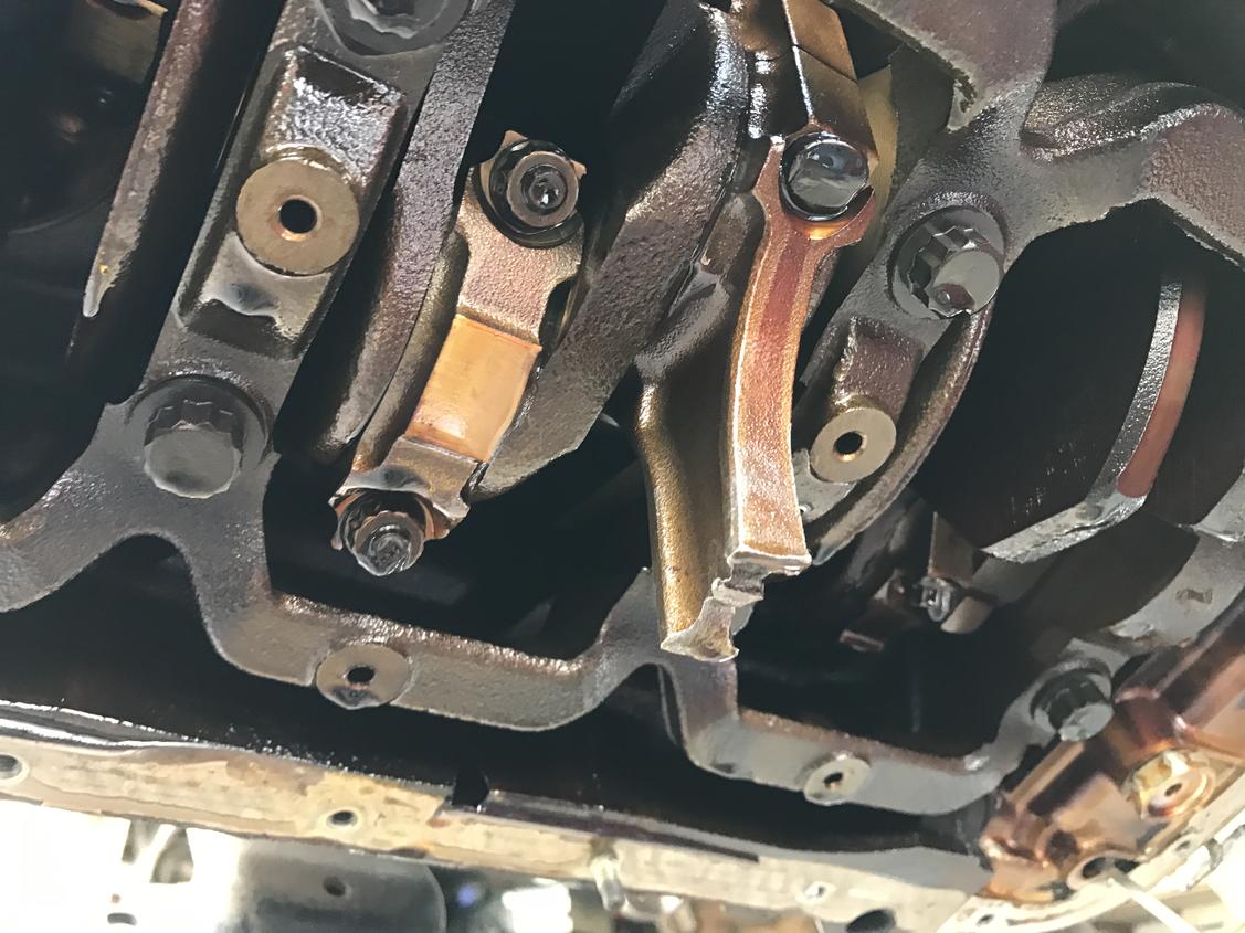

No it won't turn over now, just sounds like the starter is trying to spin but won't. I think it's hydrolocked with all the coolant.
When my starter sounded like it tried to spin but wouldn't.
