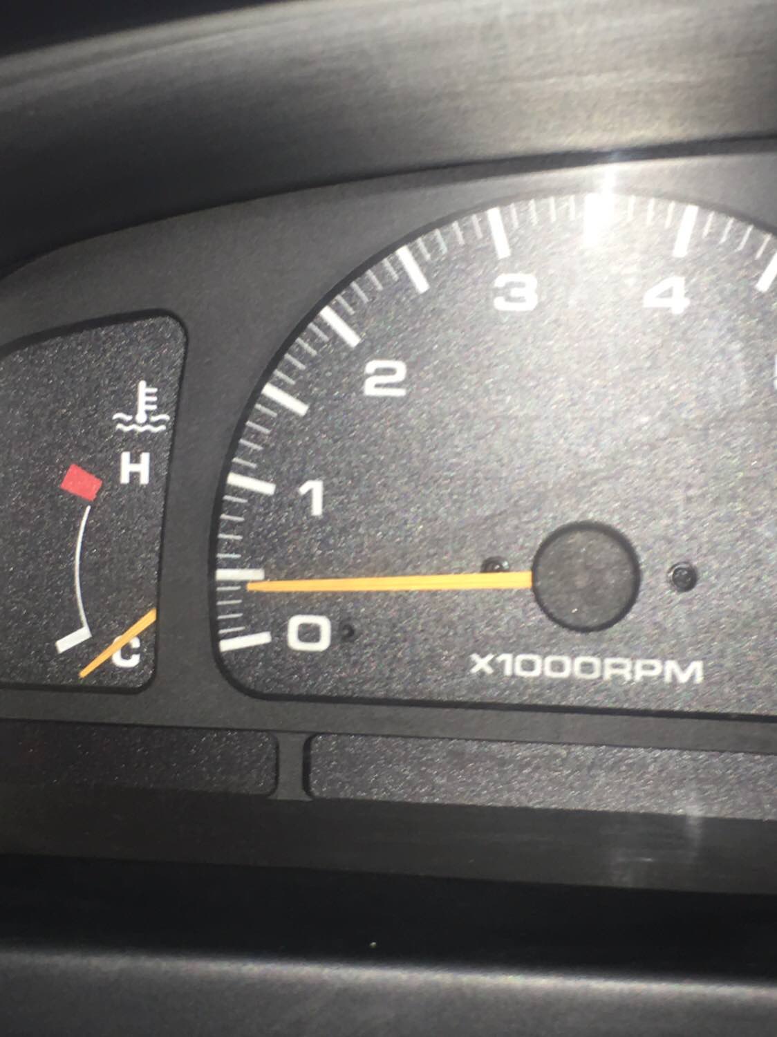

Yeah, I'm a little more worried about this low idle. So this morning was the first start after sitting over night in the cooler temps. It started then died, started then died, started again and gave it gas to keep it running, then sat at this idle till engine temp got up
Not sure why it's not idling at the 1400-1700 rpm like it used to right when you start it to help warm it up either.
Everything I've searched was for a high idle not a low idle so any suggestions other than the MAF?

Vacuum leaks. May try to do a smoke test on it.

Did you re-use the same throttle body? It could potentially have a clogged IAC, what you are describing are classic syptoms of one.

I agree IAC. Mine did that after I took everything off the top to do the valve cover gaskets. I ended up cleaning mine out with MAF cleaner and it started working normal after a few starts. Even if you have to replace, its pretty cheap.
My offer of helping still stands btw!
No the only things that were swapped over were the pulleys.
I'm gonna clean the MAF sensor when I get home today and see if that does anything cause this is a different one than the one I cleaned on the last motor to try to fix this issue
So check some things today with [MENTION=115347]gamefreakgc[/MENTION]...
checked all the grounds and cleaned some of them up
cleaned MAF sensor
checked for any major vacuum leaks
reset the ECU
idle is just a little better than before, still too low...
we came up with a thought, maybe the O2 sensors are covered with crap from all the coolant and rusty crap that ended up going into the exhaust and sitting in there for a few months while I waited for it to get fixed? So its going to get some seafoam and after that, new O2 sensors and see if that helps any...
IAC will get checked at some point when I have the time and patience LOL
So I have been driving the 4runner around to and from work, and today I start it up in the morning and decide I'm not going to give it any gas like I have had to before and see what happens...started up perfect, high idled and dropped down to normal idea speed...I am thinking that maybe the computer just had to reset and relearn everything again. Just wanted to give an update
