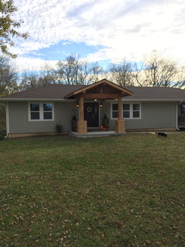

Your house looks awesome. Keep up the good work.

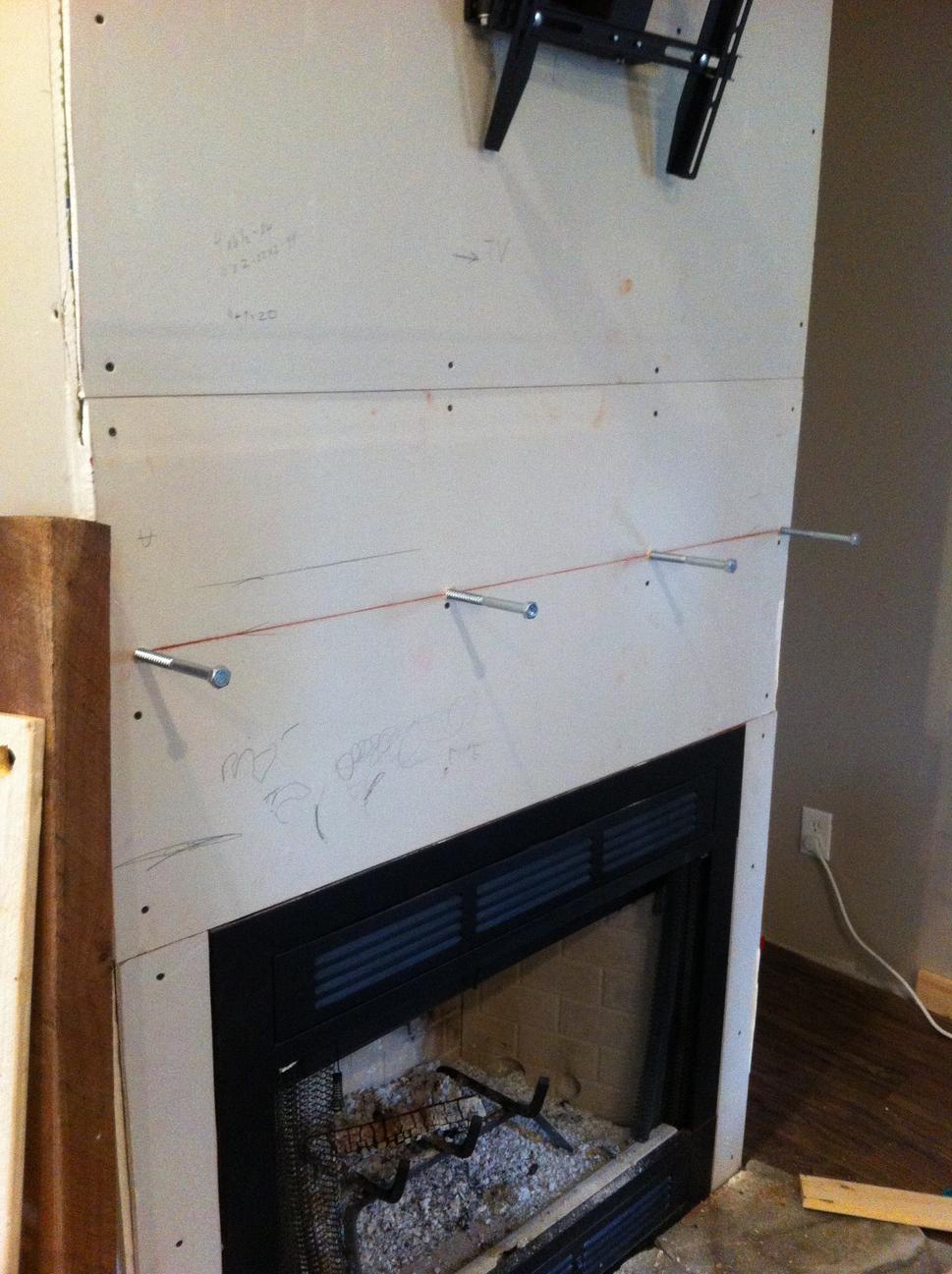

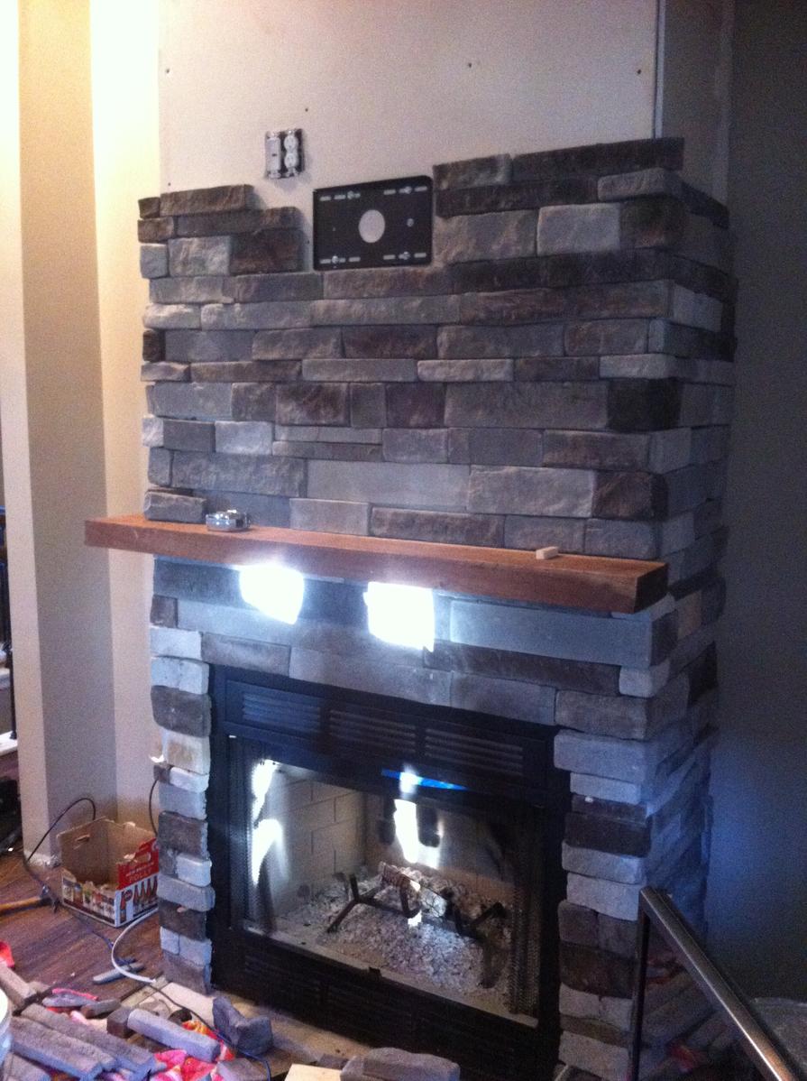

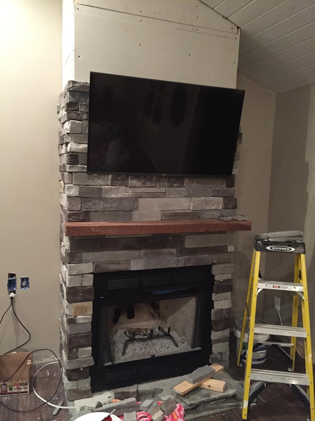

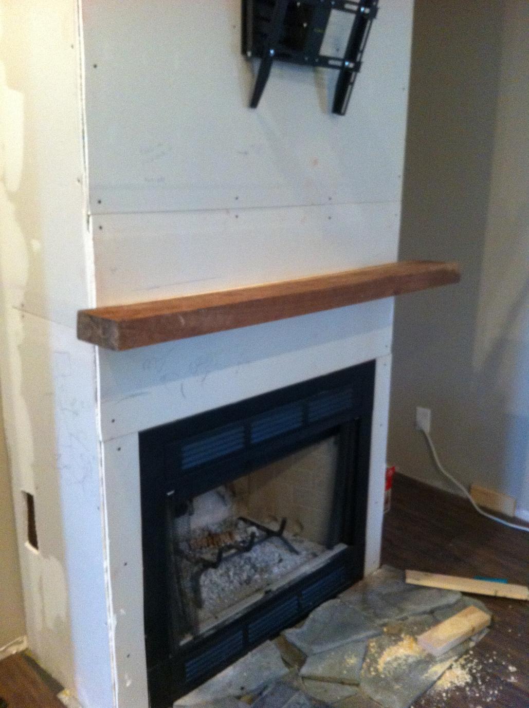

Started on the fireplace this week. It takes a while to put up, but we are happy with the results. We wanted the mantel to just "float" there so I had to come up with a way to mount it. I decided on using lag bolts and to drill 6 inch deep holes for the mantel to slide on. Filled the holes with liquid nail and toenail the bottom with a few deck screws, that thing is not going anywhere.

For a "brewery," there aren't many posts about beer . . . . :pout:
Just kidding. It depends on your distance and viewing angle, but you may start to get neck strain with your TV that high. It looks great otherwise. I'm looking for ways to bring faux stone into my house as well.

The bottom of the tv is just under 6 foot off the ground and our couches are 9 or 10 feet back. It doesn't feel like you are looking up while you watch.
My neck feels fine after watching the Chiefs game yesterday. How does your ass feel? :wacko:
Well if you do tire of the viewing angle there are companies out there that make "pull down" mounts that are really nice.
I installed one of these at my buddies place, he loves it.
TV Mount for Flat Screens Over-The-Fireplace | MantelMount
ETA: Also, did you cut the bolt heads of those lags? We've done a ton of floating reclaimed barn beam mantels at work lately using this very method. Construction adhesive and voila, we cut the bolt heads though with an angle grinder.
That mount looks pretty cool, I still have 6 inches or so that I can lower mine with the mount I have if needed. No, I did not cut the heads off. With the mantel pushed all the way up against the wall it seemed really sturdy, looking back I see why you would cut them off for more support. I filled the holes with liquid nail, and liquid nailed the mantel to the wall. Also I used a couple deck screws to toenail the bottom of the mantle to the studs. That made it level, but again cutting the heads off is what I would do if I would do it again.

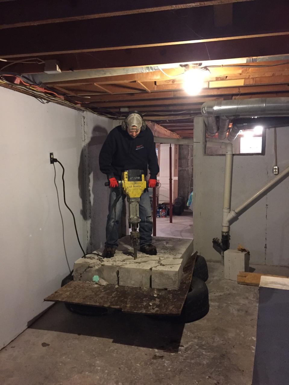

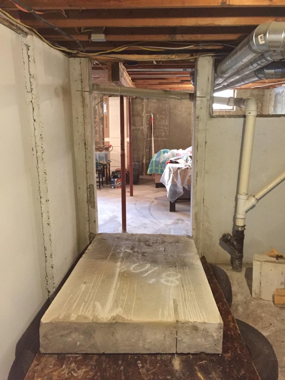

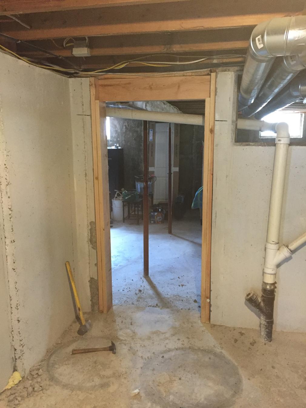

Finally, the work is done upstairs...the wife is happy...back on track to actually build my brewery. So the brewery is going in an addition that was added on the house but the basements were never connected. I was very close to buying a "rock boss" from stihl to cut the doorway myself but decided to get a few bids from local guys to come and do it for me. The rock boss looks really cool, but super expensive compared to the cost for the professionals to do. I made the right decision, that would have been a ton of work to do it myself. It took them about 2 hours to cut it with hydraulic powered saws so my house doesn't smell like a two stroke motor.

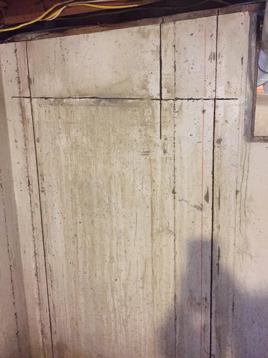

Here are the cuts in the 8 inch thick wall.
They had the idea for me to have the wall fall on tires so the floor doesnt get messed up. Worked really well. The beam you see now was not attached to the concrete wall... it is now attached to that new header.
This thing is fun to do for a while, but not for a living. Estimated weight of that slab is around 2k lbs. It now lives in the creek that runs through my backyard.
Finish door with header, this will be the "secret passageway".

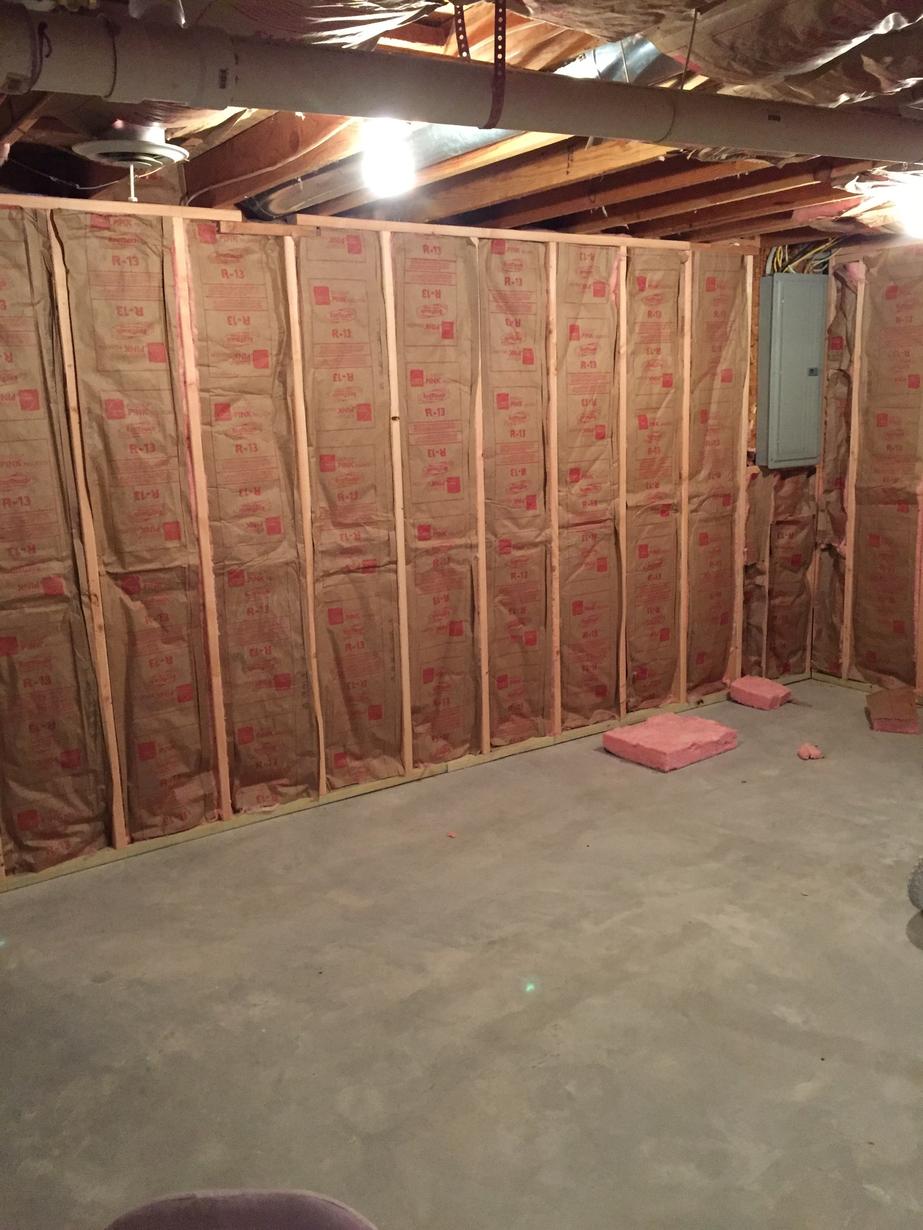

Got the brewery framed in and insulated.

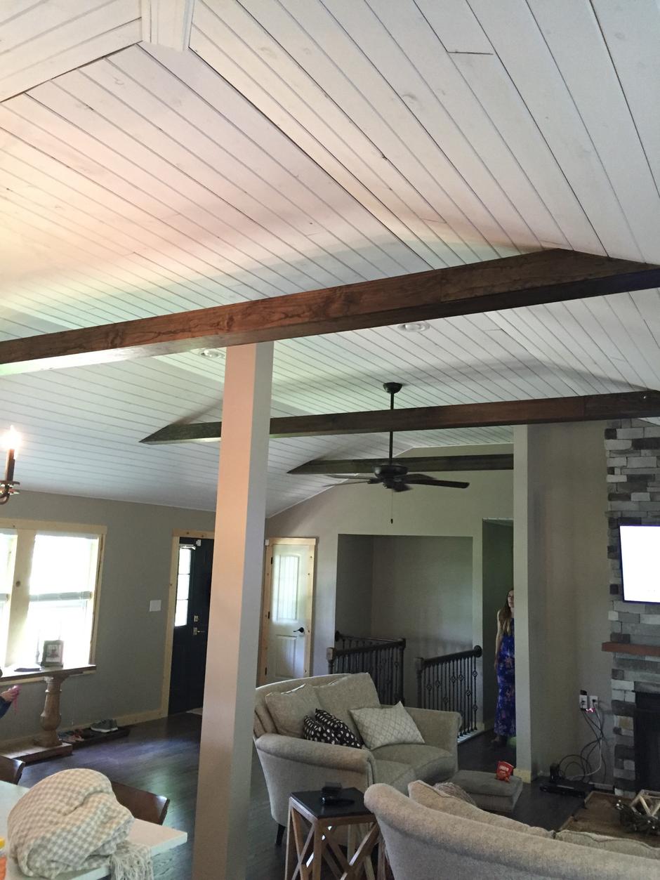

Added faux beams in the living room

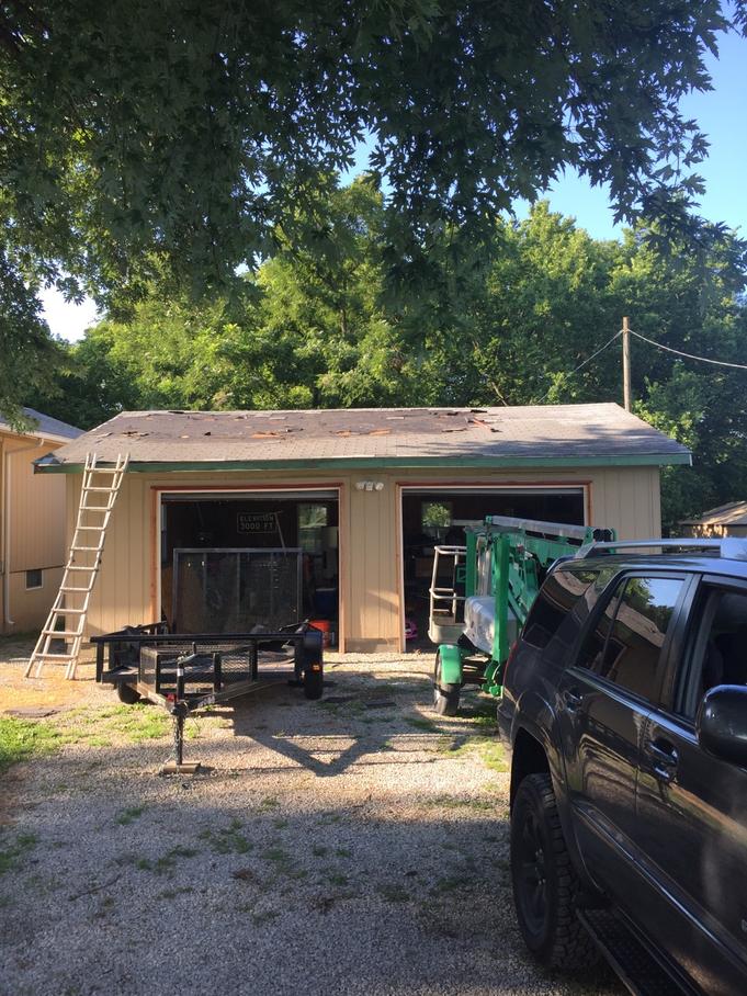

Put a new roof on the garage.

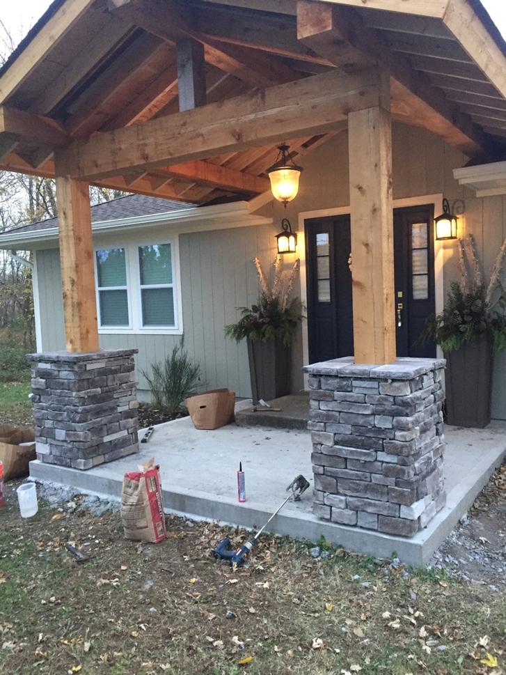

Finally, the wife signed off on me starting to work on the brewery!!! :whipping2 Last update on what I have done to the house that doesn't involve my brewery..I promise

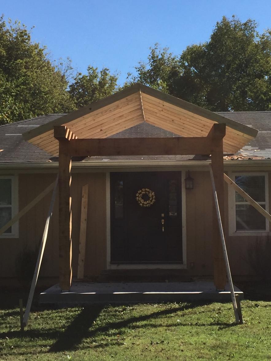

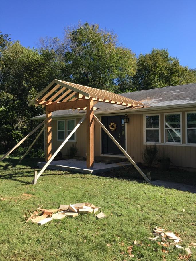

Almost done with the new entry

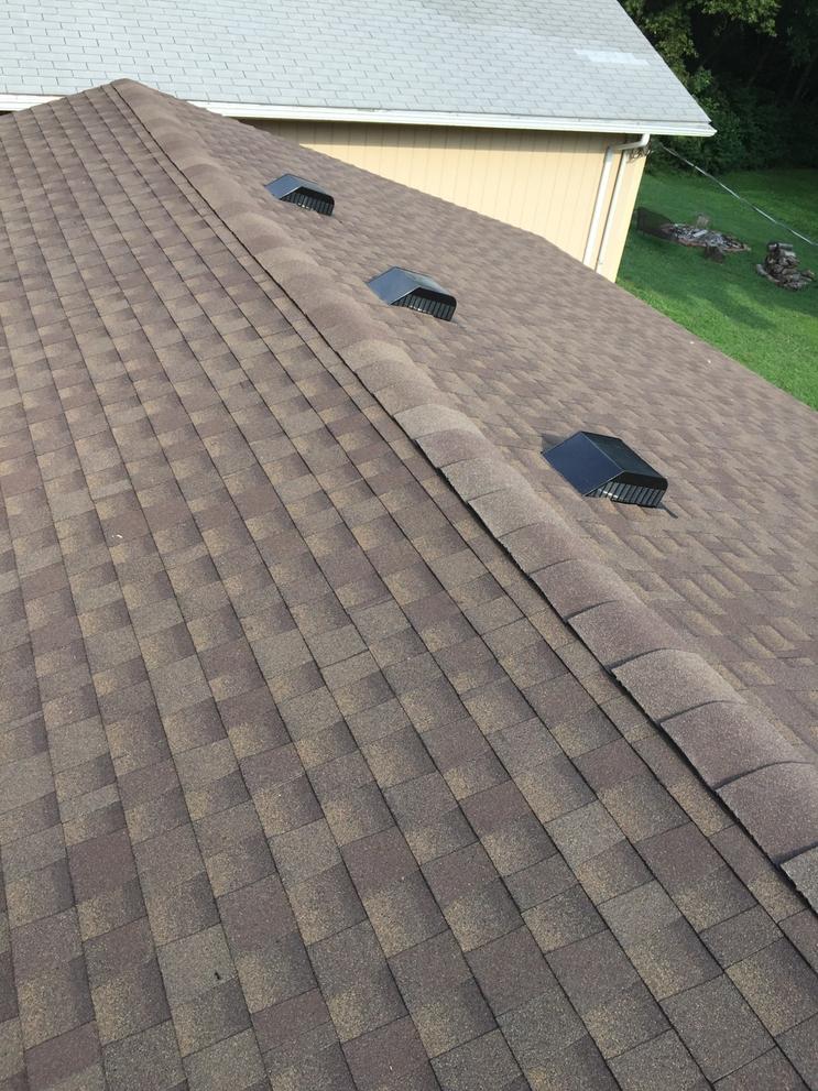

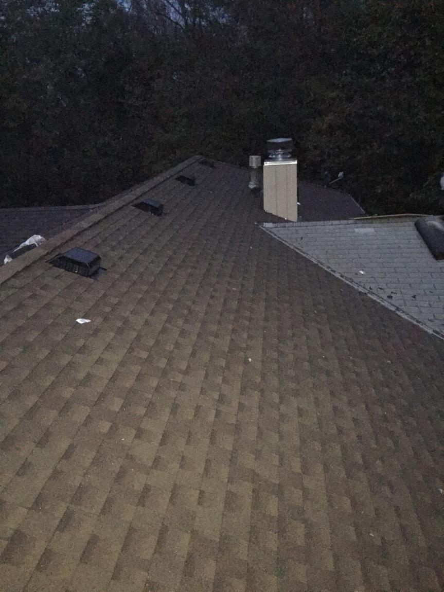

Finished re-sheeting and roofed the whole house. Photo is of in progress of course
Painted the whole house...
All that's left before I start on the brewery again is the floor for the entry. I have the material ready to roll for this weekend. :girl:
