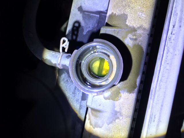

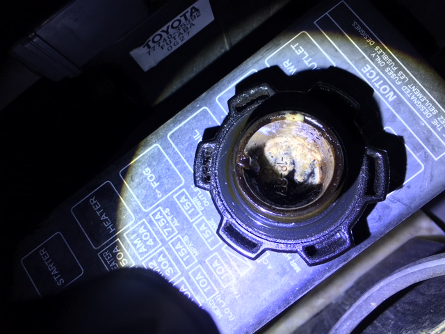

Here are some pictures of what I'ms eeing under the radiator cap and oil cap.

When you drive is it only for short trips? I only ask because if you take short frequent trips the engine doesn't/isn't at normal operating temperatures long enough to get all condensation out of the motor. It will collect under the oil filer cap like what is in your picture. I would suspect another culprit for your rough idle/shaking.
For the last two months I've driven the car about 2 miles round trip for work each day. The temperature outside has been about 10-20F as well so I've definitely not been getting it to operating temp.
Well that will explain the white oily residue under your oil cap. I'd say the burnt oil smell is coming from your leaky valve cover gaskets. Is it throwing any CEL/codes?

Oil fill cap extremely possible from short runs....especially in cold temps. Have to heat it up enough to burn the moisture out.
Radiator fluid looks fine to me based on picture.

With the condensation information provided by MOYotas and reelamin, I fired up the 4runner today and drove it around the block until I got to operating temp. I drove around a little longer and temp was holding steady.
After the drive, no more tanish substance under the oil cap and still nothing on the dip stick.
