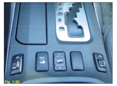

I'm planning on getting a T1808 and adding Blu Logic to my yet-to-be-delivered '05. This image is from a Sequoia and I think it might be the large knockout and the one we need. Post up if you find more info.
So I just ordered the scion T1809. I've read on a tacoma forum, where a dude installed blu logic in his taco and said that if you install the call/answer button on the dash (left of the steering wheel) then you will need the large button. But if you wanted to install the call/answer button in the center console then you will need the small button. Well, on my 4runner the knockout plates look like the same size. The (sequoia) button on the picture above looks more "square" than my knockout buttons. So if that is the large button, would I need the small?

They make a kit for the current 4R. Perhaps those buttons are the same size as in the 4G.
Thanks for the replies ABQ.
I believe you are correct about having the large button.

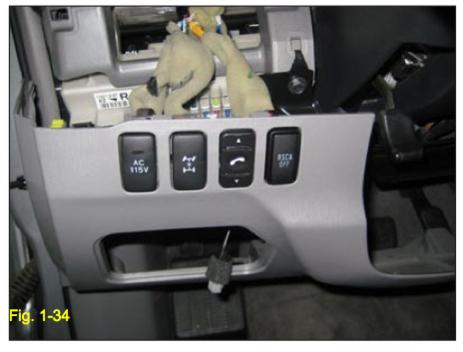

So I found a post that lists the small knockout button dimensions at approx
1 3/8" X 15/16"
Part PT923-00090
I can't find the large knockout dimensions, but the part # is PT923-00098.
Here are instructions for a Tacoma installation with the large button: http://www.toyotapart.com/2008-2010...23-00098_REV._B_T-AI-0475-D_--PT923-00098.pdf hid kits
I don't have my 4R yet, so I can't measure, but if you scroll down to page 8, it looks like the size we need.
