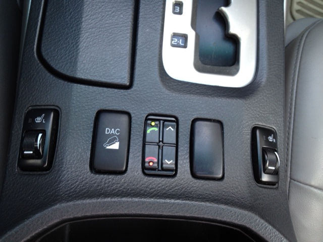

I will post a picture of my mic installed and the control button on my center console. Hope this helps.

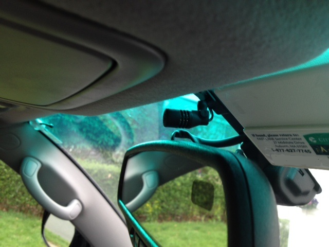

Here is a photo of the microphone. I mounted it to the base of the rear view mirror and ran the wire along the edge of the head liner, down the front left pillar and under the dash to the control box.
