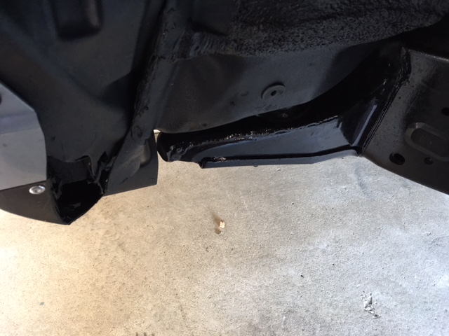

This is the passenger side on my 2017 SR5 P, i think the bmc came out great.
