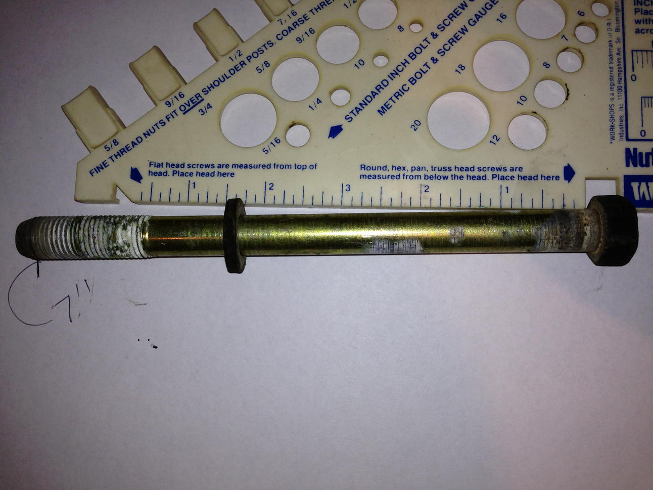

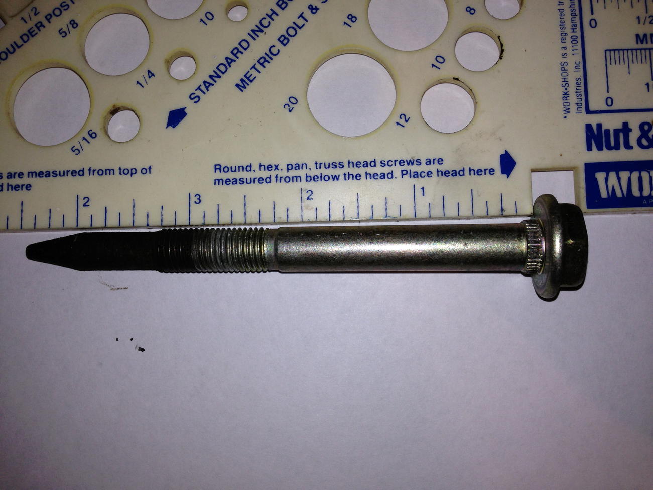

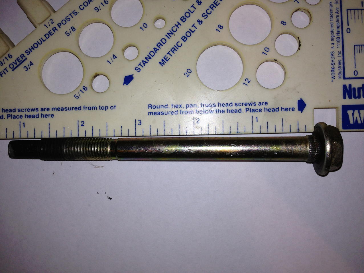

Today is your lucky day. Just ran out to the garage and found my old body bolts, just for you.
6 of M10 x 132mm (or 5 1/4")
2 of M10 x 114mm (or 4 1/2") *Check the pic as threads are not at the bottom
2 of M14 x 180mm (or 7")
Yes you will need a steering shaft extension for a 1.5"BL.

Thank Baby Jesus. Would you happen to have a a pair of calipers to measure the diamater of these bolts (as well as the washers outer diameter please.)
Thank you very much Socco. I really appreciate it. I actually jumped out of my seat when I saw these pics. lol Again Thank you sir!
