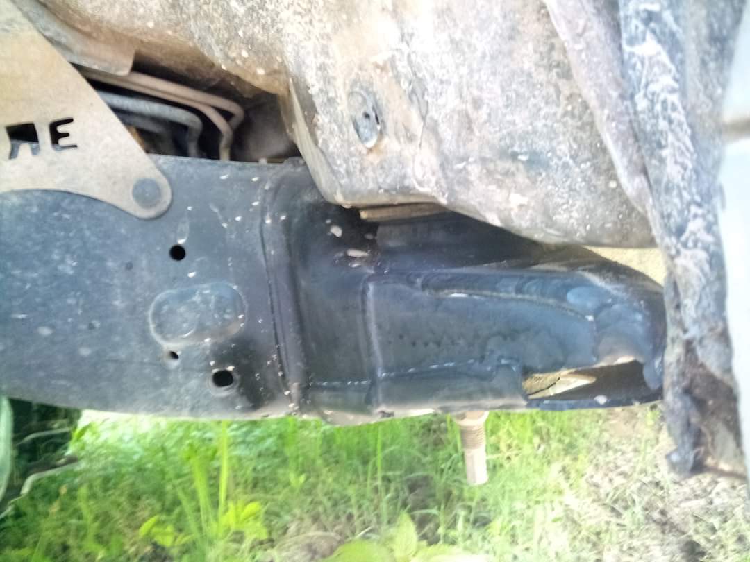

I welded nuke plant pipe for several years. This took me about 15 minutes per side. No new plates needed and maintain the factory look. Free. I made this video to show how to do it. If you have the skill it's no problem! Check this vid out. I attached a picture of the finished result.
登录 Facebook | Facebook
